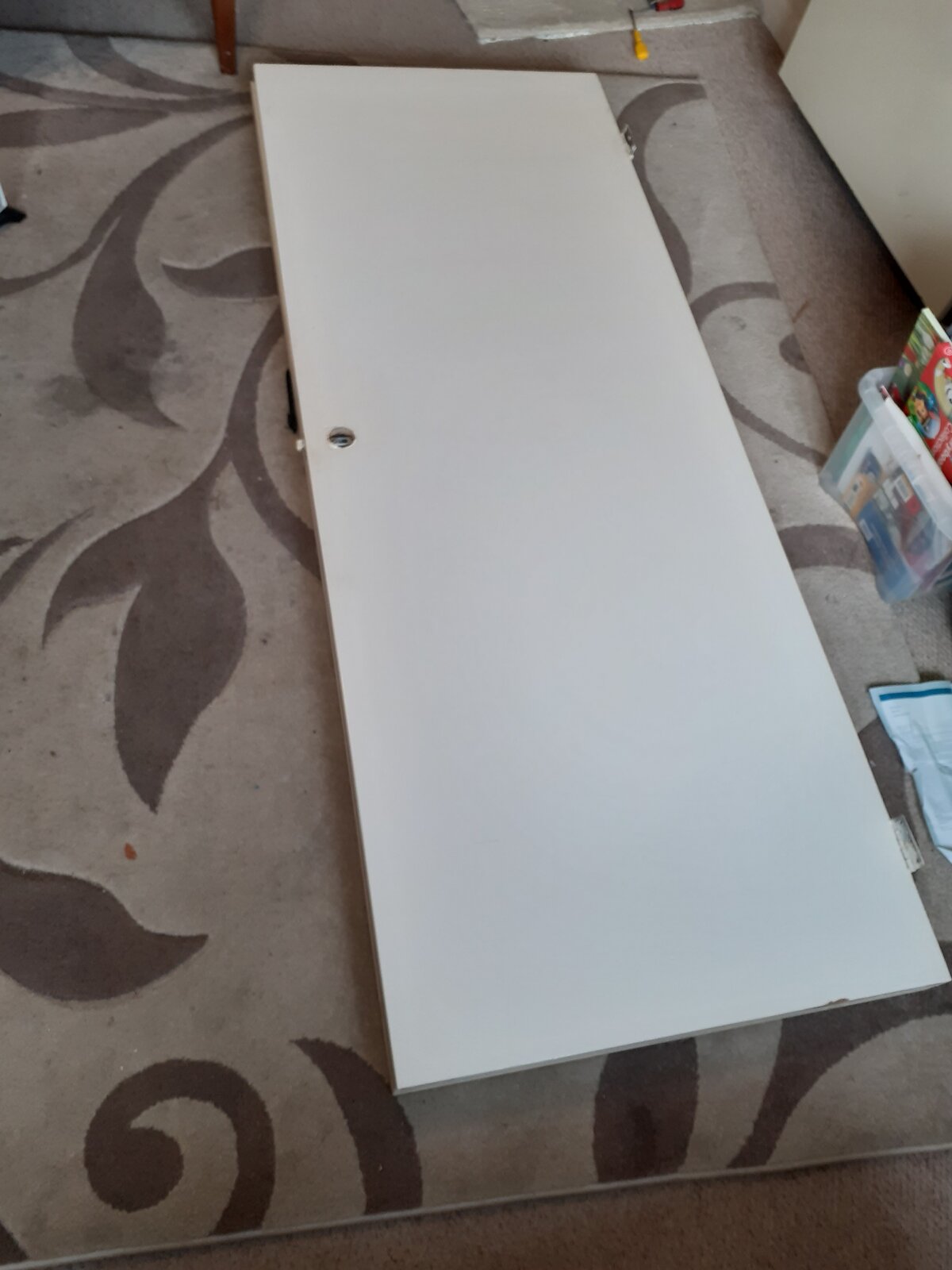

To cut door after tracing old doors size on it. I guess line it up at the top then place central, not lined up to the left or right side of the door mark with a pencil then should I cut with circular saw ?

By the way, ignore photo in first post. It's wrong door. Too wide for that lining I'll use it in another lining

Yeah door is wrong size on photo it's 670 space and 766 door. In the right sized lining surely I can cut the small amount off with a circular saw. I'll edit first post

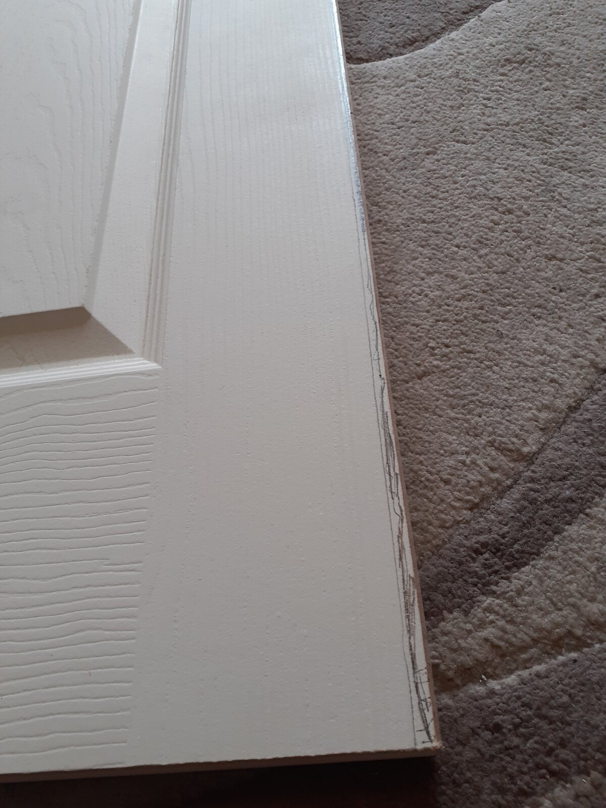

I lined up top and hinge side. Tricky as it moves about. Anyway I marked what needs planing- 8mm off bottom of lock side tapering off into nothing in the middle. The top seemed same width so nothing to plane. I'll give it a go
