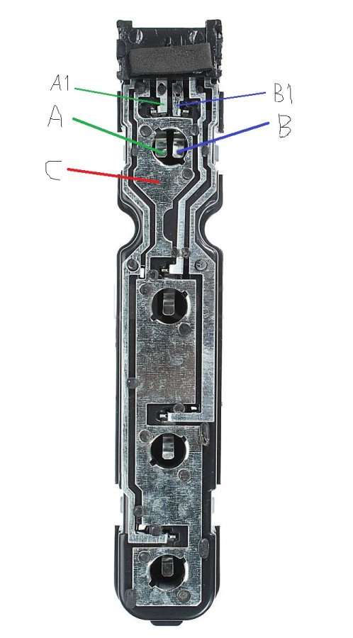

hi,
I have a ford transit connect 04. Today realised that all three brake lights werent working. When I checked I found that the upper light bulb had blown. Changed it and tested and found that the lower two brake lights were still not working. All other lights work, indicators, hazard, main lights etc.
Checked the fuse diagram and looks like there is one fuse for brake lights, changed that and still no luck. Is there a separate fuse for the lower brake lights or is it something else??
many thanks,

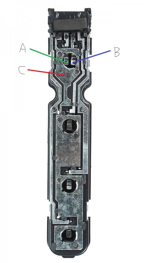

Set it to measure DC volts (20v range if it's that type) and put the black probe on C in the pic and the red probe on A or B while an assistant presses the brake down, one is sidelights, the other is brake. Not sure which way round they are TBH. Do you get any readings?
WARNING:- Don't let either probe make a short circuit from C to A or B! A and B are down a recess and it's very easy to accidentally touch C with the same multimeter probe. Put some electrical tape roung that probe so it's only bare at the very tip to be sure.
Gaz
Yeah, that's the bulb holder. Note, you can just use A1 or B1 that I've added to this pic BTW.

Thanks Gaz, Ill try that in the morning. So i guess if I have power the problem is with the bulb (although it looks ok) and if there is no power then its either the wiring or further back.
