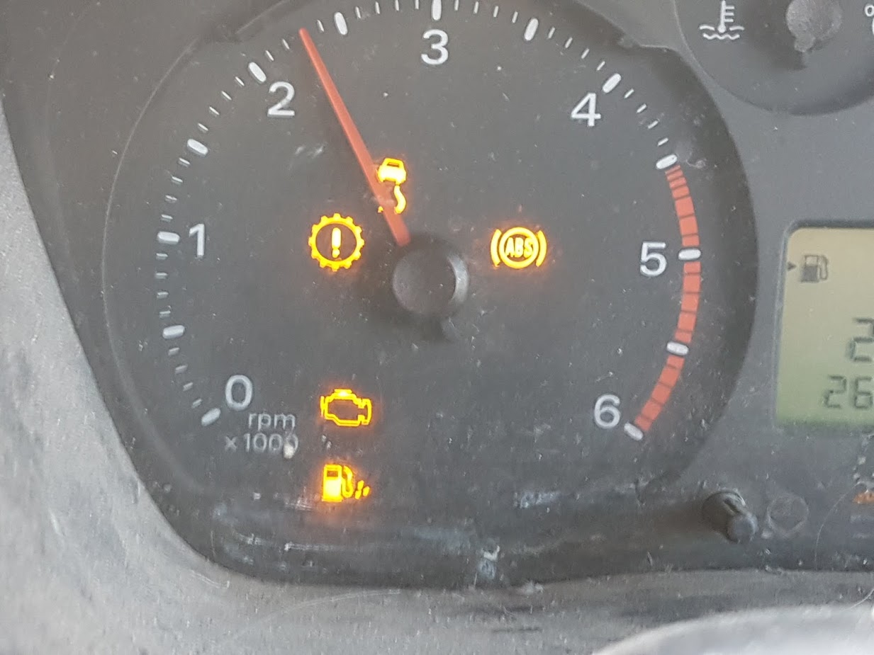

S seasickstevie Joined 14 Sep 2006 Messages 1,612 Reaction score 92 Location Liverpool Country 10 Feb 2018 #1 Wondering what I need to do about all this that's suddenly come on. Also my stop lights are no longer working! Should I take it to the auto spark? Attachments 20180131_110419.jpg 122.1 KB · Views: 223
K Keithmac Joined 10 Oct 2017 Messages 2,392 Reaction score 406 Country 10 Feb 2018 #2 Could all be down to faulty stop light switch (abs fault etc ln dash).
Mottie Joined 27 Feb 2017 Messages 50,393 Reaction score 10,484 Location Essexshire Country 11 Feb 2018 #3 Have checked the obvious - blown fuse?
S seasickstevie Joined 14 Sep 2006 Messages 1,612 Reaction score 92 Location Liverpool Country 14 Feb 2018 #4 Yes (sorry for slow reply). Checked all the fuses: they're fine.
B Burnerman Joined 7 Feb 2008 Messages 26,382 Reaction score 5,876 Location Northumberland Country 14 Feb 2018 #5 Is the rev counter indicating with the engine switched off? John
S seasickstevie Joined 14 Sep 2006 Messages 1,612 Reaction score 92 Location Liverpool Country 19 Feb 2018 #6 Burnerman said: Is the rev counter indicating with the engine switched off? Click to expand... No, as it should be, perfectly normal.
