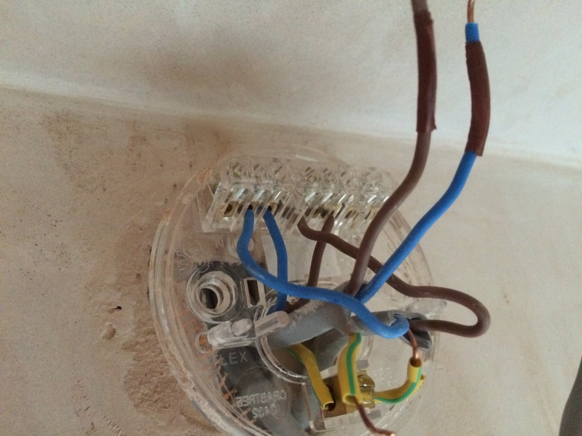

I've had a new shed/garage built. New electrics were installed by an electrician, and were we all working ok. Perhaps now a mistake, i did not get the electrician do a first and second fix, I got them to do the job in one go, knowing that I would then install plasterboarded out one of the rooms. When plasterboarding out I detached from the wall the supply fuse box and slid plasterboard behind, but no wires were disconnected in doing this. However L1 & L2 as per the diagram weren't quite in the right place so I moved them. There was enough slack in L1 to move it, however I used a junction box and extra piece of wire to move the position of L2.

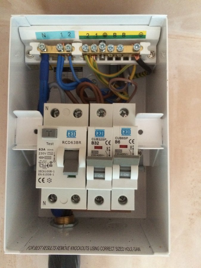

However now when I turn on the light circuit the RCD trips in both garage and main unit in the house. (after reading one other posts it mentioned that having RCD in series might not be normal???)
First of all I removed L2 from the circuit, then I removed S1 and L1 from the circuit, so that L1 is just acting as a junction box towards S2, and the circuit is still tripping. Luckily I can still access the wires by removing some of the exterior boarding, and have checked for damage to cables by screws, but can't find any. (can only visually see 80%) but all moving about ok.
Therefore i think I have removed as much as I can from the circuit in terms of changes made, but its still tripping. Have called electrician who installed it, but he's not available for 3 weeks. So posing here to see if there are any suggestions.
A few searches suggest a 'leak to earth' might be an issue, but I don't have any equipment that can test, unless any suggestions?
The picture of the light box is L1, and shows switched live cable disconnected, but L2 disconnected cable is out of shot.
Any suggestions of help greatly appreciated.

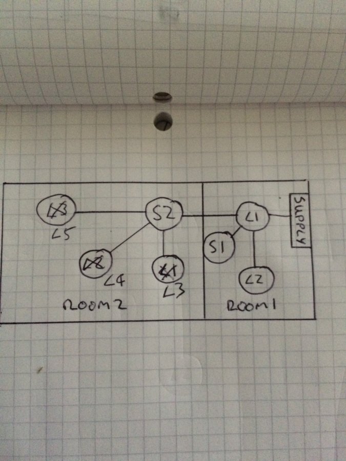

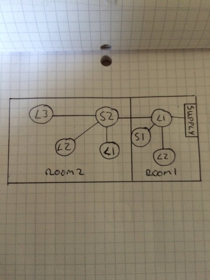

sorry yeah just noticed diagram is a bit confusing. See update to original post.

Have checked all the bulbs (L3,4,5, as per the updated diagram) but non are blown. When the switch is turned on for the circuit I see a flash of light in the bulbs before the rcd trips, but the bulbs arn;t blowing.
Therefore, as i have removed S1, L2 and L1 from the circuit, the extent of the changes I have now made in terms of wiring is the picture of the light fitting L1 (12.jpg) which I was trying to show is now simply a connection box between the supply and S2. I'm pretty sure its right.
I've triple checked the wire and can't see any damage.
I would first check the wiring in your new junction box. After all that is all that's been touched.

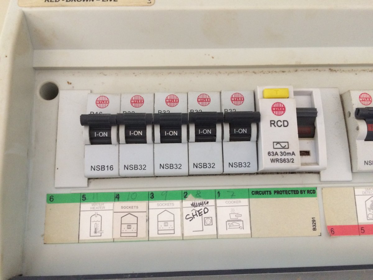

But to be honest the electrician has done it all wrong. An RCD and 32 amp MCB in the house feeding another RCD and 32amp MCB feeding sockets in the shed! So a socket overload in the shed will trip both 32 amp MCBs or an earth leak in the shed will trip both RCDs (as you have found out).
If you retain the shed RCD the house MCB should be moved to the non RCD side of the board.
For proper discrimination the house MCB should be higher than the shed one, maybe 40 amp if the cable is suitable, or the shed one reduced to20 amp.
All the advantages of a separate light circuit in the shed are lost if the house MCB trips.
I guess you didn't need the shed CU at all, the sockets could have been run direct and the lights through switched FCUs.

If you have disconnected all the lights in the room with the supply and it is OK, ie not tripping and all the lights in the adjacent room are working, then there must be an issue with the wiring to L1, L2 & S1.
Use a multimeter on the ends of the wires feeding these fittings (with lamps out and power off) to see if there is a short.
I can't see any damage the cable, I'm actually able to get see and see into void to see the wires.
I have disconnected everything in the room with the supply (except the 'pass through' to the other room), however despite not making any changes in the other room the rcd still trips.

In the picture of the ceiling rose, there is a blue wire with a brown sleeve. What is that?
The blue wire with the brown sleeve is the switched live from S1. Therefore at present the S1 is not connected.
Wrong. For full discrimination two circuit breakers to BS EN 60898 in series will never be suitable.
Does that not depend on fault levels?
Not really. If we are talking about fault protection as opposed to overload protection then there is liable to be sufficient current to operate any and all devices in most cases.
Fuses or MCCBs are far better for achieving selectivity (discrimination).
