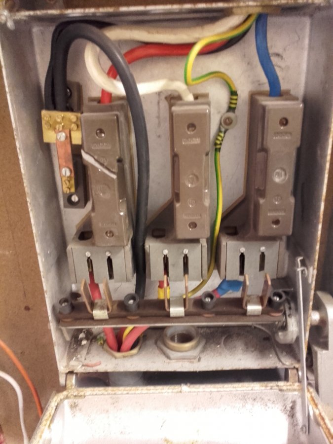

Well just for you here is a recent photo of some 3036 fuses feeding a submain. They should be 100A wires but there was a random assortment of doubled up fuse wires, each fuse different! This switch fuse is in poor condition in more ways than is shown in the photo. The conductors are 70mm.
They don't look like 70mm conductors at all! Looks no bigger than 10mm². Bad photo skills!
Nice carrier on L1, and was L2 ever yellow or did it start out life as white?
It really is bigger than it looks! The conduit entries are 2". The L2 insulation is white as it is rather old.

Asbestos seal and probably flash pads?
Probably, though the flash pads were missing. The seal looked to be painted over with something clear (PVA?) so perhaps h+s have had a go at making it safer. It would have been better to replace the unit to remove the hazard though. All the other switchgear of this age has been replaced, except this one.
