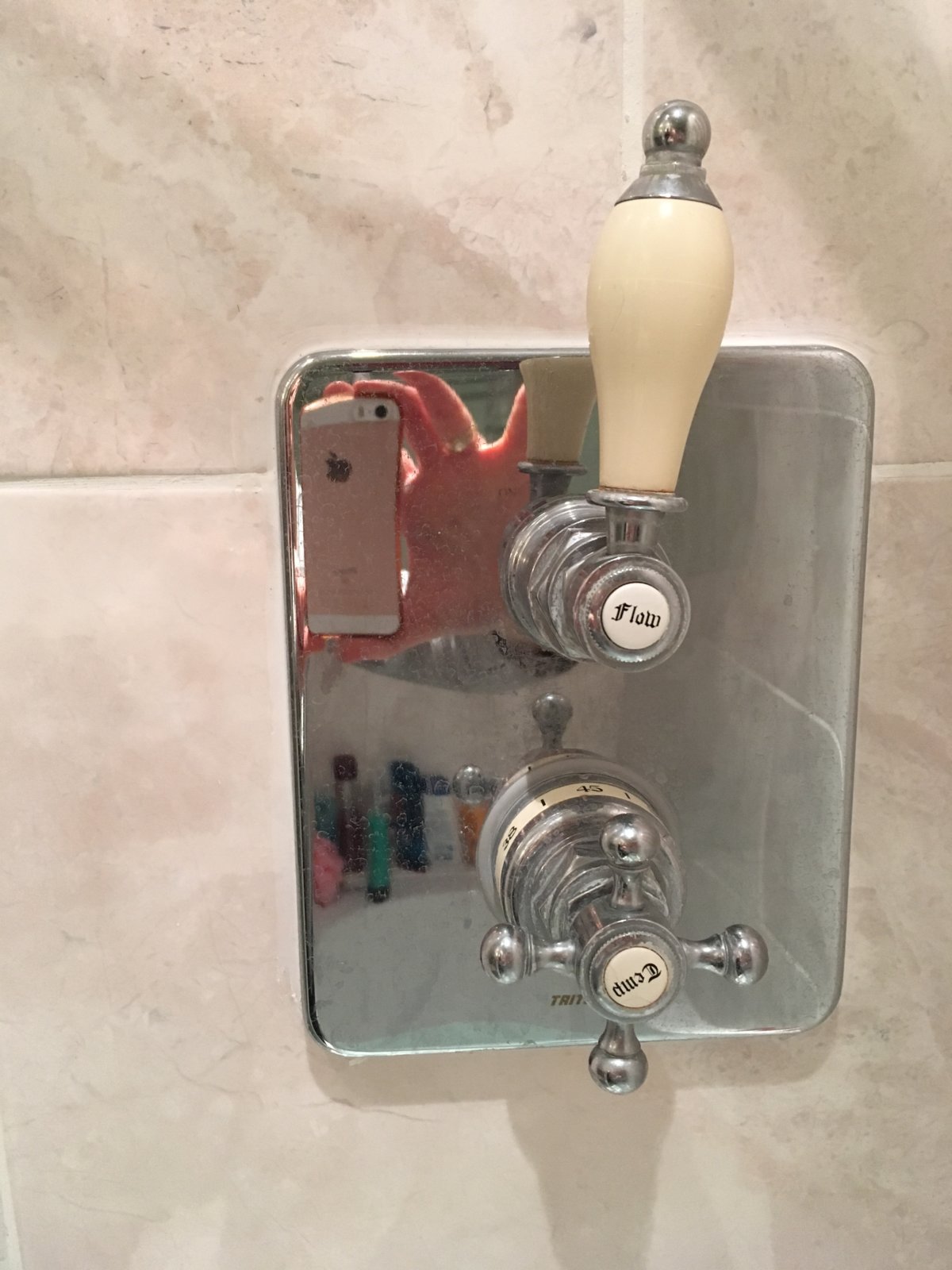

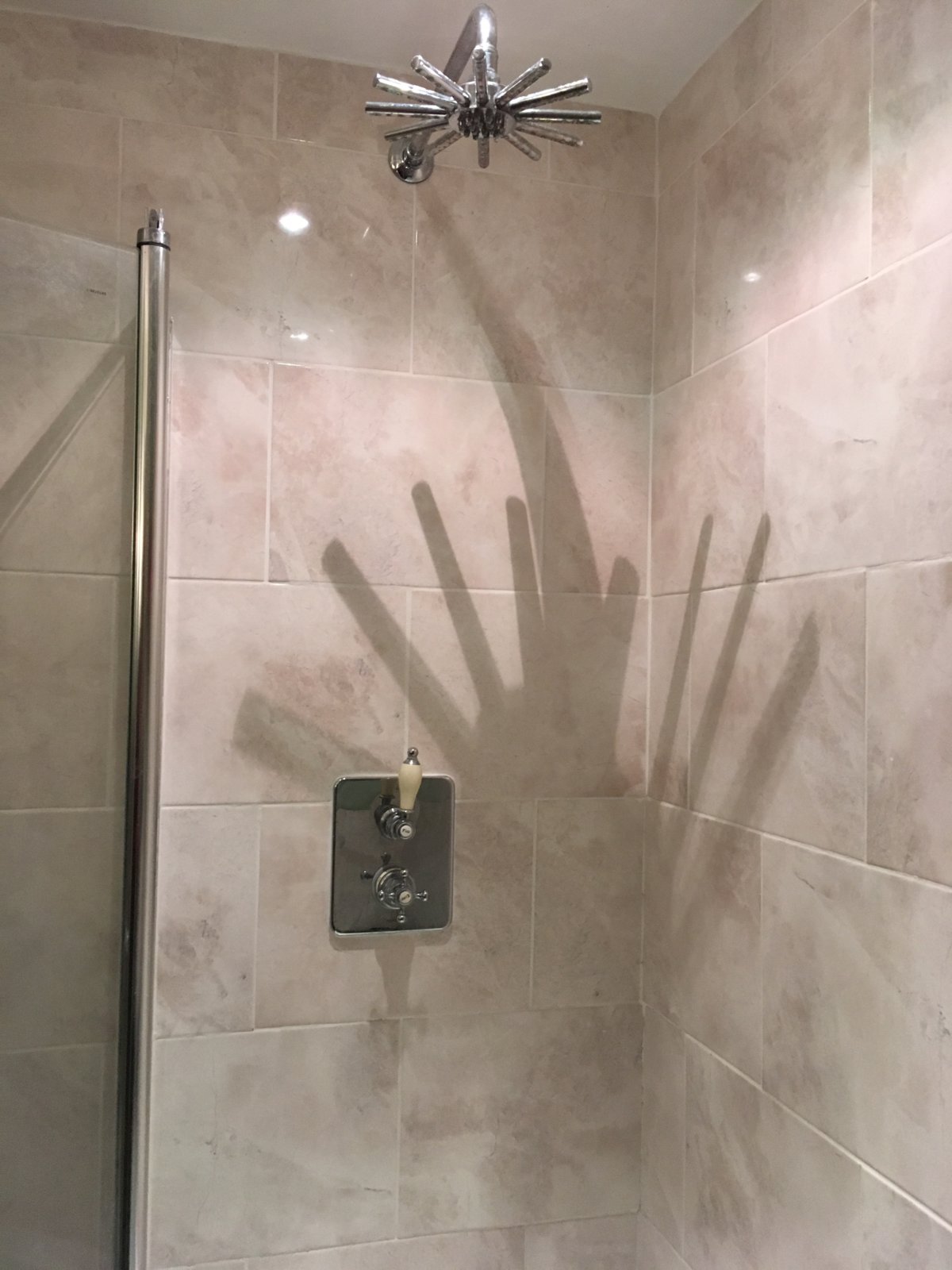

we have recently bought a house and it has a Triton shower fitted behind a tile wall. All we have access to is 1 tap that control the temp and a lever that turns it on. The pressure suddenly went a few nights ago and we have no idea how to go about fixing it or getting an electrician in without taking the tiles off. Can anybody advise ?

What sort of shower is it to be "behind a tile wall"? How, and why, would anybody tile over an instant-heat electric shower?

No idea I assume an electrician as the water and temp is fine , but the water pressure has dropped and no motor noise from shower area which we have heard previously.

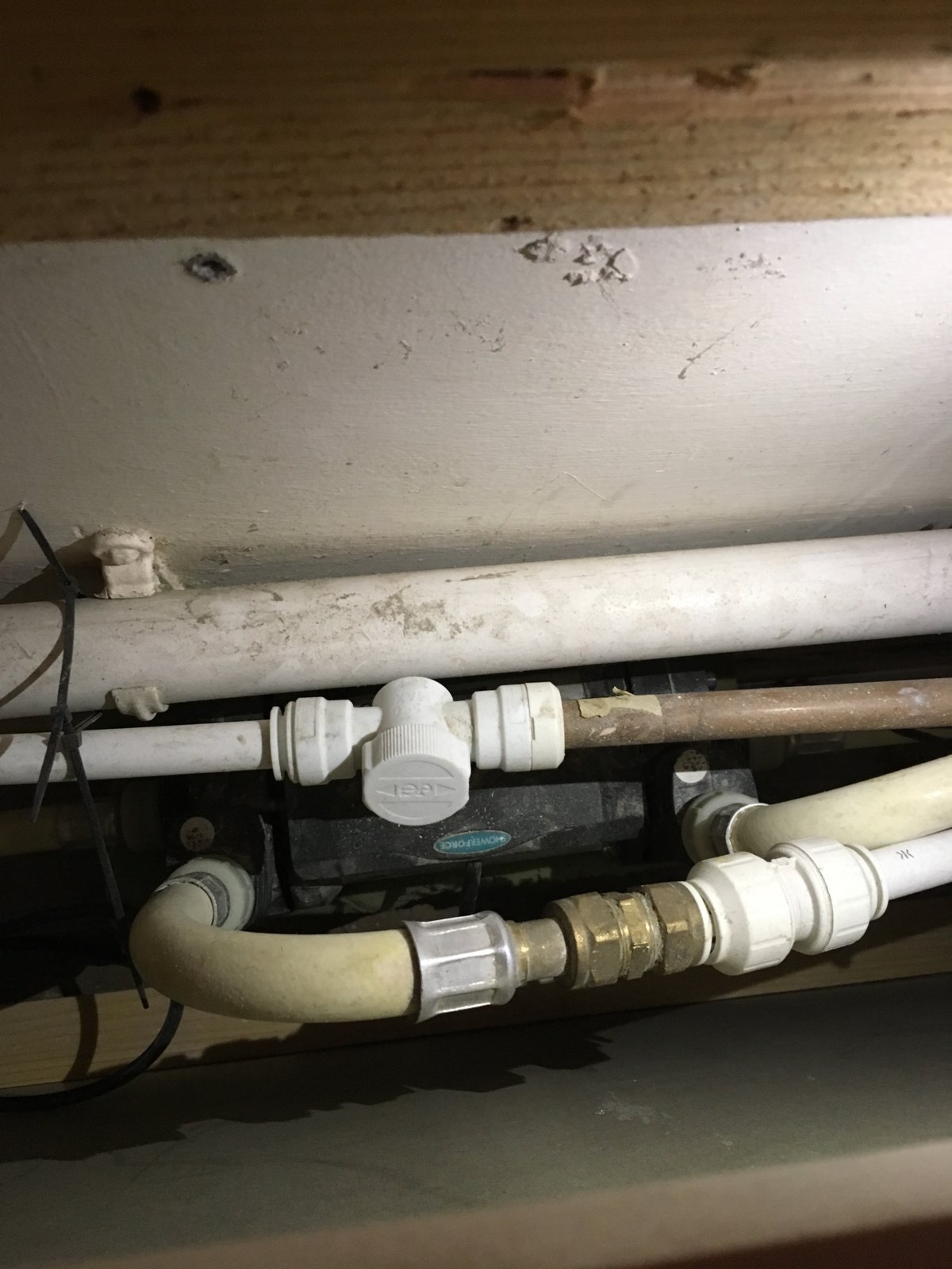

We’ve just found this behind a panel near the sink - if you zoom in it says shower force, and the pipes seem to head towards the shower. Is this where the pump will be?
Yep, that black thing would be the shower pump.
It will presumably have some sort of 'flow switch' (internally or externally), which switches it on when water starts flowing. That may be what has gone wrong, in which case it might be possible to replace just that - but it's probably more likely that you're going to need a new pump. Either way, as I said, I think you need a plumber - there's an outside chance that something has gone wrong with the pump's electrical supply, but I think that's far less likely.
