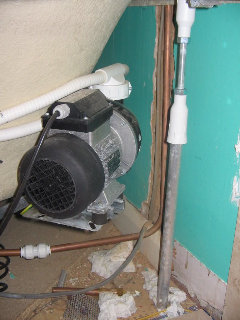

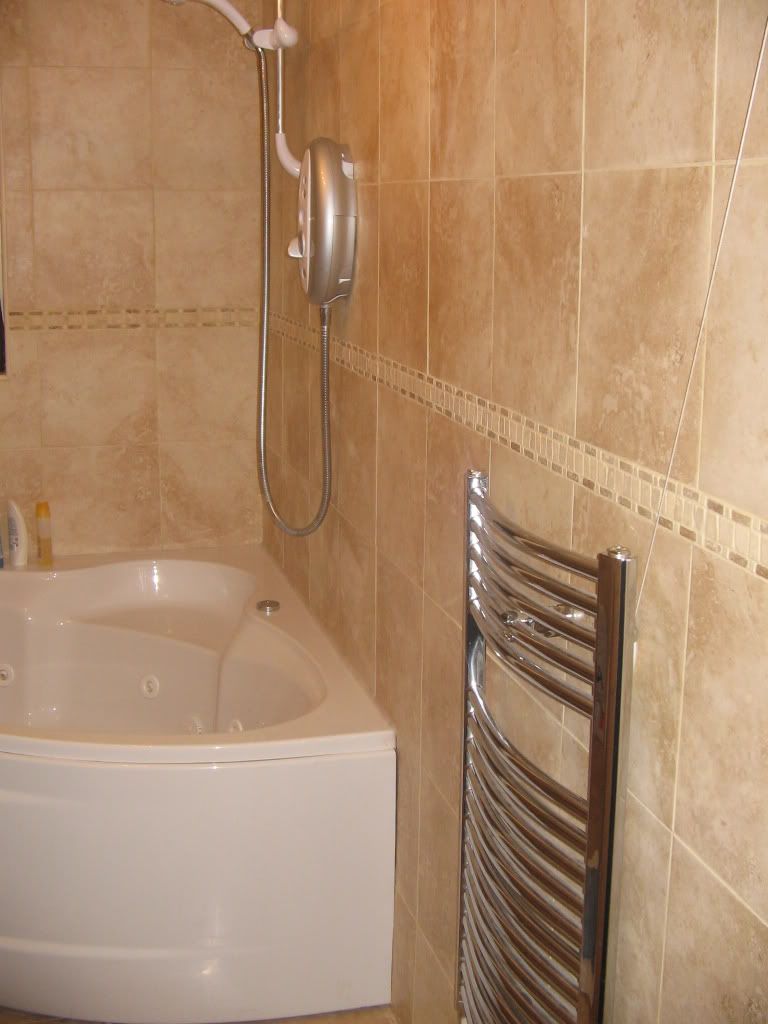

So the shower is actually over a bath, rather than in a shower enclosure? This means you have space under the bath hidden by a panel?
Check what kind of wall is behind the shower - it might, with luck, be a stud partition that you could literally drop a new 10mm cable down. Worse case would be if the existing cable is plastered in.. :(
Can you remove the skirting board to take a look without damaging the heated floor? You might get lucky and find some trunking that conceals the cable..
Yip, take a look...
general setup
under bath
That'll be a plastered brick wall.

Did the same guy also install the jacuzzi pump and leave all his mess behind? :LOL:
