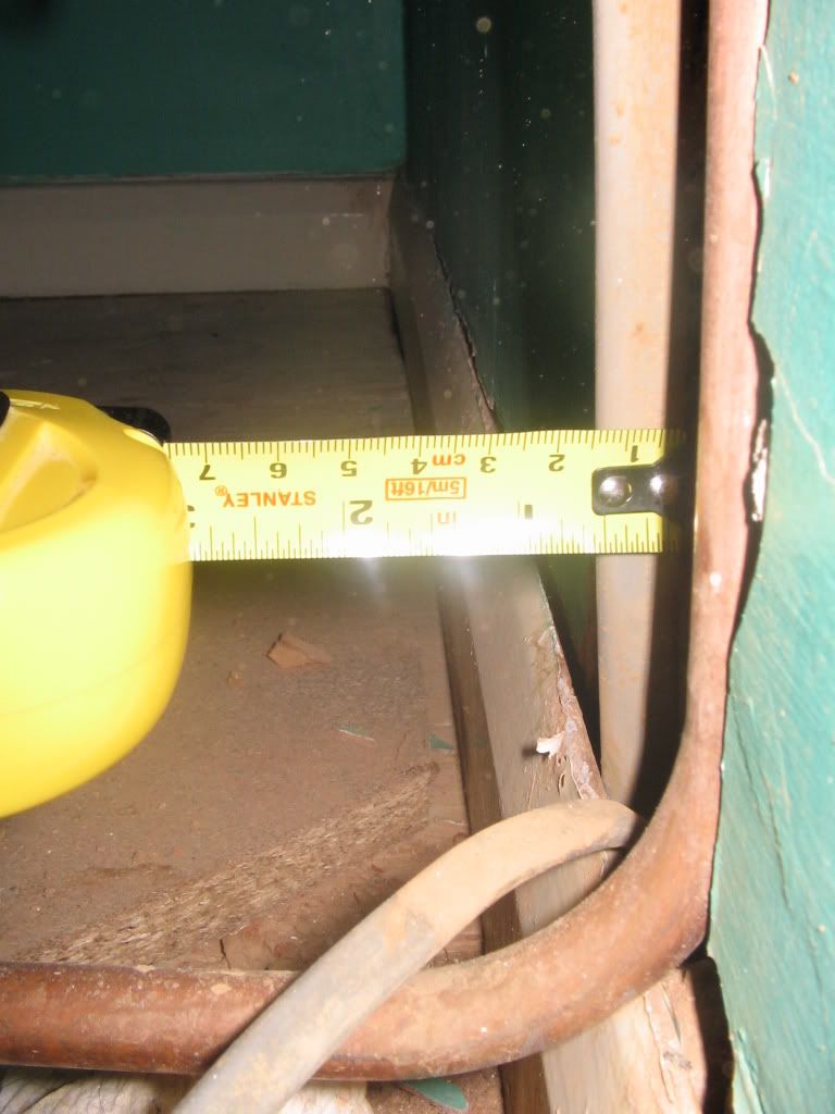

Well the OP did post a subsequent pic of 6mm going from under the bath to that shower - you are assuming the join is after this?

Up until the recent pic of the switch and under bath, the cable change may have been in the switch , rather than a join.
So, you seem to be agreeing that the gauge reduction isn't in the switch. I'd love to know where you think it could possibly be.
Possibly the same as your thinking , behind the tiles,
Although you possibly thought it no one had mentioned ,to the op a possibility of a cable join failing, in the tiled wall, exposed to water, causing the original rcd tripping problem.
