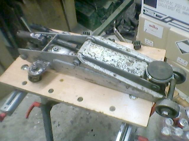

Quite an old one but has served me well.
Have had to bleed it quite a lot of the past year and today I got a bottle of jack oil to top it up although could only pour small amount in before it was full. Still not lifting to full height with a bit of weight on it.
Do I presume the seals are too fatigued and need look for a new one?

As you'll appreciate, the valves on these (not seals) are simply spring loaded ball bearings which locate in a tapered housing.
If there is any dirt holding the ball open, or indeed it is pitted then you could probably do something about it - it depends on how much time you want to spend on it!

As it still lifts 2/3 of the way, may just need a complete oil change as a fella on YT did to bring his trolley jack back to life.

I'm going to try an oil change on the old one first. £4.99 for a Carlube 0.5L bottle at one factor and £4.21 for a MPM Oil 1.0L bottle at a factor 5 miles away.
