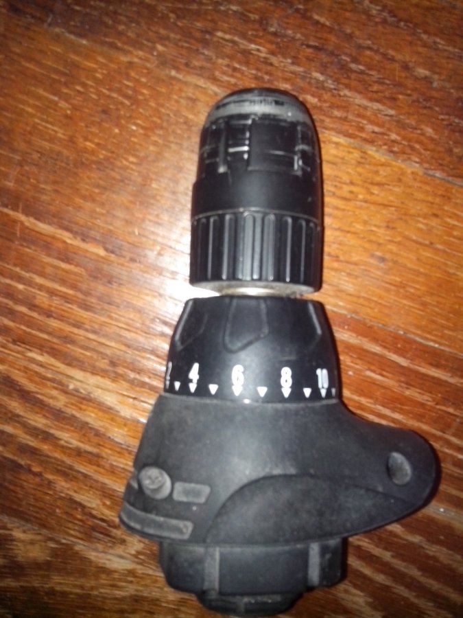

Trouble releasing the chuck
18 Aug 2008
3,904
329
Devon
The drill is a black and decker quatro.
Yonks ago the chuck got replaced with another one capable of accepting wider bits.

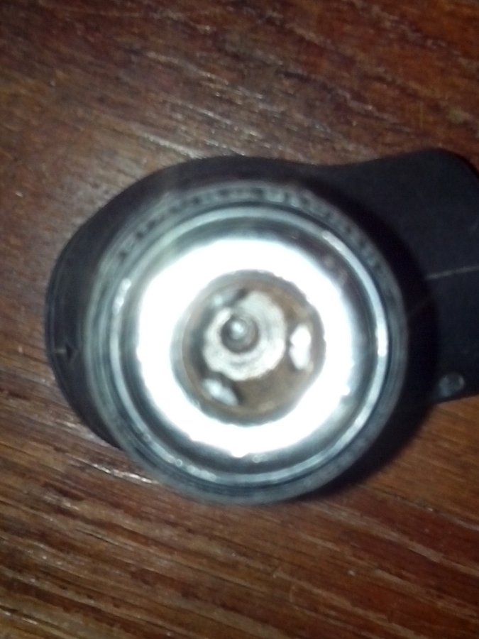

I can't see what I need to stick in there to release it.
I've bought a better drill since and was planning on selling this one on.
Any ideas ?
Love the way I can drag and drop photos on this forum !
It's usually a left hand Philips head. Not really worth the hassle of selling, just keep it kicking around as a spare.
There doesn't seem to be anything that is catching within the chuck, tried all sorts.
Have you tried gripping a large Allen Key and knocking it clockwise?
