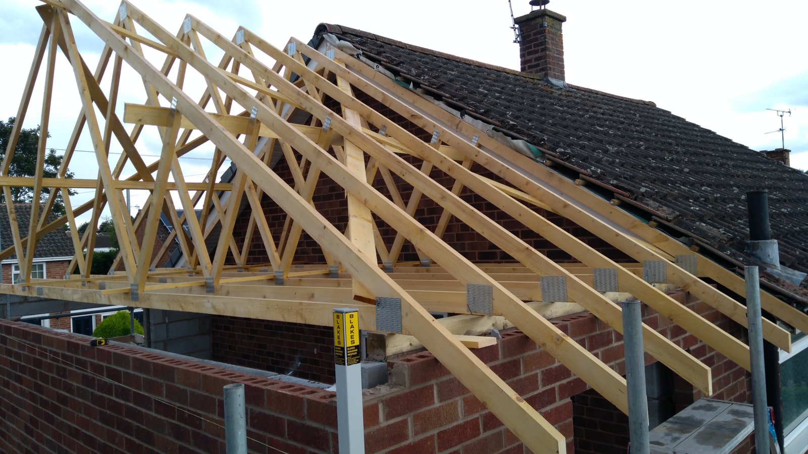

We put them up today and happy with the pitch, slightly on the low side but I'd rather that than have it too high. Bloody glad I double checked the measurements and did my own trig calculations or it would have been a disaster.

Your diagonal bracing should continue down to the wall plate. Add another short length (across say four rafters) and fix it along side the existing and down to the WP.
Yep, knew I'd got that wrong as soon as I did it. I guess you don't brace to the last truss then, in order to hit the wall plate. Bco didn't spot it, but yep I'll sort it exactly as you say.
Correct.
The truss drawing usually shows the diagonal bracing going all the way down to the WP.
