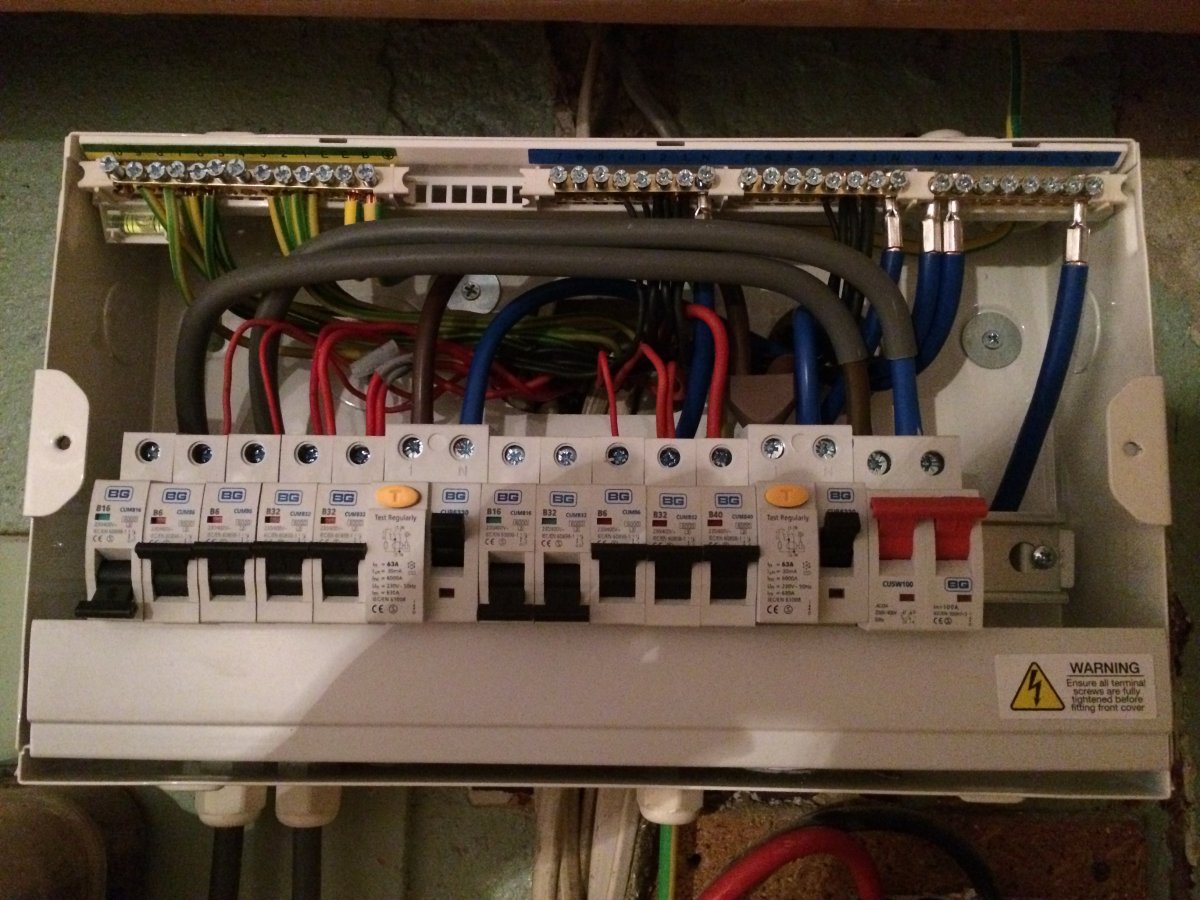

This is playing on my mind.
While the floorboards have been accessible I have mapped the cables of the top floor of my 3 storey house. One the third floor there is one cable coming up from the second floor that links to 6 sockets across two rooms in a series i.e two cables in each socket and one into the last. There are definitely no other cables connected to it and no switched fused sockets.
That made me think it was a radial circuit although I've read here that they might also be spurs off spurs particularly as 3 seem to have been added in.
I've had an electrician in who has put in a new consumer unit and has done a periodic yet and says it's all fine. He says I've got 3 ring mains - ground floor, kitchen and upstairs.
When I asked him how the upstairs could be a ring main if the last socket only has one cable in it, and that I understood you can't have a spur off a spur he looked at me blankly. Maybe I don't know what I'm on about as I know a little knowledge is a dangerous thing. Would spurs off spurs show up on the tests? Essentially he says it's passed the tests and it's safe so why am I worried.
I've had a bad experience with an electrician on my kitchen and had to have someone out to rectify the work so perhaps I'm being unduly concerned. He's done a neat job and it's being certified so should I just be satisfied with that? Thanks.
Sounds like you know more than he does.
If HE called them ring mains, that's another mistake.
What is the rating of the fuse or mcb protecting this circuit?
If what you describle is correct, then i would ask for the test results to confirm he has tested for ring continuity.

Sorry I don't know, that's too technical for me. Where would I get that info? Two RCDs, one covering the kitchen and one covering everything else.
BTW he might not have called them ring 'mains', but he definitely said ring

He's only just done it and said he would send it through in the post.
He said he's done a ring continuity test at the CU. He pointed to two red cables that he said make the ring. When I asked if he had tested each socket he said he only needed to test the furthermost socket from the CU which is the one with the one cable in it. I have pushed the point about the ring being altered with non compliant spurs etc but he said if it had the RCD would trip it.
Am I right in thinking it would trip only if it was overloaded, not if it was non compliant?
An RCD trips due to earth leakage, so either an imbalance on the live or neutral will cause it to trip. Nothing to do with overload, and so wouldn't trip if there was a spur off a spur off a spur off a spur off a spur etc
He's either not got a clue what he's talking about, or has realised you've caught him out not doing a proper job, and is trying to trick you into thinking he has
Shame he's brought his meter tails in through different holes. Bet there's not a slit joining them - I could be, and hope I am, wrong

Well when you knock out the knockouts on the back of a board, you open up a huge hole, we're talking the equivelant of 3 or 4 20mm knockouts. Most of the time this is mostly backed by plasterboard and isn't as much of an issue. When you then cut out the plasterboard to the same size (or bigger) to bring you cables through) there is now a huge exit for flames to shoot out of, up and into your stud wall.
They make intumescent putty and 'fireproof' silicone, but, this board, for sure doesn't have any!
