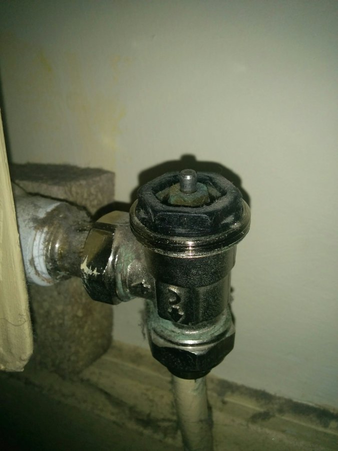

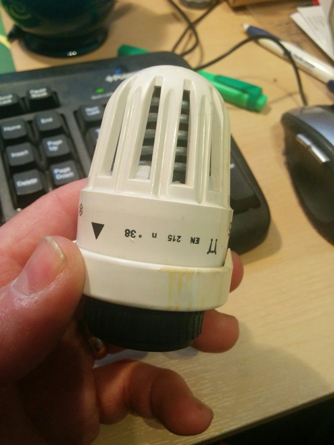

I would appreciate some help identifying this TRV. Ironically I fitted it about 15 years ago and now want to install wireless TRVs. However the attachment ring supplied with the new TRV, which is supposed to be compatible with honeywell, seems a tad too small.
Here are some photos of the old unit
Andy
It looks like a Plieger - a dutch company. Google for -> Plieger radiatorkraan
Mr Therm
Thanks for that, spot on. Been trawling through Dutch websites and still no wiser about compatibility with other TRVs like honeywell and why it doesn't fit.
Do you or anyone else have any wisdom?
We has another thread like this a few months afo, though I don't think the brands were the same.
Can you accurately measure your thread?
IIRC, the honeywell thread is M30. In the other thread it was another make that was M28, and for which adaptors are available. Yours is larger than M30?
