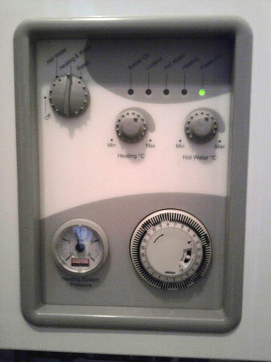

Do I need a Gas Safe bloke to install a room stat or is it a simple procedure I could do myself?
What will a Room Stat do for me? We never have the heating on so much that the house gets too warm.
It will turn the boiler off when the house is up to temperature. This will save you gas, i.e money.
Although your boiler has internal controls to shut it down, they are not so accurate as a wall mounted thermostat. This is why it carries on running when it shouldn't.
In theory it need someone with Part P electrical qualifications, not GasSafe. But as it's no harder than wiring a 3 pin plug, you should be able to do it yourself.
You need a thermostat with volt free contacts (most of them are, but you need to check).
The thermostat connects to terminals 1 and 3 in the boiler (remove the existing link).
As you have no thermostat at the moment, it might be easier to install a wireless version as it saves running wires from the thermostat in the hall or living room to the boiler.
The Honeywell DT90E (wired) and DT92E (wireless) are very good.
PS This assumes you already have a separate timer.
Sounds good, looks easy.
I could place one in the hallway and just drill through to the cupboard the boiler is in.
The timer dial is on the boiler itself (see pic)

We always have it on MAX so I guess this wouldn't be a problem, although IF the wall stat never got up to temperature then I guess it wouldn't shut off the boiler would it?
From what you have said about the house never feeling warm, I am beginning to wonder if the heating installation is adequate. This would account for the boiler running for so long.

Boiler being used is a Halstead Ace High

The Ace High can vary its output between 11kW and 30kW, so the required boiler size is at the bottom limit.
The problem is, and this could be the cause of your problem, that you only need this output in the depths of winter, say for a month a year. The rest of the year, when it is not freezing outside, the boiler needs to produce less than 11kW. As it cannot modulate below 11kW, it does this by turning on and off.
And here is where the problem really lies: every time the boiler starts up it goes to max output, 30kW, winds down to 11kW and then turns off again for a time. This means that the system never reaches the required temperature, so the house never feels warm.
The only solution is to change the boiler for one which can modulate lower than 11kW - the lower the better. That is probably not something you want to do. :wink:
The reason this problem arises is that most installers and boiler specifiers consider only the hot water requirement when sizing a combi boiler. They ignore the heating requirement completely.
At least the total radiator output is correct and you could install larger rads without the boiler running out of steam. :)
The boiler can only modulate down to 11 kW if the gas valve is set correctly. They can drift with time.
Most boilers can set the maximum power on heating and if thats at maximum the boiler comes on at 30 kW and goes off very quickly.
If the power is set to say 11 kW then it will stay on for longer and give out more heat to the house.
I dont know if your boiler has this setting and I dont remember one but in any case that would ideally be an engineer's adjustment. Someone may look up the book and check for you. Even when there is an adjustment some manufacturers dont mention it in the instructions.
Tony
I don't know if your boiler has this setting and I don't remember one but in any case that would ideally be an engineer's adjustment. Someone may look up the book and check for you. Even when there is an adjustment some manufacturers don't mention it in the instructions.
Yes, there is a pot on the PCB for setting the max output - it's mentioned in the Installation Manual. It can be set anything from min to max. It adjusts the burner pressure.
Would be worth getting it done. Get it set to about 14kW
