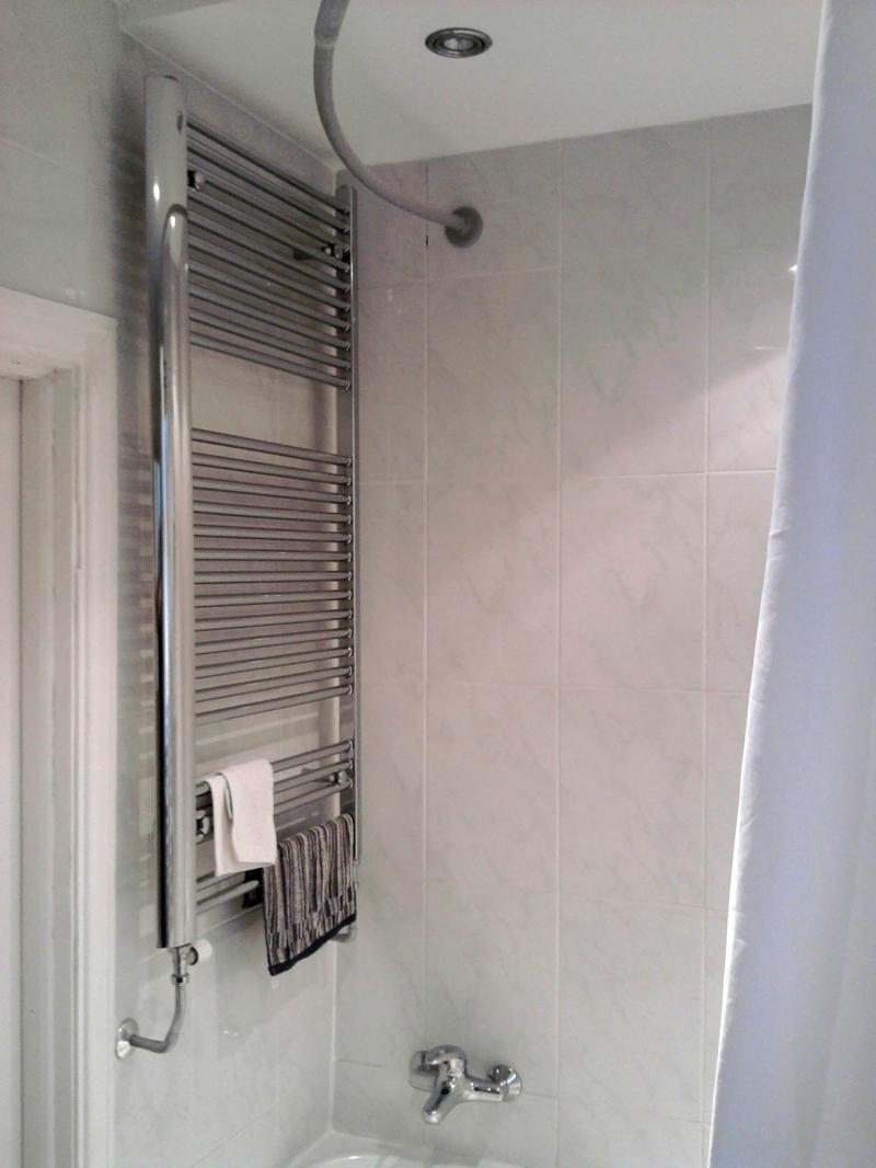

Actually thinking about it I don't really want to reduce the temp in the Bathroom as it's the coldest room in the house.
Instead of a 'proper' rad in the Bathroom it's got one of these Chrome Towel Heater type rad's. It's quite big though, see pic.
The bathroom's only about 9'x5'.
What would you recommend?

That means it will adjust the size of the flame, and the amount of gas used, depending on demand. I will guess that your funny bathroom radiator might have an output of 2kW. That means it cannot possibly use enough heat to keep the boiler burning continuously. Even though it is switched on, the boiler will adjust itself to its lowest flame setting, then turn off for half an hour or so until the radiator has cooled a bit and can absorb some more heat. You may find the boiler getting louder and quieter as it turns itself on, down, and off. You will also observe the gas meter getting faster, slower, and stopping.
BTW you really ought to get a room stat fitted. You are tipping money down the drain without one.
