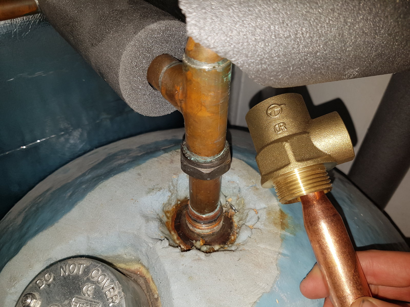

I've just installed a new 22mm feed to where a 2 bar shower pump is to be installed from the hot tank. I bought a surrey flange expecting it to screw in, but this doesn't seem to be the case.
I have a supercal 900x450 hot tank.
Any suggestions?

Yeah think it will have to be an Essex flange. Was hoping to avoid it, as I've heard they're fiddly and prone to leaking.
