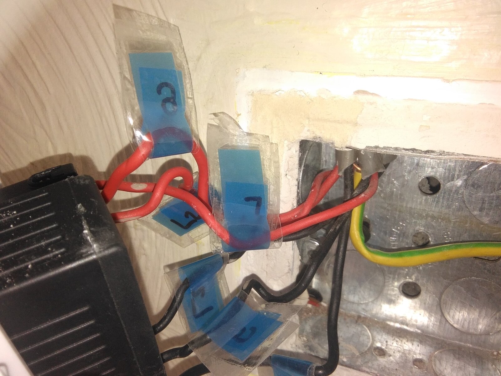

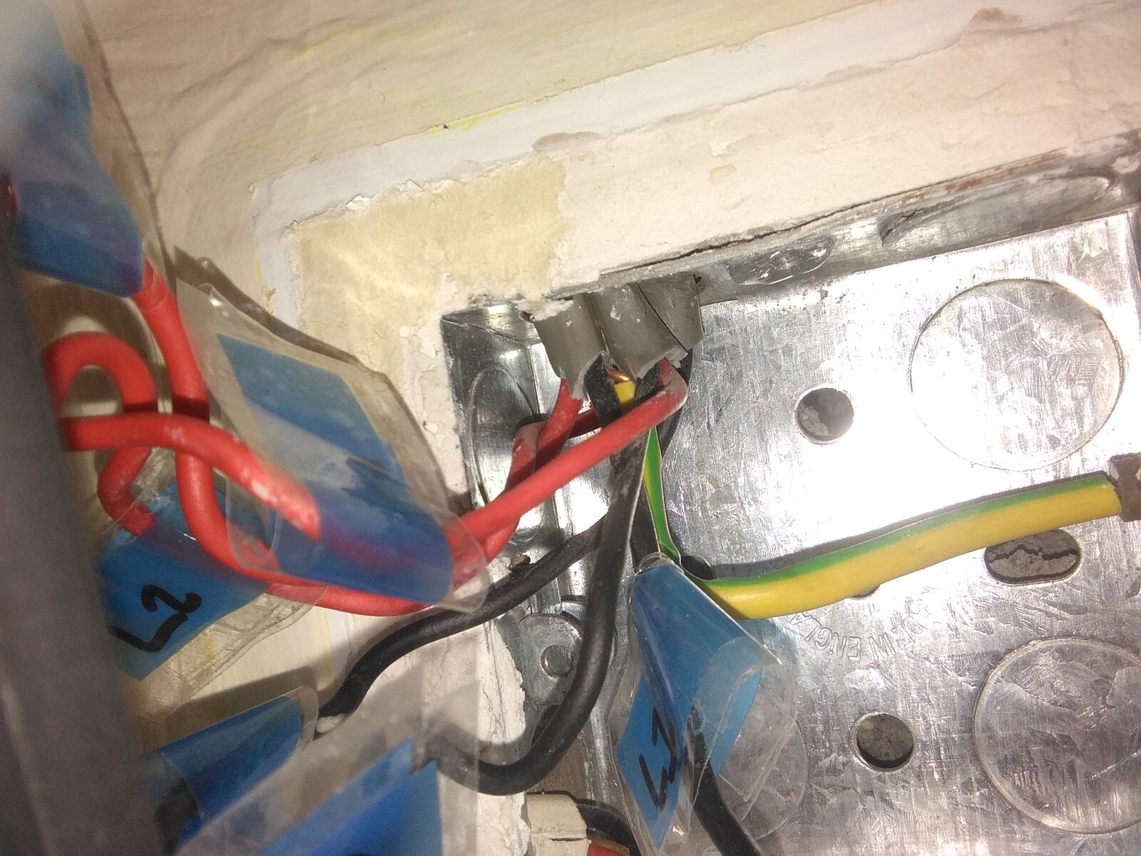

It’s a brass tube terminal which is attached to the back box. It’s less common for it to be in this position rather than the corner of the box but perfectly normal. It looks like the CPCs all terminate into it which is fine, although a link wire to the faceplate would be desirable.
It’s a brass tube terminal which is attached to the back box. It’s less common for it to be in this position rather than the corner of the box but perfectly normal....
I think we are probably all agreed about that, but ...
.... It looks like the CPCs all terminate into it which is fine, although a link wire to the faceplate would be desirable.
You must have good eyesight. I was (and remain) far from convinced about that, and now SUNRAY is also having doubts. How sure are you?
Kind Regards, John
Kind Regards, John
I'm saying there is a terminal and there is green/yellow sleeve which appears to end by the terminal. What I thought was the point at which the copper entered the terminal is not clear enough to say for certain whether it is terminated.
However if I had to make a guess I'd err towards it being correctly terminated, which was my initial gut feeling.
I'm saying the same.
If I had to, I would 'guess' the same - but guessing is not a very good idea!
Kind Regards, John

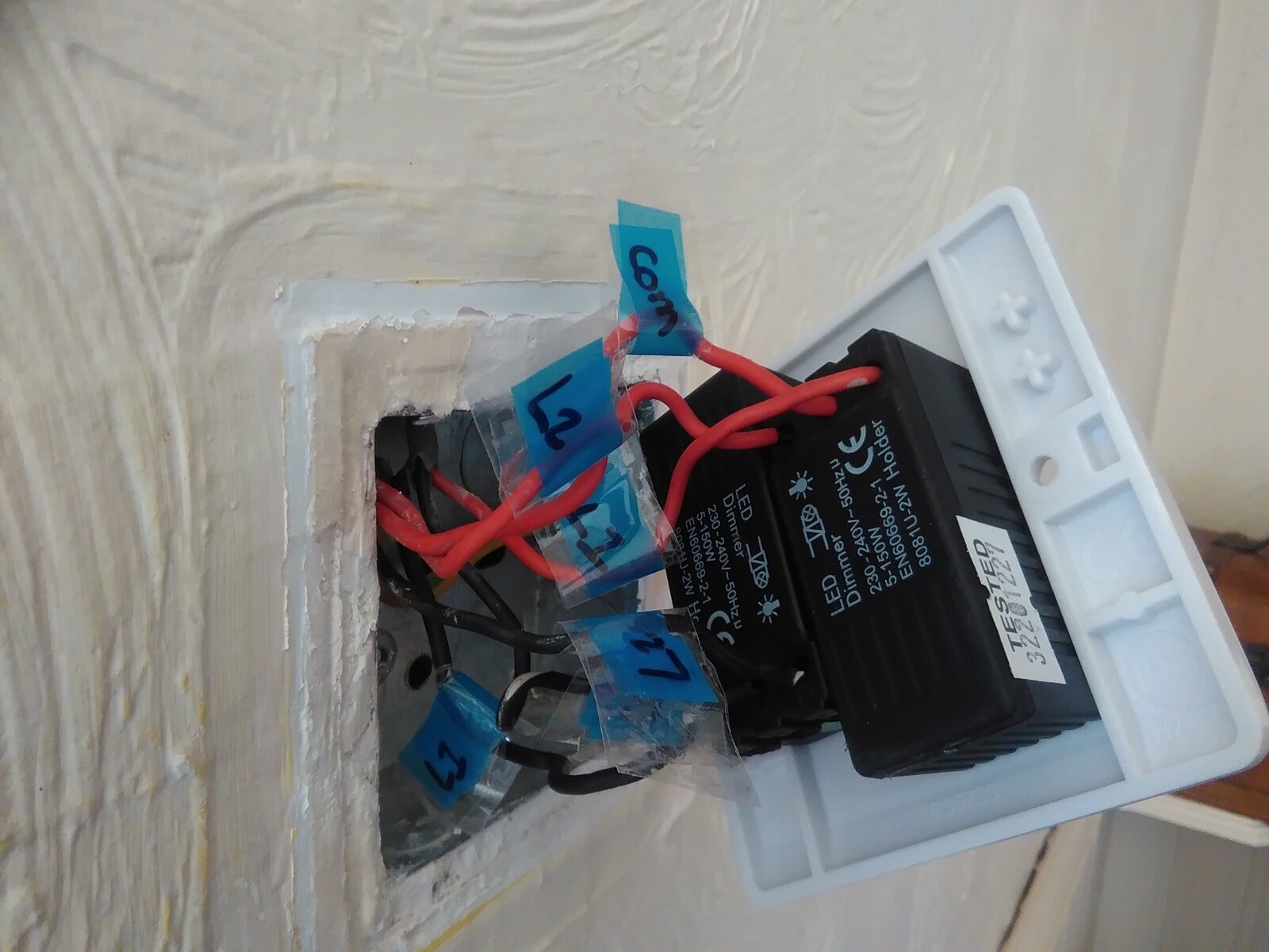

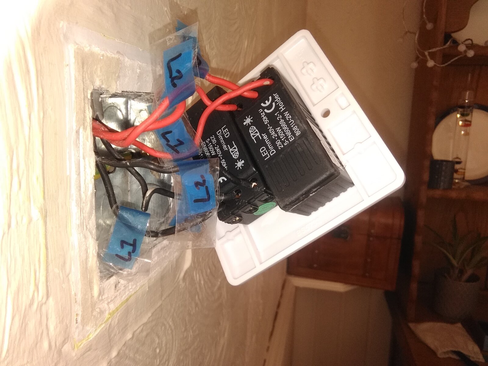

I've taken more photos to show the wires better. I removed the labelling from all the wires yesterday once I'd changed them over but I've relabelled them exactly as before.
The way I wired the new dimmer was to copy across how the wires had been wired in to the old brass switch. For example the top red L1 I put into the top red L1 on the dimmer. John, I can see from your earlier post that this is incorrect. I was just so confused seeing 3 red and 3 black wires I was lost as it didn't match the wiring diagram that came with the switch!
Just to clarify, there is a yellow and green sheath that contains 3 copper wires, 1 from each grey cable and it is wired into the back box.
Also, I have bought an led dimmer, not a regular one.
Any further advice would be greatly appreciated. Thank you again!
Jo

Right. Thanks. As has been said, you should add a wire (with green/yellow sleeving) from that terminal in the back box (together with the existing wires) to the earth terminal on the switch, so as to reliably earth the metal plate of that switch.

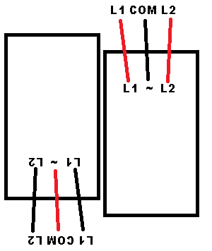

For a start your old switches had a combo of red and black in each one, you appear to have put ALL the reds in one dimmer and ALL the blacks in the other, so will obviously not work.
Clue, look at how and where the COM wires were on the old switches, each switch Left and Right has its 3 terminals laid out in a triangle NOT in line across the top

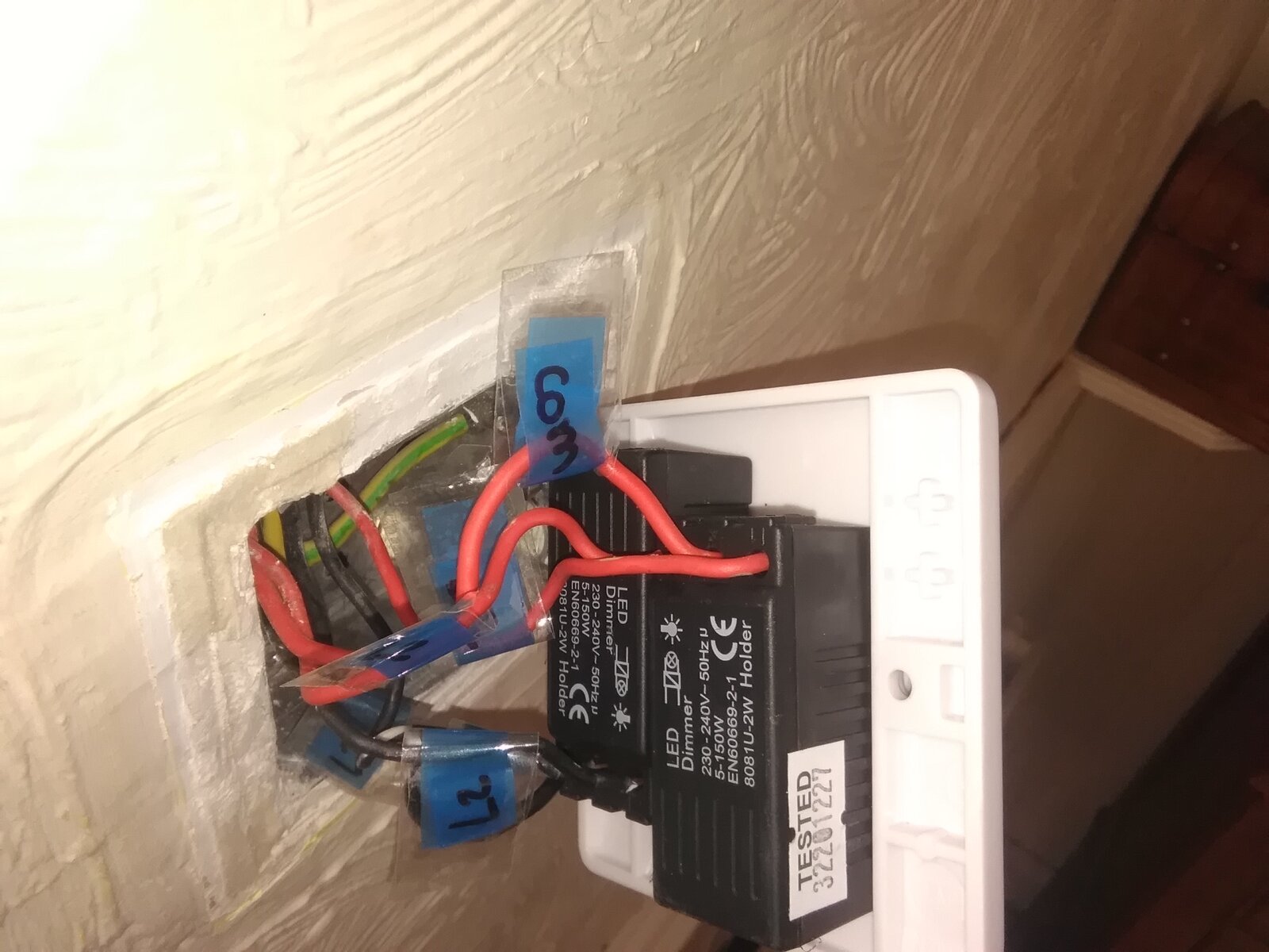

On your new, black, switch, I can't see the terminals, and I can't see the markings.
I expect each switch to have three terminals.
How are they marked?
Many, many thanks to everyone who offered their advice and shared their knowledge.
Special thanks to Sunray, I followed your diagram today and it worked! I'm thrilled that we now have light again.
You are all an amazing bunch! :)
