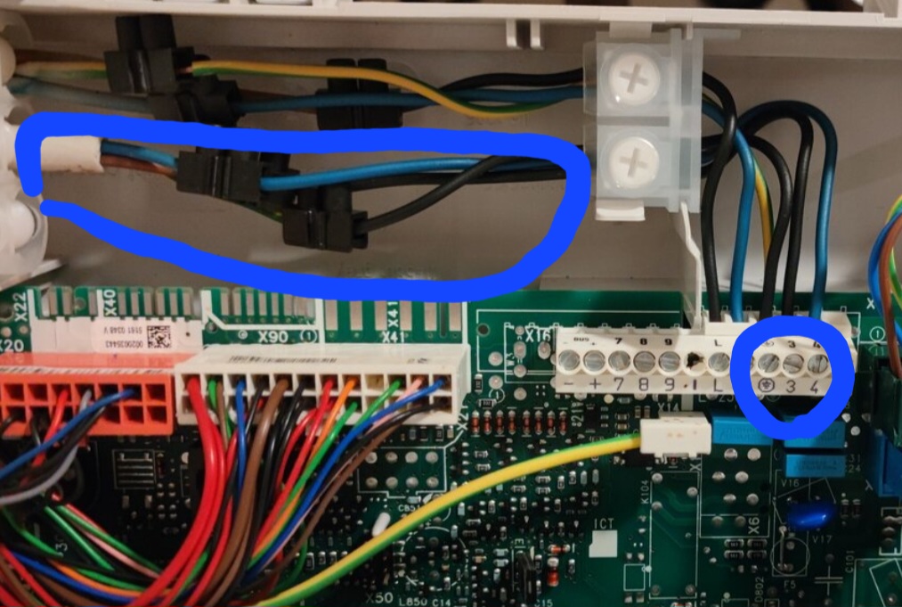

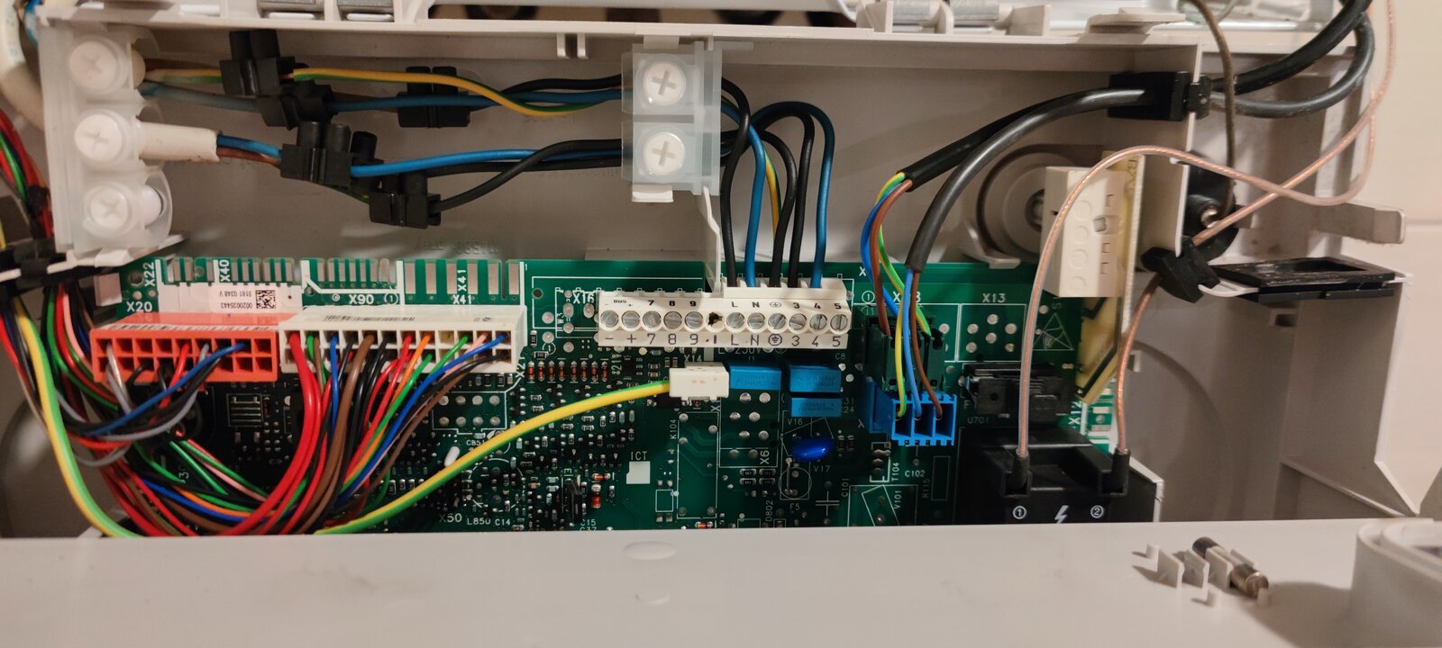

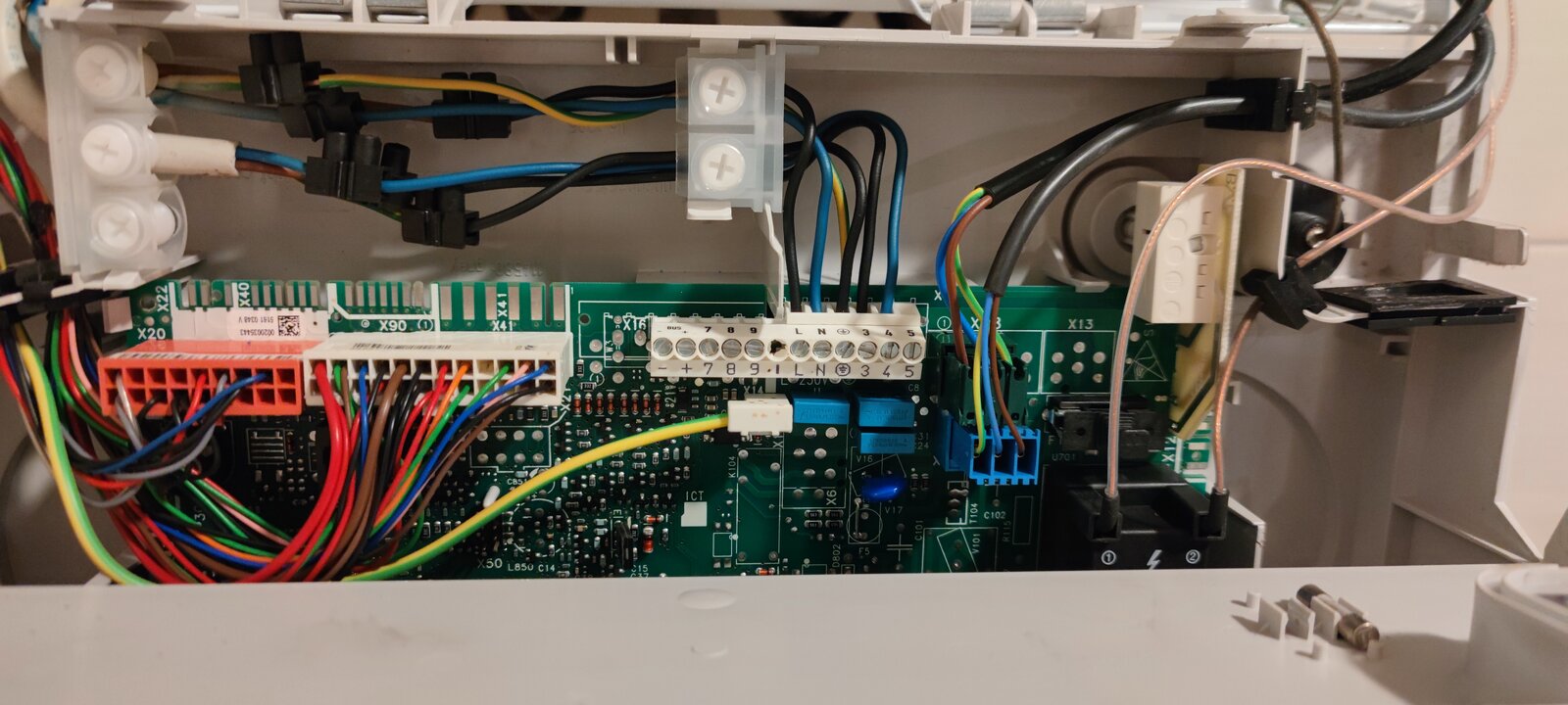

Hello, I've bought the thermostat in the picture and have connected the 3 wires from my old thermostat. The thermostat turned on but it won't turn on the boiler. I have boiler board photo attached. Please help.

I'm afraid your existing wiring isn't sufficient for your new stat.
Was your existing stat battery powered, or mechanical?
Your new stat turns on, because it is receiving a Live feed from the boiler (brown, or blue wire), but the other wire is a Live return - it is acting as a false neutral, providing a current path back through the boiler.
The green/yellow cable is connected to the earth back at the boiler. This isn't a switched live wire.
For the new stat to work correctly, you need to provide it with a Neutral wire, preferably through a new 4 core cable.

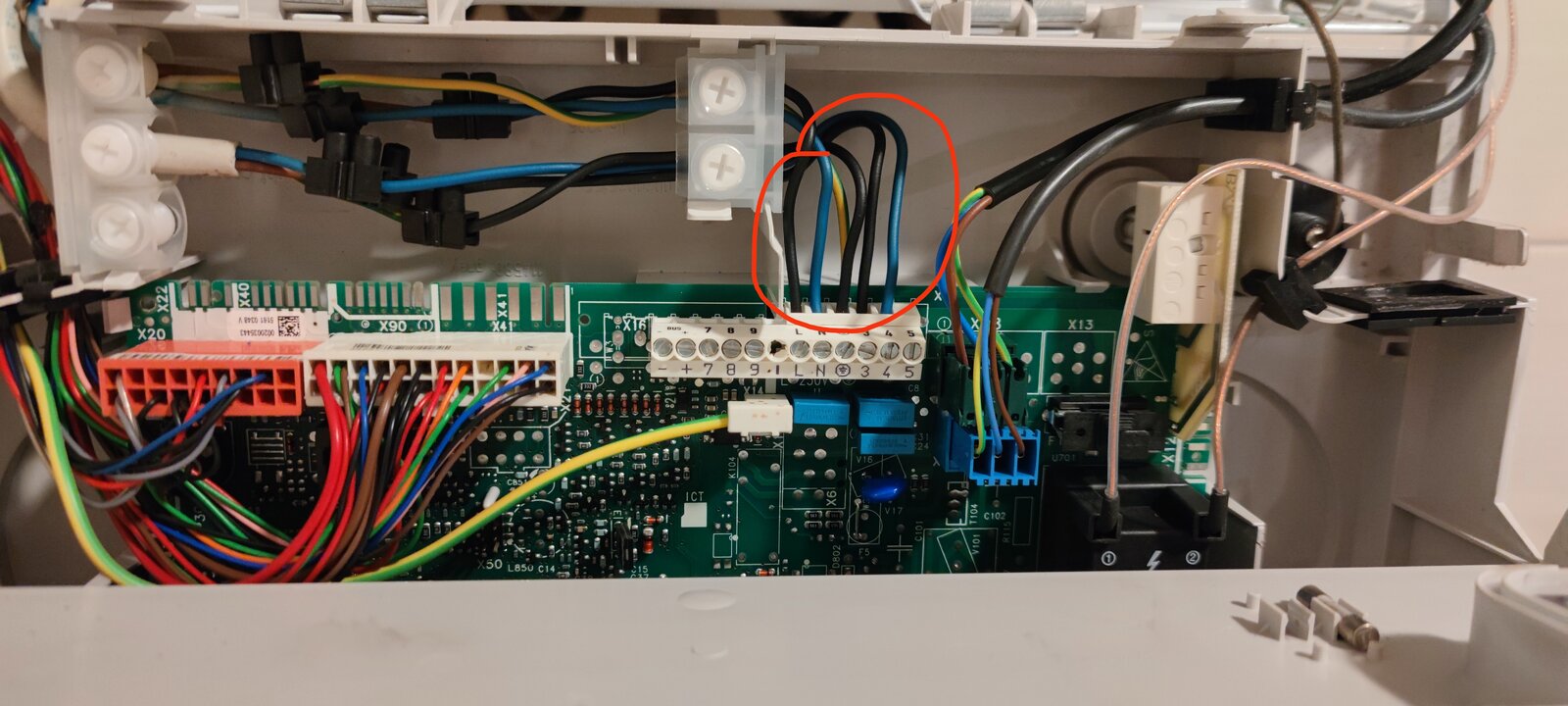

I have all these 6 wires pulled to the thermostat, can I do something? The old one was battery powered.
So two cables come out behind the existing stat?
Is there a fused connection unit nearby?
If so, can you post a picture of all the wiring available?
No, there isn't a connection unit. On the picture above the 6 wires that are connected to the boiler are pulled through to the thermostat but only L, N and ground where connected to the old unit. 3,4 and 5 are just left behind tied.

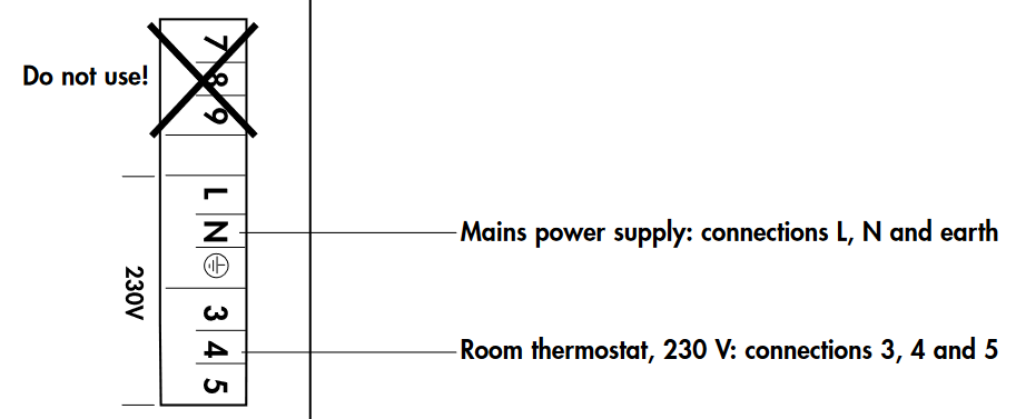

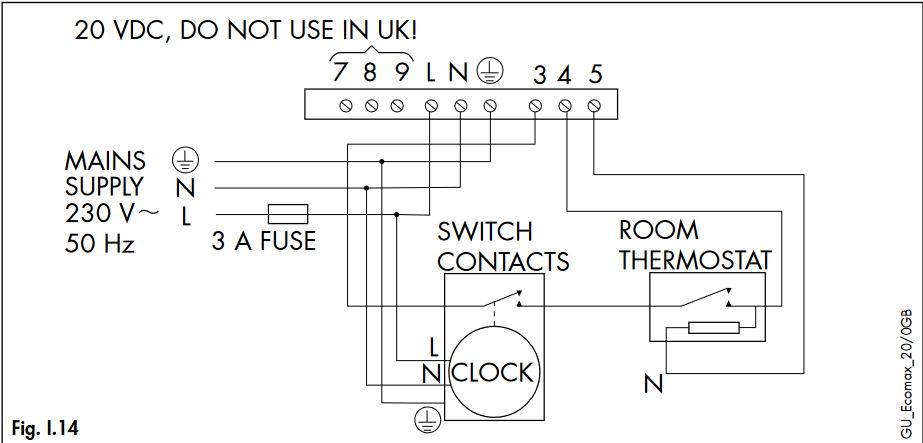

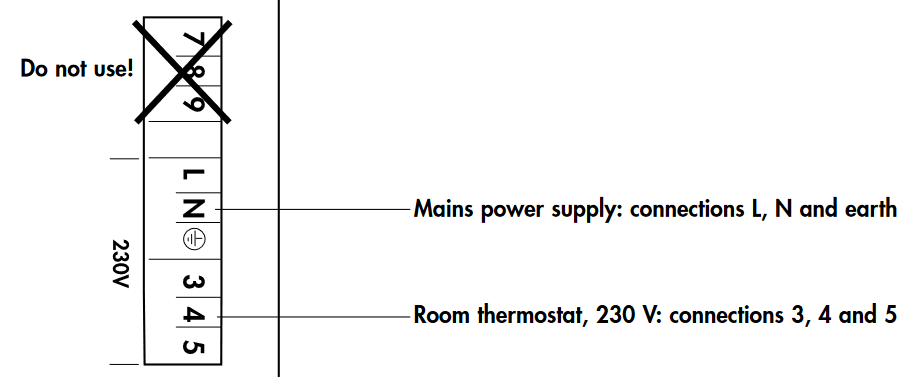

Hardly surprising it does not work. A look at a Vaillant manual shows. 1730983918172.png And also 1730984271181.png so it would seem 3 and 4 go to volt free contacts, and 5 is a neutral, but it does not seem to show which is feed and which is return with 3 and 4, but easy to test with a meter.
However one wire to com and nothing to normally open is so clearly not going to work, I would say you don't have the skill required for the job.
I would suggest you get a battery powered thermostat like Nest e which only needs two wires. Or employ some one with a little electrical knowledge.

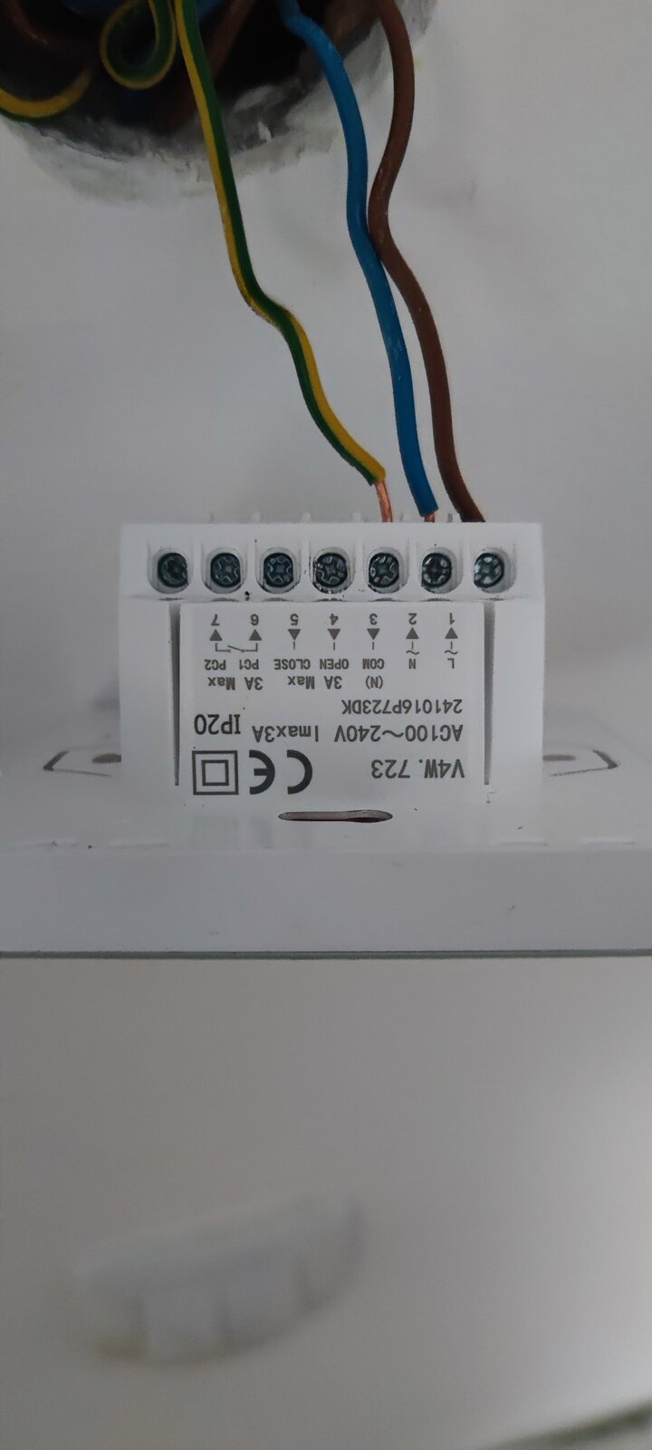

One more thing that is bugging me is that only when I've connected the ground wire into 3 COM the thermostat turned on.

3 is live out/common and 4 is live return/switched live on that boiler.
@Milenkoste - you need to be careful before you damage yourself and or the boiler. Guessing can be dangerous. I don't see at the boiler end a green and yellow CPC (ground as you call it) being connected to anything other than the earth terminal.
At your new thermostat you need power (L and N) and 3 and 4 from the boiler to Com and open (ironically the same numbers on the stat). When you have finished, make sure you test the boiler for safety as the cover forms part of the combustion circuit.

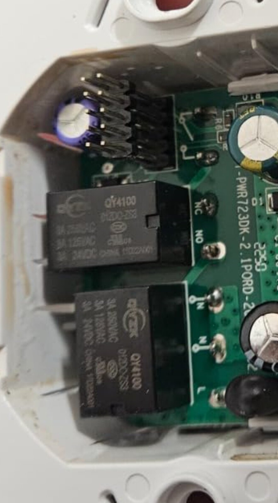

Your replacement thermostat is designed for underfloor heating actuators.
A live output is provided on terminals 4 and 5 to open and close the actuator.
Terminal 3 is a Neutral terminal (even though labeled COM, its a little confusing) - connecting it to earth would allow the stat to power up, but shouldn't be done; it may also lead to nuisance tripping.
If you must use that stat, you should use terminals 6 and 7.
Looking at the thermostat on Amazon it states not to connect live wires directly to PC1 and PC2 as a short circuit may occur. 3 and 4 from Vaillants are live and switched live. Seems a return to Amazon might be in order with a good gas engineer and decent thermostat :unsure:
Interesting point.
It's difficult to get full manuals for Tuya, to confirm anything, but I suspect that the wording is a slight mis-translation.
The connections are listed as 'dry contacts', with a 3A rating, which suggests live switching should be fine.
A reviewer also helpfully left a pic of the PCB, which again shows a mains rated 3A relay with dry contacts (the one in the middle)...
I don't know what the words really should read - but without clarification from a manual, as you say, better to stay on the safe side!
Coming back to the existing wiring, the wires that we see behind the thermostat are these...
Connecting to terminals 3, 4 and earth.
If there is another set of wires tied up behind, are they connected to anything?
The other cable at the boiler, connected to the L,N and E terminals provides the power to the boiler.
If the other wires behind the stat aren't connected to anything, it is unlikely to be this cable, or the boiler wouldn't have any power.
