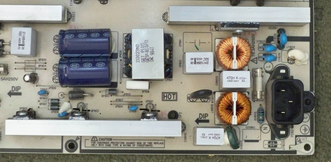

I am not sure where this is going but my last TV, from 2009 I believe, a Samsung LE40B550 had an earth but no exposed metal.
My current TV does not have an earth.
