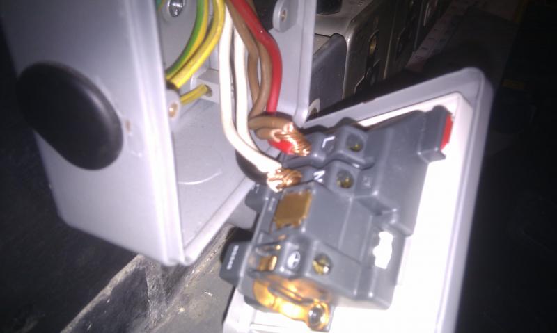

As I think has been established, don't twist wires - otherwise in extreme cases you can end up with things like this which I discovered a while ago:
(Yes, those are brown and white wires (long story to do with previous uses of the cabling for 110V stuff), and the CPC that looks like it's heading into the backbox was in the socket, but popped out as I opened it - now it's all properly re-terminated and sleeved etc!)[/img]
