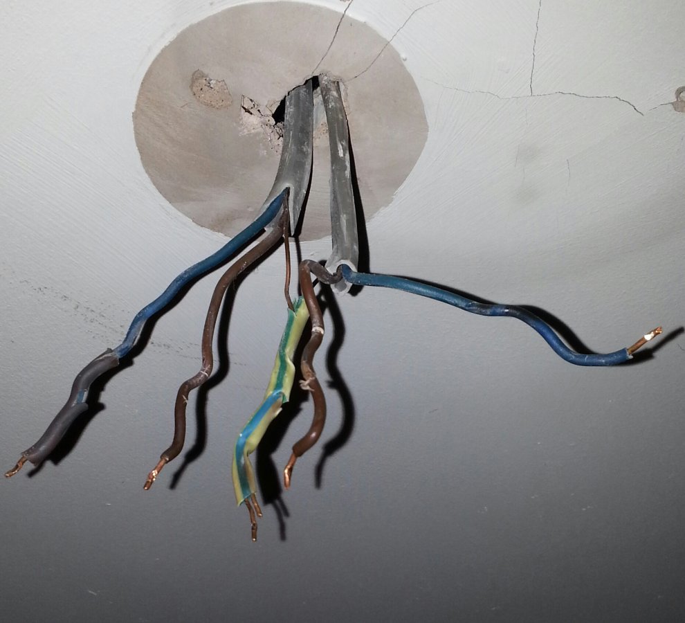

Ah I'm curious what the mean question was! Oh well, never mind! I've attached a picture of the cables, as someone said above there is indeed the sheath on on of the neutral cables, so that would seem to tall which is good.
Also it looks like the holes from a light before the one I removed may fit the same centers, which would be nice :)

That wiring is well cooked!! One giveaway is the cracked skim on the plasterboard showing it has got hot over the years.
The others are discoloured pvc insulation and sleeving and cracked insulation.
You will have to see if you can pull any slack gently out of the void.
If not, you will need to access the space above and joint it out with a MF junction box.
Thanks for that, I did notice they were a bit tatty, they're pretty long so I think I can snip some junk of them and get clean wires. The bathroom is above, with freshly layed tiles, on top of ditcromatting and plywood! Access from above is a no go!
