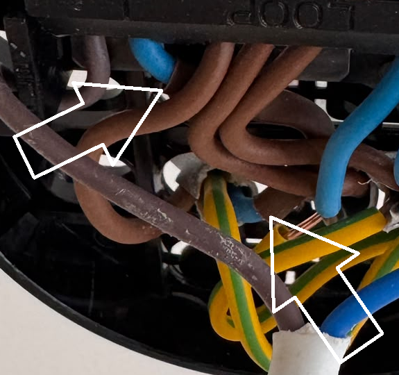

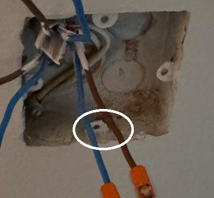

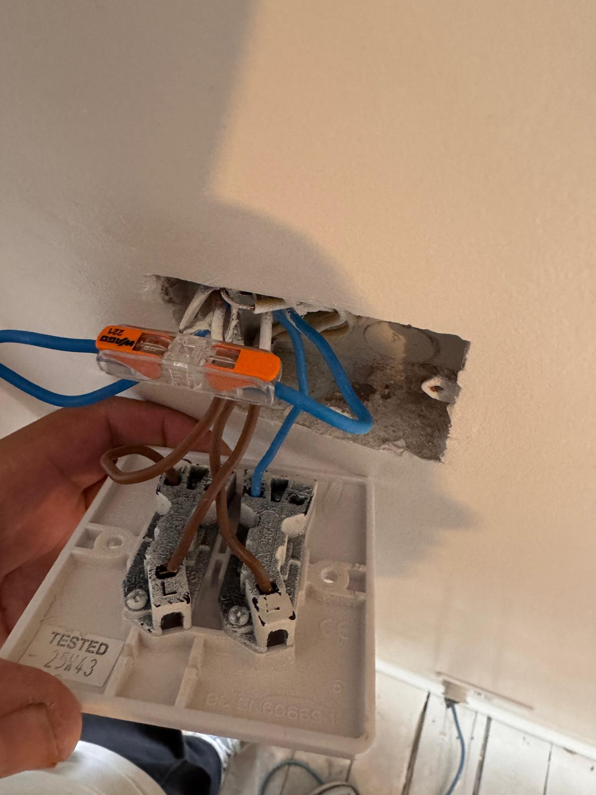

Two gang light switch - what am I doing wrong?

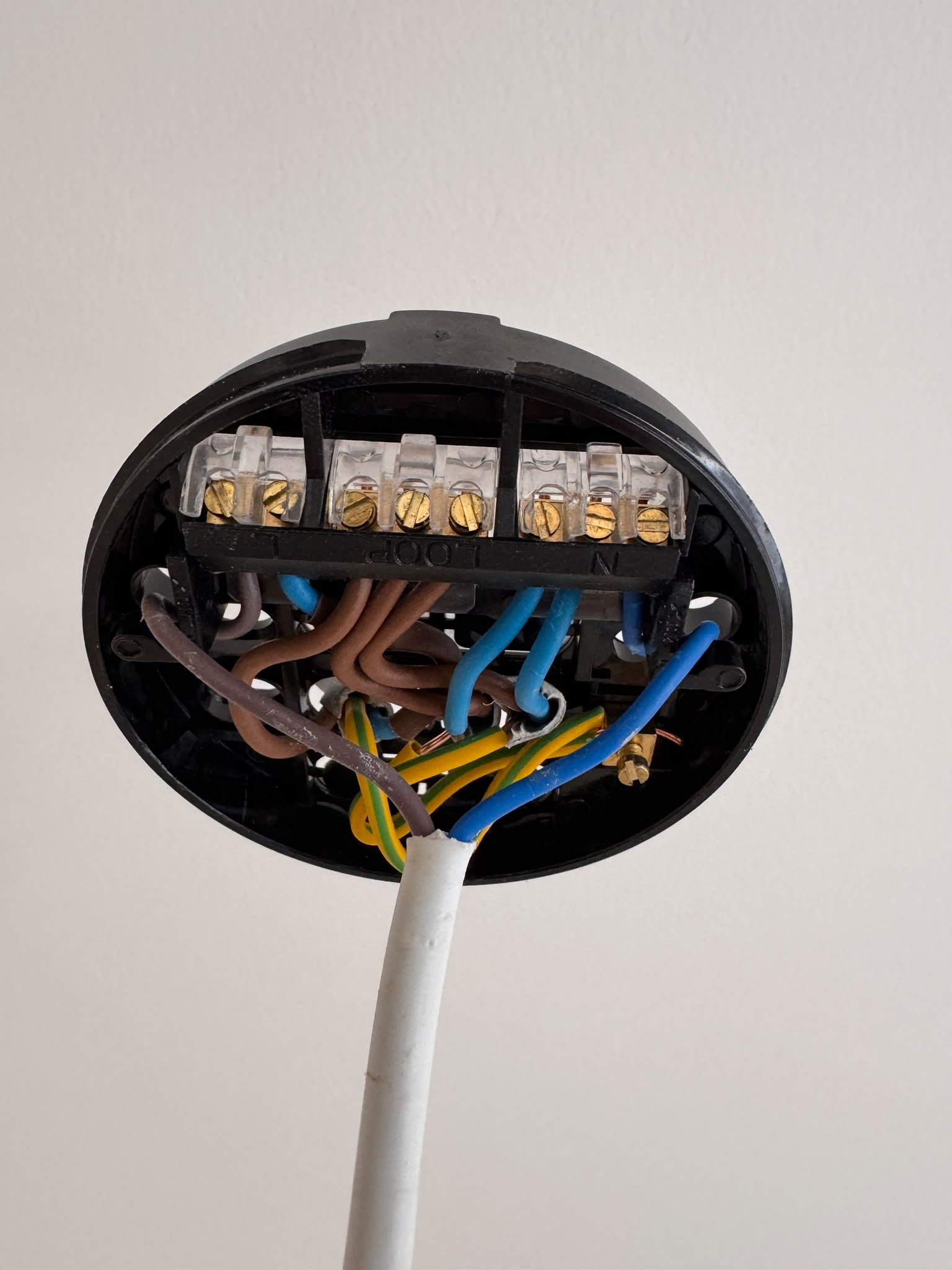

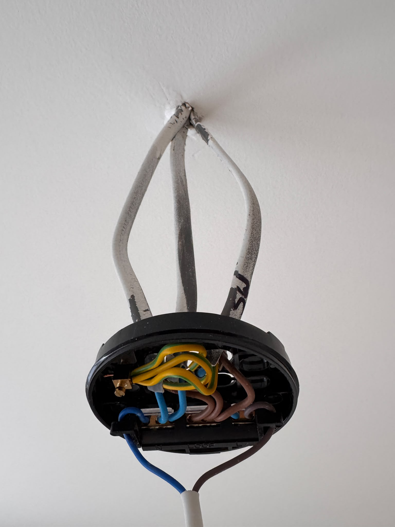

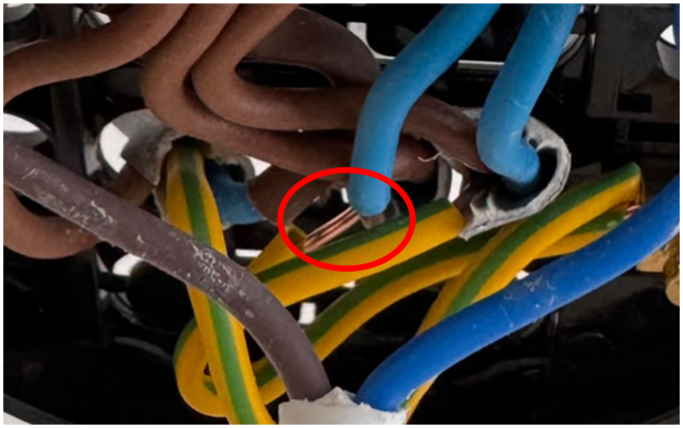

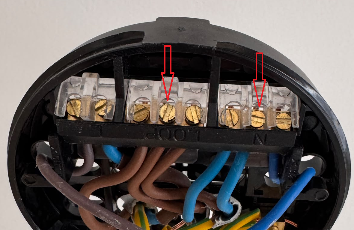

You have a blue sleeved brown which is Live at the ceiling, so perhaps the same at the switch, but not sleeved?

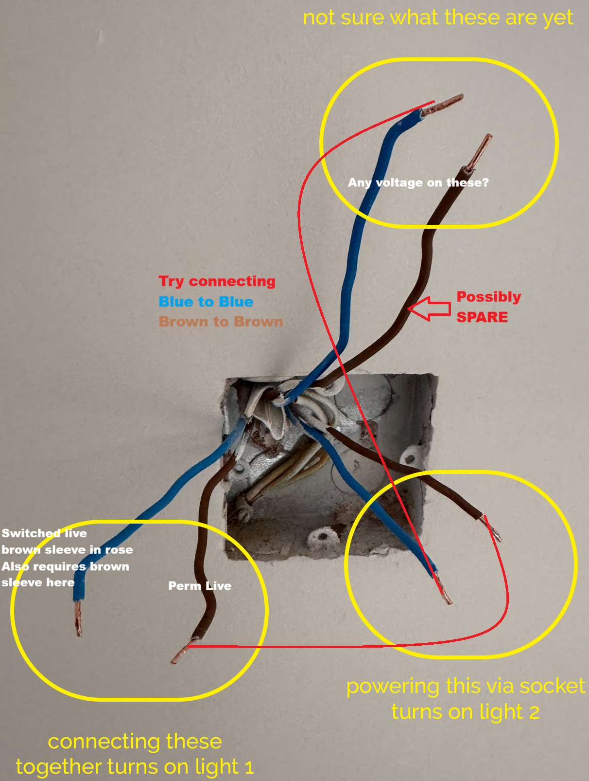

As per the photos - there isn't a blue sleeved brown wire at either the ceiling or the switch. The electrician wasn't particularly keen on marking wiring unfortunately (even though I asked him several times).

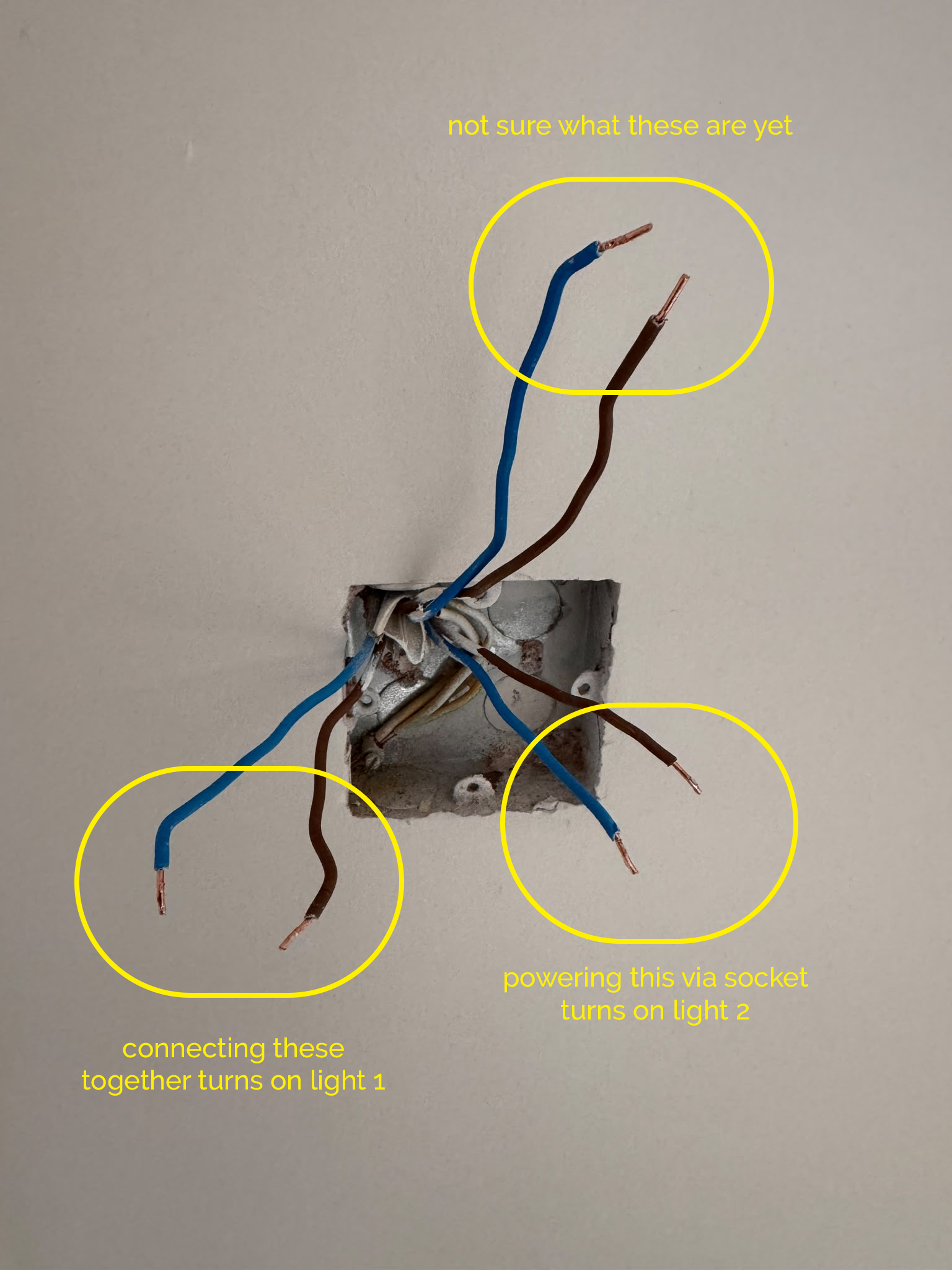

Is it 2 lights this switch should turn on and off?
Turn all the power off and test continuity between each brown and blue and brown and blue marked brown in the light.
