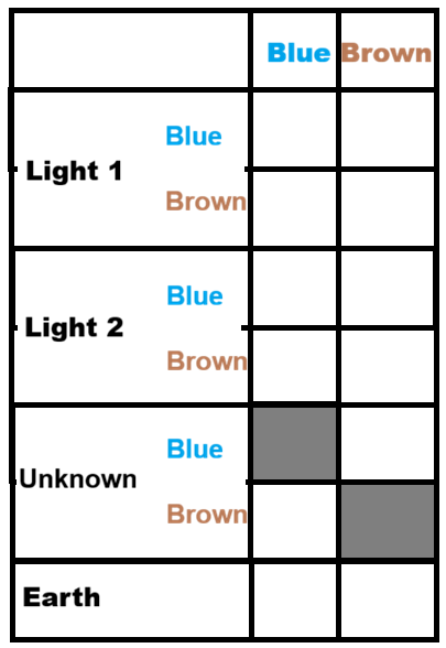

Two gang light switch - what am I doing wrong?
Is the right hand switch the blue and brown from the same cable? (Light 1)
I know in the photo it's not clear but, Yes it is - that light works.
What I can't get my head round is why the second light doesn't work if I loop COM to COM?

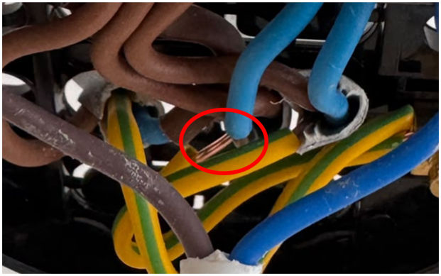

Did you check this bit?
any thoughts on this:
Tested between unknown blue and perm live - there is no voltage. :confused:
