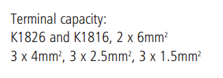

MK Logic:
If it takes 2 x 6mm² (and/or 3 x 4mm²) then it will take 4 x 2.5mm².
I don't have any UK sockets here. Would someone please measure the actual size of a typical socket terminal and let me know or post a link?
Ah, found one.
Click Scolmore - the same for their metal clad sockets:
where it states 5mm. diameter.
Strangely enough they state 4 x 2.5mm² but 2 x 4mm² (sort of) so clearly such information is not reliable.
In actual fact 5 x 2.5mm² would easily fit in a 5mm diameter terminal.
