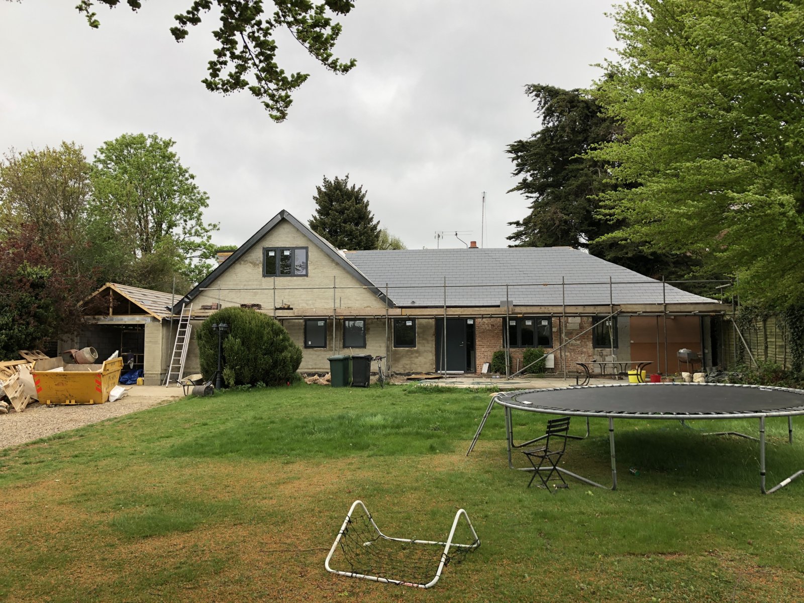

Just to further complicate matters - we’ve had the existing roof re-tiled to match the new area - will add some pics to add context - but any advice most welcome - my preference would be to ‘leave it as is’ - but I understand that reverting it to ‘storage’ from ‘illegal loft room’ may involve removing heating, plug sockets & restricing access from the main house (I.e it can’t have a ‘normal’ door - otherwise it’s trying to be a habitable room....

Extension on the left - existing loft room above the front door

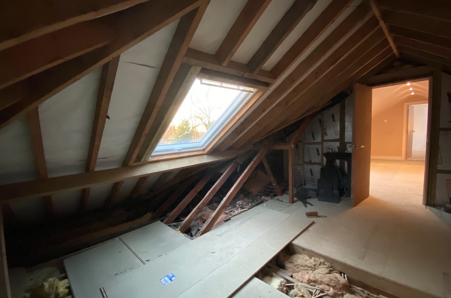

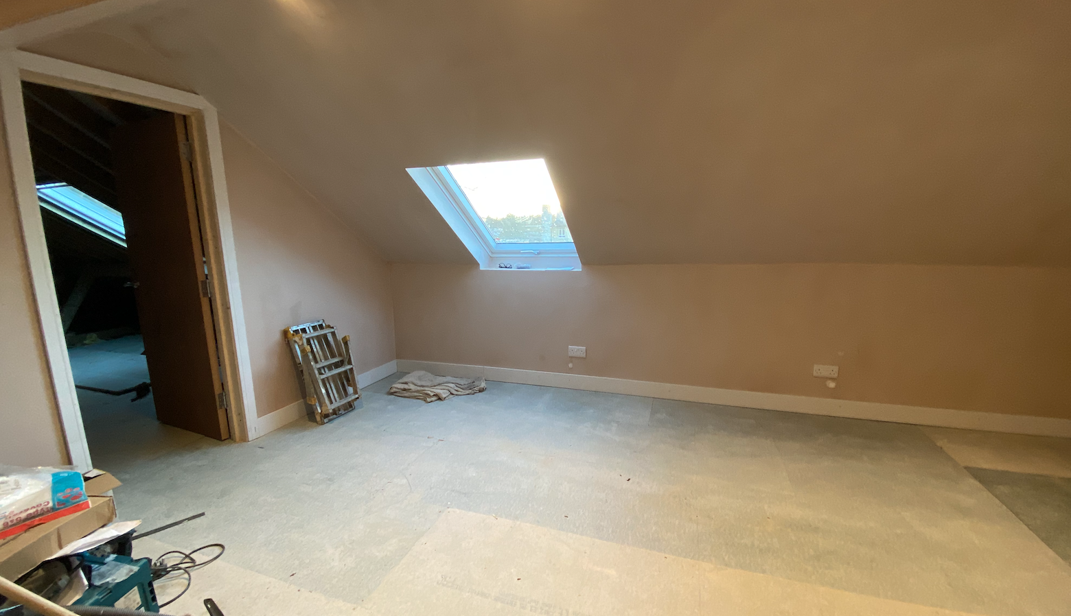

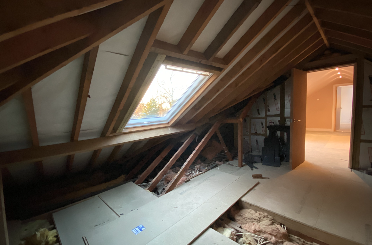

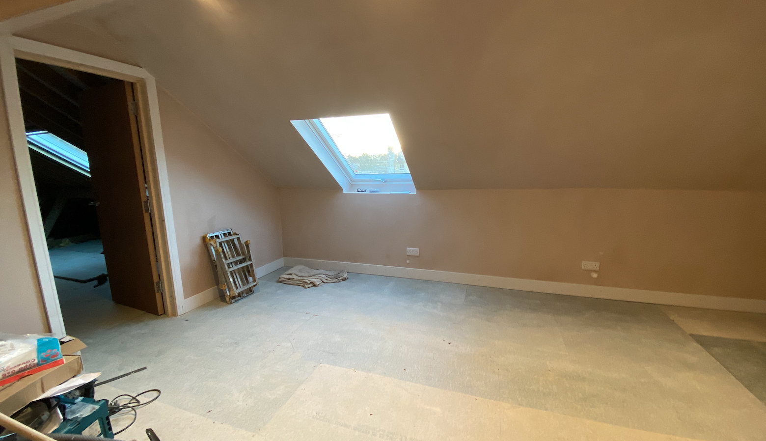

We have had the previous loft bit done (floor joists built up, rafters battened out 150mm celotex etc.) which has given a signed off (hurrah) previously functional loft room.
We now have a loft store space accessed by a door from the newly re-converted loft room.
it has a fire escape velux and the floor is proper (as opposed to the thinner joists on the other side)
We have no intention of using is as a bedroom - but i would like to use it as a chill out space.
Can i put 100mm celotex in the rafters and just crack on with OSB board?
Is this going to cause issues with the difference between an habitable and non-habitable space?
apologies if these are dumb questions - but having been burned first time round - i'm keen to get this bit right!
here are a couple of visuals form the newly converted bit into the loft storage space & vice versa

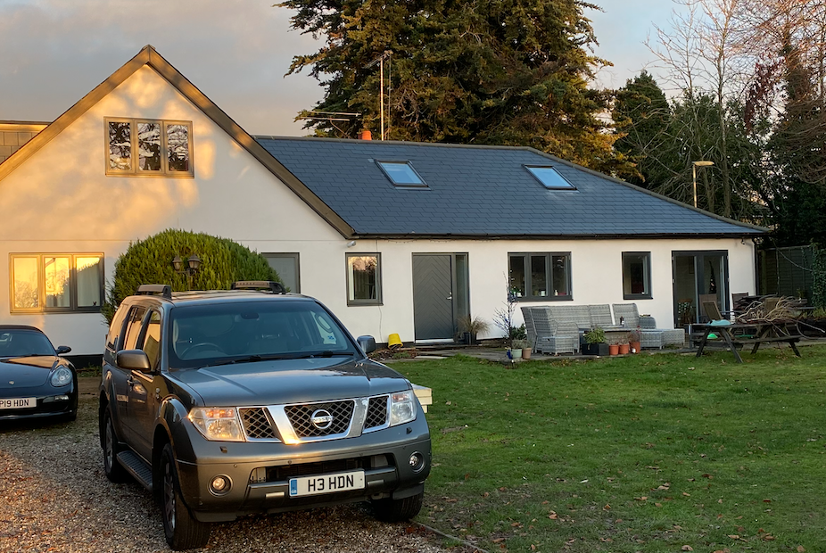

and a view of the front, so the context of the old loftspace makes sense
