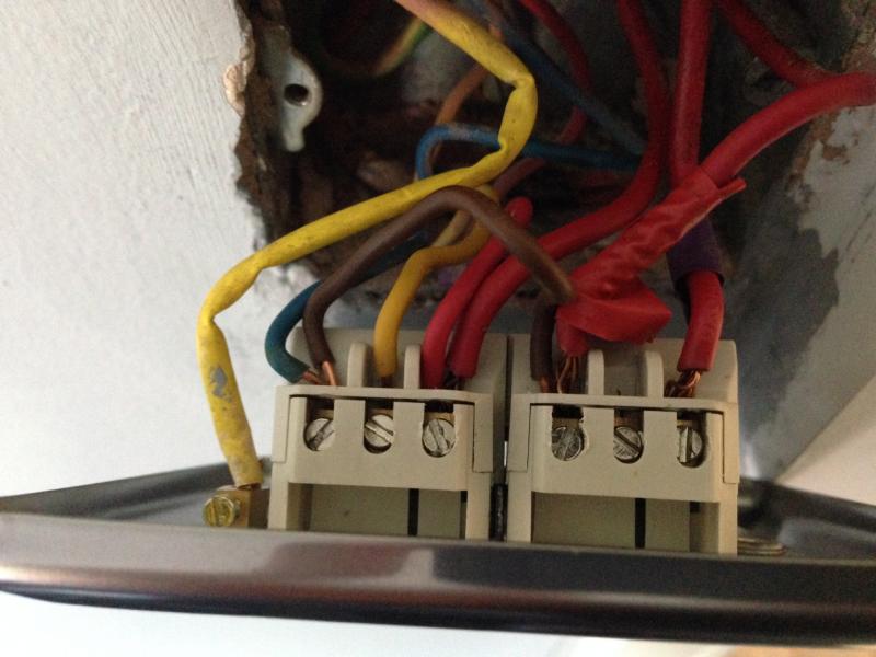

I need some with fitting a 2 way dimmer and 1 way switch in kitchen/diner with LED dimmable bulbs.
I fitted the an eclipse 2 way dimmer and rocker switch the other side but somewhere there ia fault as the lights dont go out but i fitted everything as it was before with 2 dimmers but with GU10 standard bulbs.
On the 2 wat side i have an earth, a blue, then yellow and 4 red wires which has be confused and a brown link wire.
The other side is just yellow red and blue where i intend to just fit a rocker or should i get another dimmer there to make it work
Many thank sin advance

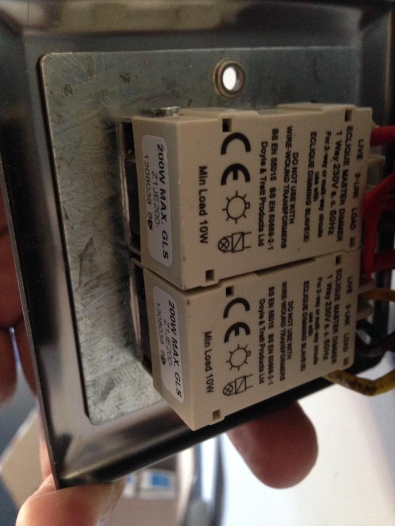

I have attached a couple of pics of the switch and wiring
At the moment i want a fit rocker switch at the 1 way end and this dimmer at my 2 way end.
I got it all working with a dimmer at the 1 way end and the only problem is the bulb dont turn off, the switch tried to turn them off but they stay on at a dim level
Im thinking it could be the bulbs maybe?
Hi, if I recall correctly- The rocker switch should be wired with L feed =C and the L1 is connected to S on the dimmer. If you connected L feed to s on the dimmer you will knacker it !
The rocker switch must be a reactive type as the dimmer only requires a pulse to ramp the lights up or down.
Hope this makes sense !

That wiring to the switch there....
Have you altered it at all? Ever?
Which of the screws on each side is the Common terminal?

So with no two way slave, the S-Link terminal should have no wires in it.

It says the dimmer is designed for LED's and there are instructions as to changing driving mode. I see no point in me reading the instructions for you.
I have never changed the wiring myself but when I got my redone there is chance the builder may have re wired
I get the feeling some if the wires are wrong bit wouldn't know where to start as there is another fees coming in
There is 2 red with purple tape on them and I have 2 more red
