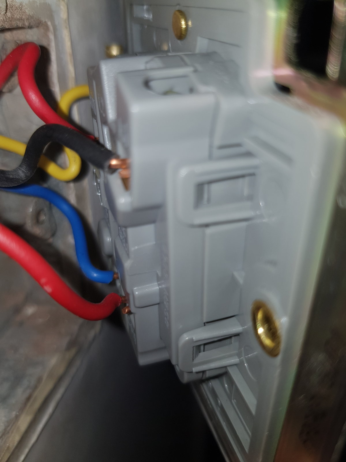

There isn't three switches, its just the downstairs 2 gang switch and then the upstairs intermediate switch. The photo I have just sent is the intermediate switch.
In the intermediate switch the yellow cable goes to the earth point in the back box, I'm going to open the downstairs switch now and send some pictures.

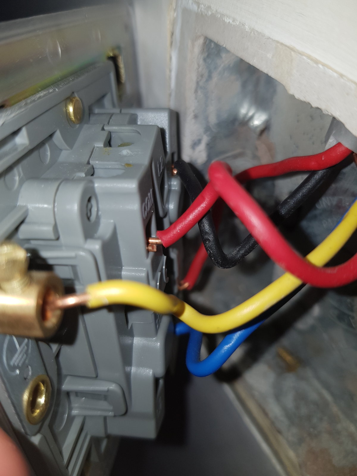

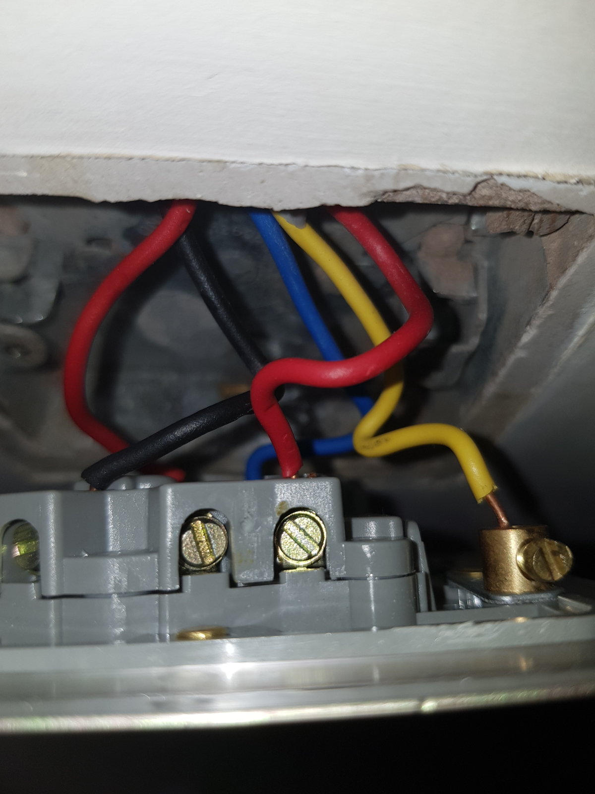

15662394177082275397342689247938.jpg 15662394390596663576909117271225.jpg 15662394589087976131356237463807.jpg This is the downstairs switch.

It hasn't been used AS an earth.
Attaching to the earth terminal is a way of safely terminating unused wires - whether the earth terminal itself is connected to earth is another matter.
Yes I think the yellow has been used as the earth now I look at it. I presume that must be part of the problem?
Maybe, maybe not - is the best answer at the moment. It all looks very confused. If the yellow is an earth, why did they have a second earth wire with sleeving connected to a switch itself, but the switches earth is not connected to the metal back box?
It seems strange though that the yellow on both switches has been put onto the back box upstairs and then the switch earth downstairs don't you think? And then as you say Harry I don't do understand why there is a yellow/green earth that has been connected to the switch upstairs?
