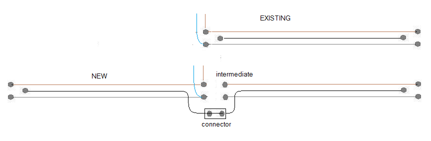

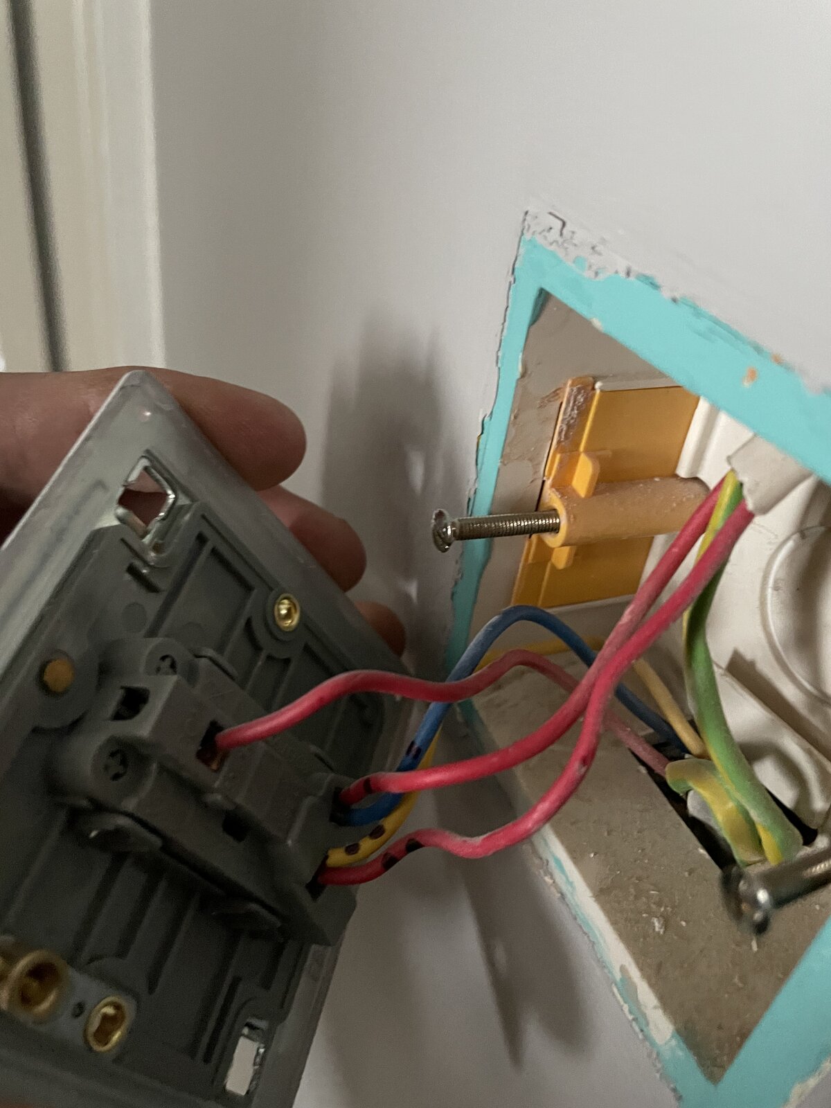

Thanks for all your responses guys, much appreciated, please see the image fir reference ! This is the wiring config at the landing two way switch ! I want to replace this with an intermediate! I have run the 3 core + e over to the point where I want another two way at the other end of upstairs landing ! I am just confused how to terminate the existing cables from the old two way into the new intermediate ! Would apreciate any diagrams please
Many thanks

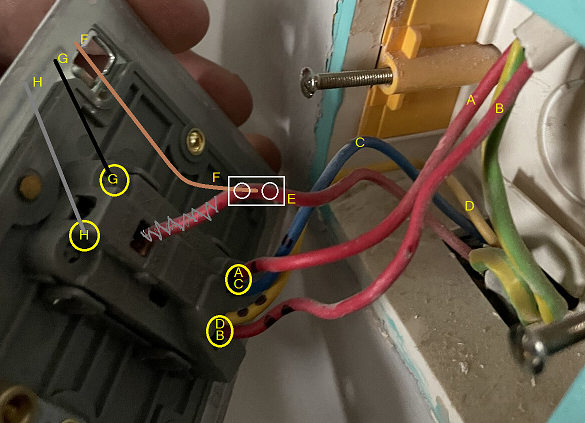

You have a diagram; substitute the colours of your wires.
For understanding.
The yellow circles are the terminals of the new intermediate switch.
Bear in mind that the colours are unimportant; any of the wires could have been used for any of the terminals
(although I would use red and brown for the permanent live wires).
A & B are the switch drop cable; permanent live from and switched live to the light. They are in your case both red
(although they could be red & black or brown and blue).
A & B must go at one end of the intermediate switch; it does not matter which end nor which way round they go.
The only critical thing is that wire E from the COM at the downstairs switch must be connected to wire F which must go to the COM on the new switch.
C, D & E are the wires (strappers) to the existing switch (downstairs). Yours are red, yellow & blue.
As above E is connected to F.
C & D go at one end of the intermediate switch; it does not matter which end (at the moment) or which way round they go.
F, G & H are the wires (strappers) to the new switch (corridor). (I assume) they are brown, black & grey.
As above F is connected to E
G & H go at the other end (than C & D) of the intermediate switch; it does not matter which way round they go.
New switch.
As above F must go to COM
G & H go to the other two terminals; it does not matter which way round they go.
