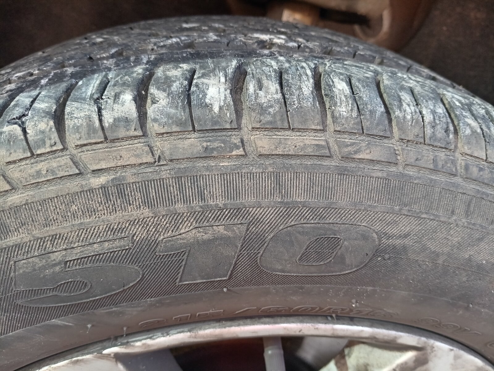

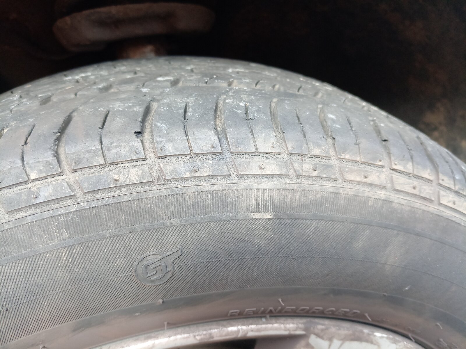

Hey folks,
Hope you are well all having a nice Sunday. I switched my tyres over to the summer ones and I have a pair that are 9 years old so I know they need replacing after one more season.
I noticed some crazing, do you folks think I should get them replaced now? There is plenty of tread left but i read crazing is a sign of deterioration.
Cheers

My two back tyres are worse than that. I should stick on the front as my back tyres last for years. Been advisory on MOT.
To answer. It depends on your mileage and how much motorway driving driving you do. We are mostly local. I'm going to swap before trip to Devon later this year

Not mega miles 6-7k per year but a lot of it is motorway driving.
9 year old tyres are life expired regardless of how they may look.
I read 7-10 years, I know with running two sets of tyres and my mileage I'm likely to reach the age limit before wearing out the tread.
Tyre safe working life, is very dependant on how, and where the vehicle is stored. Kept out of the sun, in a cool garage, they are safe for longer, under the worst conditions, then they only last 4 years. Any which show signs of cracks, or crazing, I would replace straight away. Tread depth, is not a guide to their safety.
I check mine along the sidewall, sidewall to tread, and between the tread, for any crazing or cracks.
Consensus seems to be to get them replaced so I will, thank for your input guys!

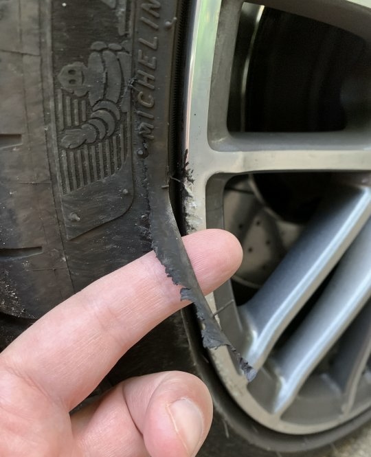

A thin flap of rubber has come off of the side of one of my tyres. Much like when you peel an apple. Not very thick and about 2" long....
I am guess the tyre needs changing?
Only if you can see the cords. It might be the rim protector - some tyres have a raised section on the sidewall near to the rim to prevent the rim from hitting the kerb when parking. If that is split, ripped or missing it’s not a problem. Like this:
Show us a picture of yours.
