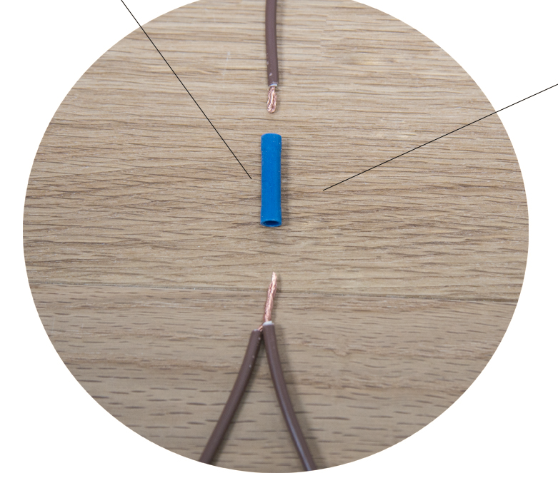

I contacted them and they told me that i need to connect the cables together in parallel and then i would come up with just two cables to connect to the junction box. My issue is that crimping cables and let them under the floor will be a week link for the system to go wrong. My question would be do i need to use some special crimps for this job?

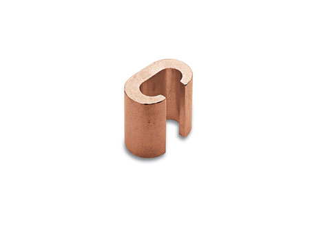

Simple answer no, you should not use a crimp of that type to join two wires into one.
this crimp is the correct type to add wires used a lot with earth wires but it requires a hydraulic crimping tool. The standard crimp would maybe crimp two 1 mm cables one end and a 2.5 mm the other but if the crimp is designed for 2.5 mm you simply can't fit two x 2.5mm into the crimp and if designed for 4 mm using a single 2.5 mm it will not grip it well. One may get away with uninsulated crimps and fit in shrink sleeve but with pre-insulated that is not a method I would ever use.
