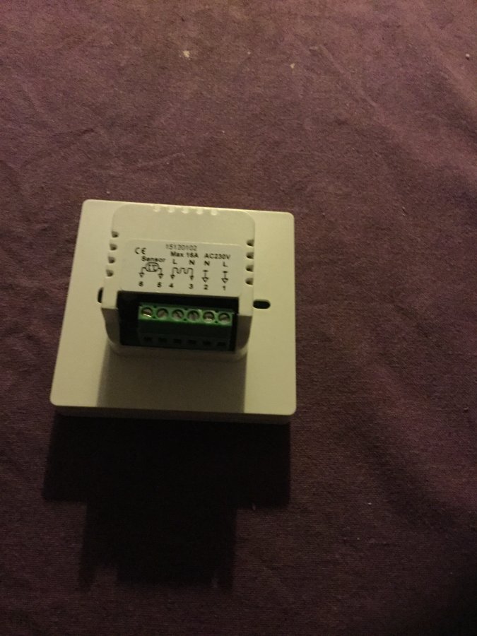

Thanks for advice so far. returning the units is not an option at the moment. the underfloor heating is going to be under wooden laminate floor and in the kitchen so i agree that crimping may not be necessary. i just looked at the junction box and there are 6 connectors; two for the sensor and two L/N connectors. Would it make sense connect the bigest mat to one L/N and join the wires of the two other small mats and connect them to the other L/N connector?
Those numbers don't add up.
When you say junction box do you mean thermostat controller? if so, no you need to connect all the mats to the Load L and N terminals and the mains to the Supply L and N terminals. The floor thermistor to the sensor terminals. Otherwise one set of mats will be on permanently and your floor will get burning hot in that area.

I meant the thermostat.... My mistake
In the picture which connectors are the input and which ones are output to the mats?
I have been Asked to make a resistance test before puting the floor. I assume i need only to check for continuity?
The right hand ones (marked AC230V) are the ones from the supply, the middle two are to L&N to the mats and the left hand two are the sensor.
Just as is already writen in the instructions.
