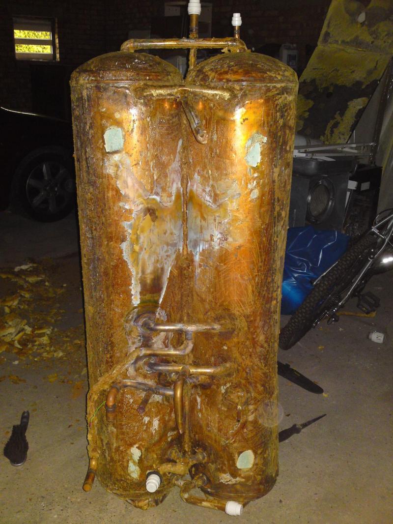

using the term "sludge bucket" to describe all TS shows a distinct lack of knowledge of thermal stores. Its obviously based on the likes of BM2s and BM2000s which indeed were sludge buckets due to their design.
Have a look at the design of a Boilermate BP however, and explain to me where the sludge comes from and where it ends up?
I know nothin after the BMII still miss taking them to the scrappy. ;)
DrDribble was enough to put you off them for life
Yep they was a terrible design for sludge, and the BM2000 was even worse, here's one I stripped earlier :D
But as Dr Drivel points out having the heating off an extra coil eliminates this problem and also means the heating system can be its own seperate system, the boiler the same and the store as well so no systems are connected, if you wanted of course but not completely necessary
