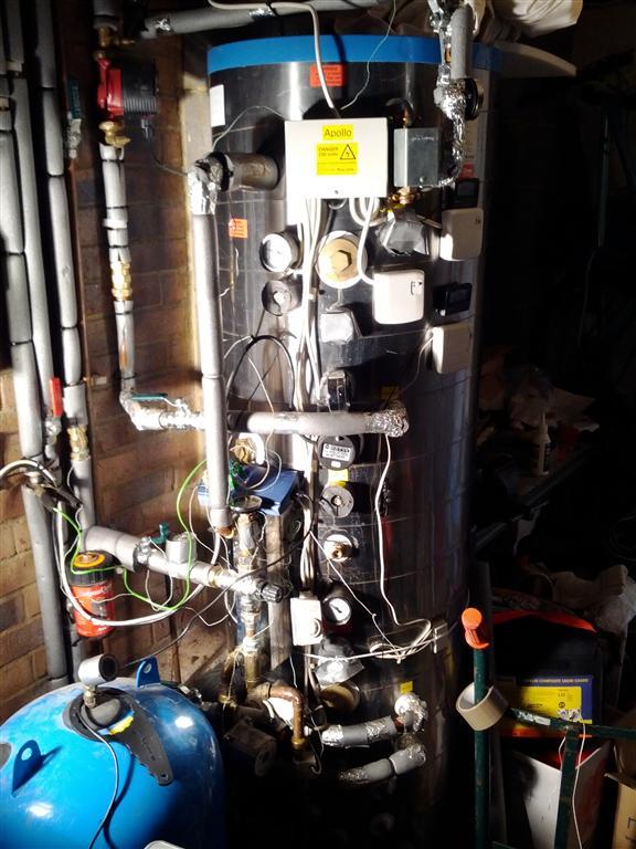

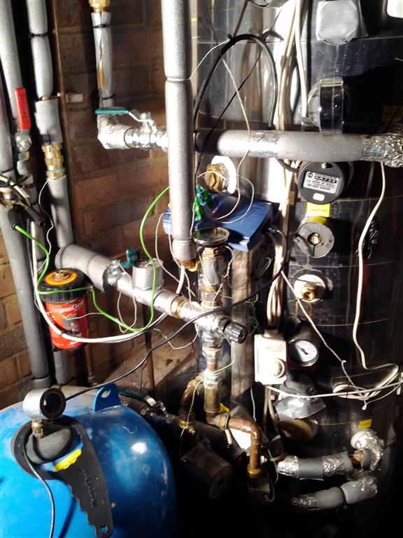

I have a 350 litre Excel store from the recently demised, now Specflue Dedicated pressure systems.
It is unvented due to my choice of boiler. Which was - A Coopra N30C. Which actually thinks it is an N40B, although they don't technically exist. A recent Gas Safe Inspector put it down as a "work in progress". The C boiler was a 2 pipe heat only, the B is a 4 pipe system boiler. Mine does't have the diverter valve but is operating off the cylinder terminals, via a Honeywell EvoHome set up with wireless TRV's and an Alpha pump for heating.
Deeeeeeeep Breath.
6 bar mains pressure, through a (correcting myself form earlier) 100kW Plate and blending valve.
I was looking to utilising the OpenTherm Bridge available for the EvoHome and converting the boiler to a true 4 pipe variant and seeing how well it worked with no separating baffle; but now I can have underfloor heating in my house :( I don't think I'll bother. Thinking of taking it out and converting it to a small twin coil unvented so i can play with other things - NOT for any sludge related issues.
The heating system is/was a dirty microbore system that is actually plumbed with the returns backfeeding through a 15mm section of pipe that was on the cylinder... it was a lash up from when I moved in and we had to take out the old boiler at short notice and didn't have time to rip up floors.

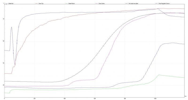

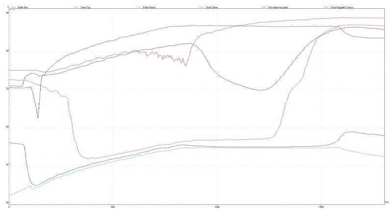

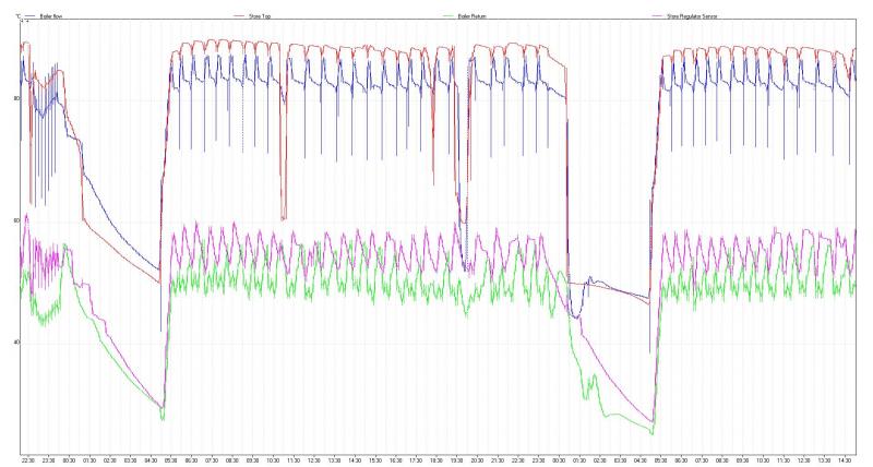

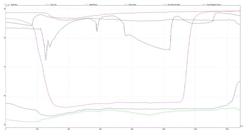

So, the boiler is running in native "heat the cylinder quick" mode which effectively runs the burner flat out until the cylinder sensor reports satisfied. In my case the EvoHome is looking for 52 degrees. This is leaves the bottom third of the cylinder at around 40 degrees, or slight higher - where the heating return feeds back in just under the boiler return connection. The idea was to feed the 4-pipe heating flow in there that would be WC'd; but I would still have to do something clever as the boiler would be expecting it's internal pump (variable speed) to be pushing the rads/UFH. I have spare boards with secondary pump ports - but I think they get powered in Hotwater demand too, which would mean a 2 port valve/added complication ;).
There are a few snaps of my store somewhere in my profile Dicky. It looks a but like Frankenstein's monster at the moment as I have added sensor tappings to the spare ports on the side of the cylinder. In fact there is a little album complete with some charts showing temperature changes in use.
