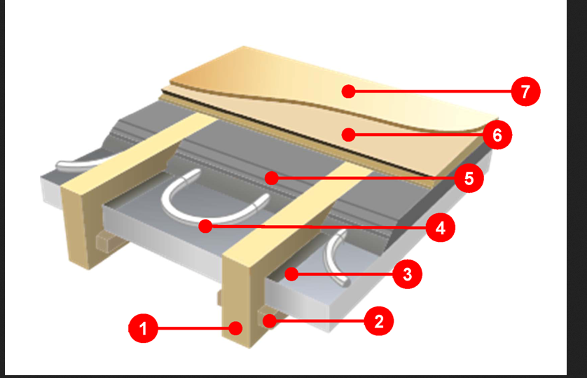

Looking for some advice on my underfloor heating. It was put in over 10 years ago as part of major renovations to the house. Its a relatively small underfloor system that covers 2 downstairs rooms and 1 upstairs room, the rest of the house being heated with radiators. It might have kind of worked with a gas boiler but now we have an air source heat pump, I need it to perform much better. I think the heat is not being dissipated to the fabric of the house effectively because of how the system has been installed.
I think they did as follows: Laid a membrane over existing slab, built a wooden suspended floor, filled the voids with Cellotex sheet, ran the heating pipes, clipping directly to the Cellotex and cutting notches in the joists as necessary for the pipes. Covered with flooring chipboard and then that was covered with either engineered oak or carpet.
I guess I will have to do some investigation to confirm all this but what would people recommend to make this more efficient, to increase thermal mass and conductivity to the floor surface. The underfloor ought to be a very good emitter of heat but I don't think it is so the heat pump has to run at higher flow temperatures than it otherwise might which is inefficient and costly.
Any opinions would be welcome.

The heat pump is running in what they call "Room Temperature Mode" so it sets the flow temp itself based on outside and inside temps. The temperature it sets itself to seems to be between 40 and 50 degrees. Tried pure weather compensation but that just doesn't get the house warm and causes excessive cycling. I think it basically cycling because the underfloor is so crap. There is literally air surrounding the heating pipes under the floor so therefore a high flow temp is needed for any of that heat to reach the surface of the floor.
I accept what you say about starting again... but I'd like to try to make it better doing something like
The pic above is what I think I have.. bar the screed. If there was some screed like material covering the pipes and contacting the boards above.. I think it would be much better.
