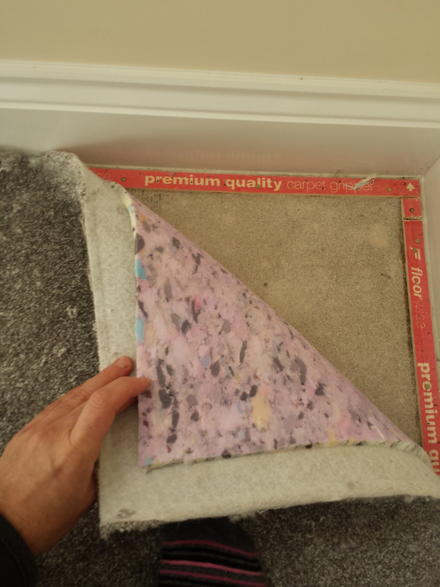

Hello,
Long story short: I am about to complete the purchase of a 3-storey house with underfloor heating (wet type). I'm currently trying to delay completion (due to complete tomorrow - Wednesday) because I suspect the builders (it's a new build) have put in standard underlay, not one suitable for underfloor heating. I pulled up a bit of carpet and took a couple of photos:

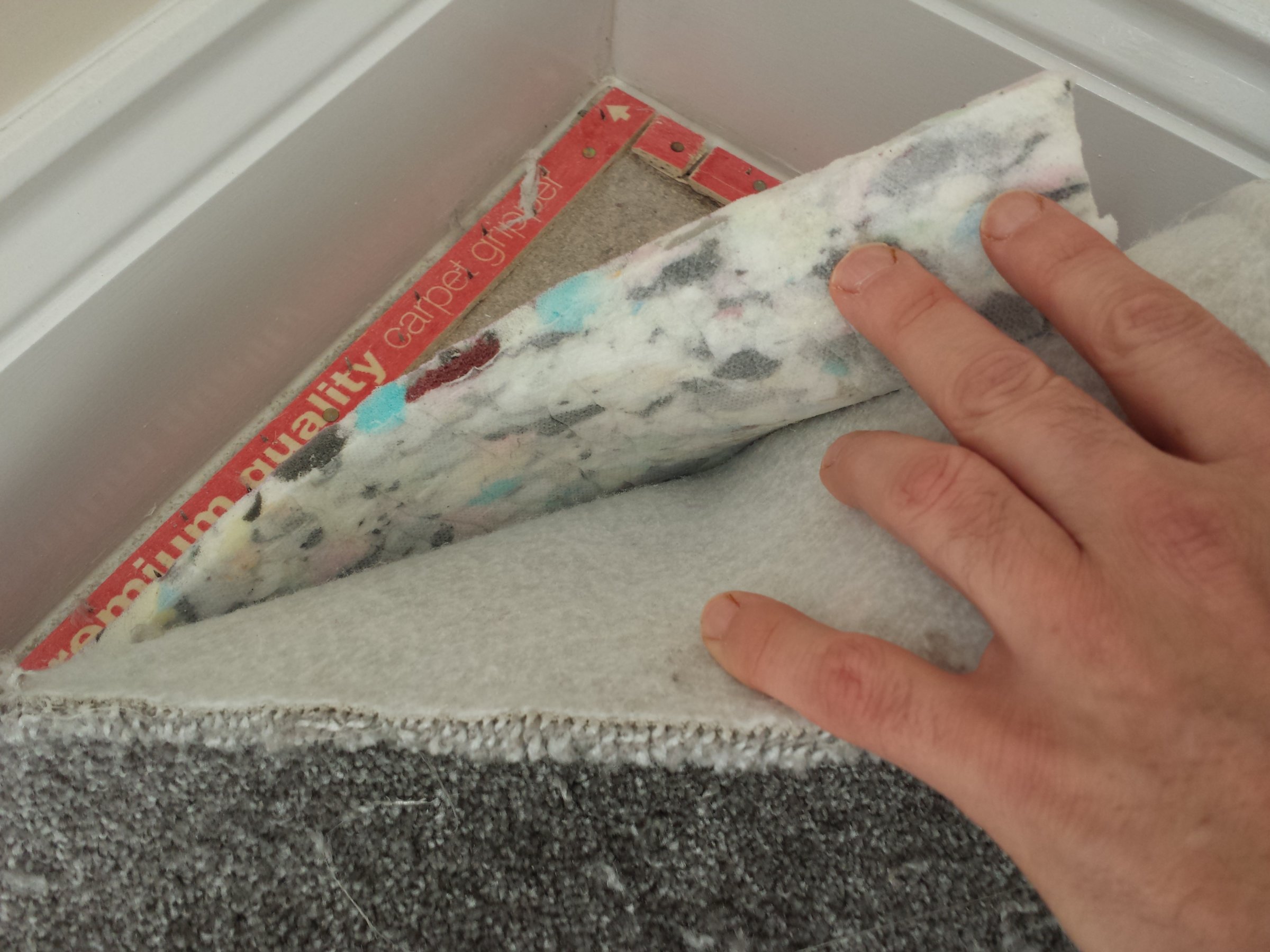

You may also notice that they've used nails, not glue, to secure the gripperrods. Nails in the floor is always a winning combination with heating pipes o_O.
So, I'm interested to hear whether "people in the know" think that this is bog standard underlay, or one suitable for underfloor heating. I'd guess the underlay is about 8mm thick, and does not feel very dense. It's not the rubbery type. The ground floor is cement/concrete, and the first and second floors are chipboard.

Duralay king is good for underfloor heating.
The one you have could be ambience by tredaire which has a high tog so not ideal but can still be used.
The lower the tog the more the heat will travel through.
As for the grippers the nails won’t go through the chipboard to reach a pipe.

Ideally the UFH should have a tog rating that the floorcoverings including underlays should not exceed, maybe worth getting the specs of the UFH and the underlay/carpet they have fitted to see if the system has been over loaded. Also, check the make of the underlay to ascertain if the manufacturer specifies it for UFH use.
If the Underlay and carpet Tog rating is in specs with the floor, and the Underlay is suitable for use over UFH then all should be ok.
We tend to use Duralay Heatflow in most of our carpet over UFH installations.
Another question on this same installation - is it normal to glue the carpet to the underlay? That's what's happened in this case, and it's not something I've seen before. I'm slightly concerned that if I pull up the carpet and underlay, I'll end up with chunks of underlay stuck to the back of the carpet, or, even worse, chunks taken out of the carpet backing.
It’s normal to use some spray adhesive on the perimeter edge of stretch fit installations especially if the carpet was stiff when fitted as this helps the carpet to stay on the gripper in such situations.
It’s unusually to fully stick a secondary back carpet in domestic installations but not unheard of.
