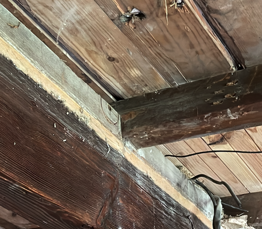

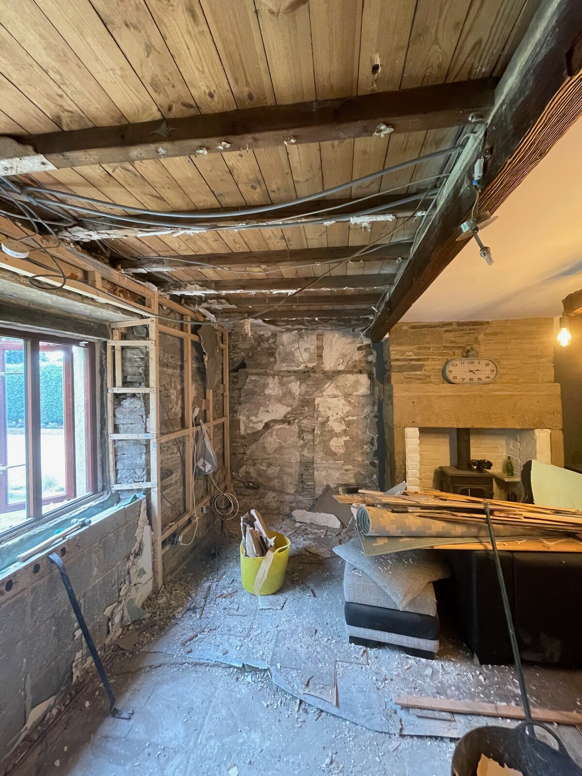

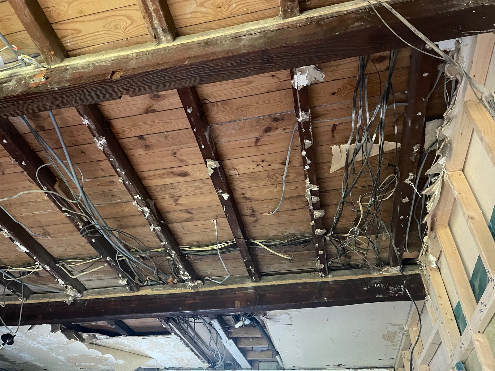

Ive just pulled down the cielining in my front room (3 layers of plaster board) as part of a room renovation. I plan to remove all the old electrical cables, secure the heating pipes etc. its an old house and the floor above has always been a bit bouncy. Looking at the 'joists' used they are laughably small. 3x3" and notched to sit on the beams. Its 200 years old is the house so perhaps thats just how they did it, used what they had.
Can anyone suggest a way to sure up the ceiling without coming too far down? the ceiling is quite low as it is.

I cannot see the entire ceiling, but could you not run 2 more beams horizontally, effectively halving the 3x3 span?
That'd increase the loaf capacity and prevent bounce.
Another good point
It's possible that the bounce is coming from the main beam(s) running acrossways. Consider beefing them up first before doing anything with the 3x3 joists.
Even one extra beam inbetween existing ones would be a massive improvement.

No problems, other than its a bit bouncy. no additional load either. Just while its down and didn't look right, I thought if make it right before replasterboarding. Because the joists are notched to sit on the big beams I thought theres even less holding them. If I sister them as suggested, what size would you use? a normal size joist would sit too low for the ceiling. Would you also include joist hangers?
yes but not equally as in the centre of the room between the two existing beams is a fireplace so couldn't effectible get a beam in without fouling the chimney flue
Here's a look to the other side. and also how the joists are notched.
