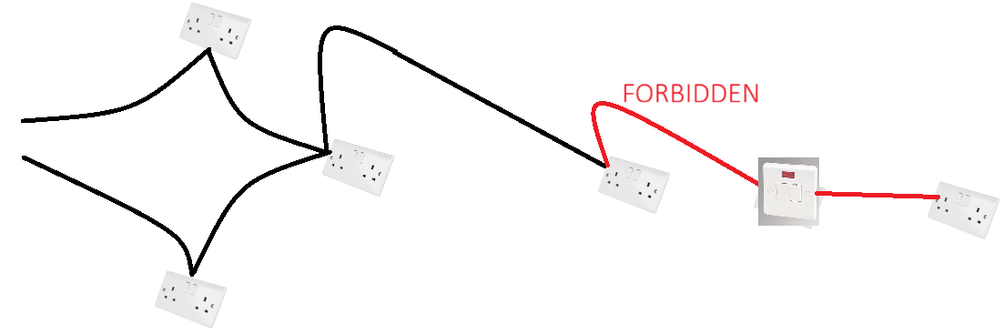

Hi guys can anyone answer a question im intrigued by so on a house hold ring main on 2.5mm twin and earth protected by 32amp breaker you can spur off any part of the ring with only 1x double socket i presume this is because if you added more double sockets then just 1 you could theoretically overload the spur cable which say was 2.5mm would be rated at say 27amp max is it ?
so you could overload it by 6 amps before the breaker blew
however i believe its permitted that you can add a 13amp spur unit from the spurred socket and then run as many sockets as you want from that being protected by the 13amp unit
the bit i dont understand though if say you was maxing out the spurred double sockets with 2x 13amp on each point so pulling 26amp you would be almost at the max of spur cable
but then you could pull a further 6amp with the fused spur before the 32amp breaker went and you would be overloading the orginal 2.5mm spur cable would you not ?

But everything is protected by the ONE 13A fuse in the Fused Connector Unit (the cable is the spur).
No.
Use 4mm cable to to spur it avoids any future problems.
No, because of the 2 x 13 amp plug fuses.
NO

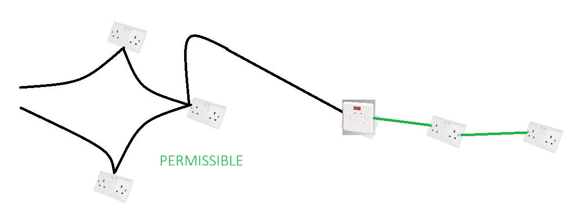

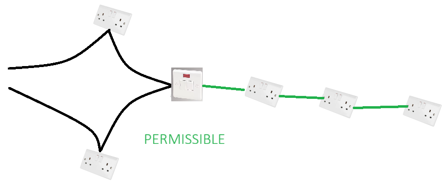

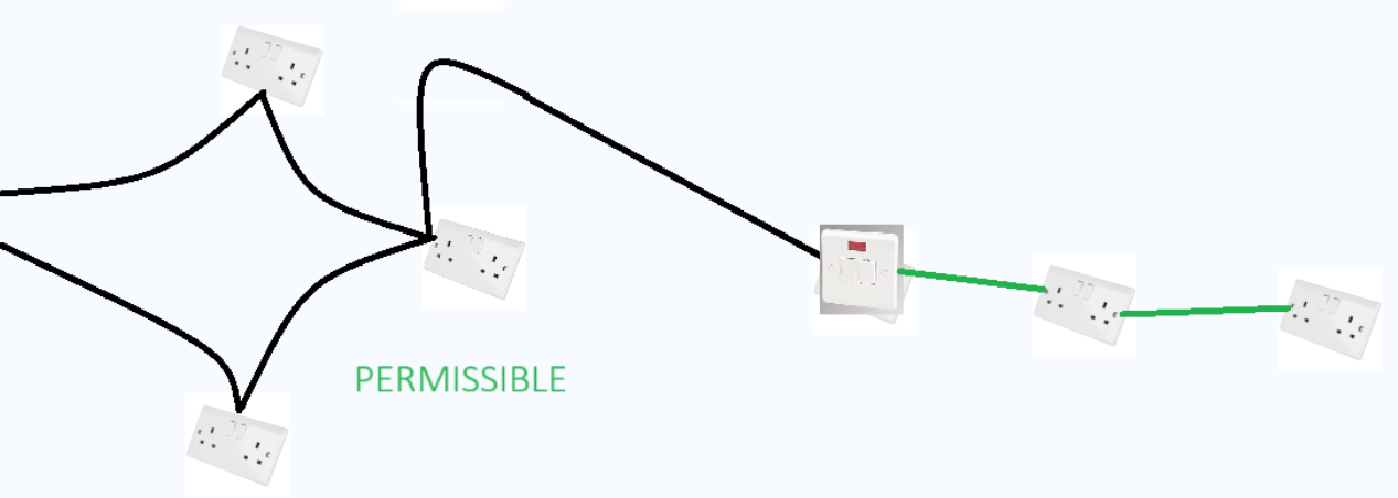

You can add a fused connexion unit (FCU) to the ring, either as part of the ring: after the FCU you can have as many sockets as you wish
OR on an unfused spur as the only item on the spur: after the FCU you can have as many sockets as you wish

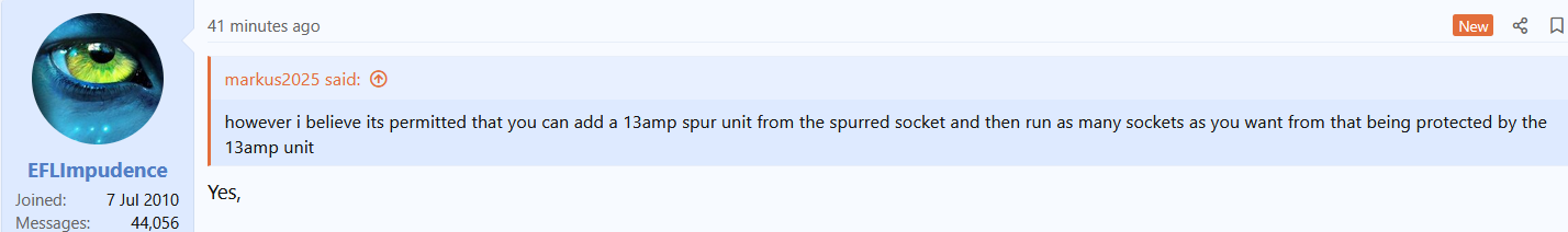

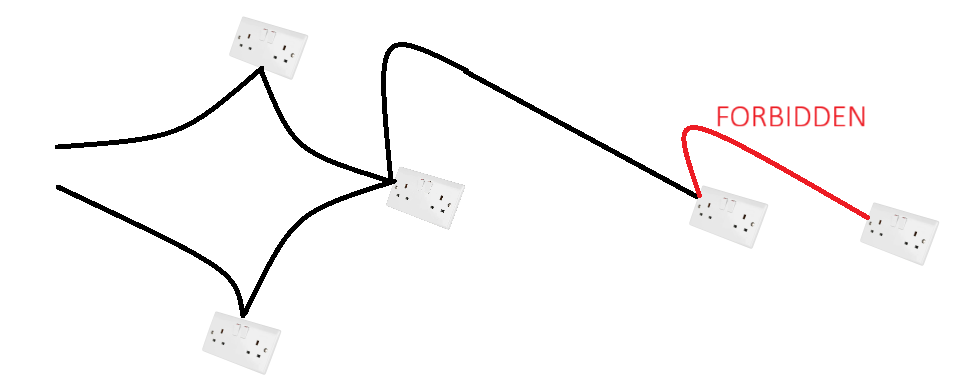

Ow so if a double socket has already been ran on a radial spur in 2.5mm from a ring main circuit you cant then add a fuse spur unit from that socket ?
Depends on how it is installed.
Nope.

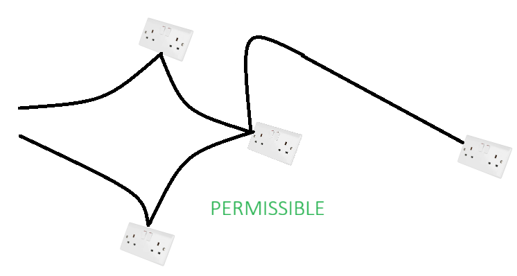

But you wouldn’t be allowed nor be able to, if you’d done the job properly, by only adding one spur off the original socket or from a FCU as the first point, from the ring, then the sockets after that added on.
One socket and full load = 2X13 = 26A
Ideal conditions of T&E 2.5mm clipped direct = 27A
Introduce a FCU = Whether if it's 13A, 6A, 5A or a 3A, the sockets connected to the load side of the FCU will be limited to that. Once the load from the sockets after the FCU exceeds the fuse rating in the FCU, the fuse will blow, cutting the power to all sockets, from the load side of the FCU.

maybe what im saying is being misunderstood so i have 1 double socket coming off a ring on 2.5mm which has 2x 13amp outlets then from that double socket there a fcu capable of taking another 13amp
so does that not mean i could pull 39amps all togeather if there was no 32amp breaker but cause of the breaker i can pull 32amp still 6amps over the 27amp rated cable ?
or am i looking at it wrong and a fixed double gang socket can only take 13amp ? across both its points not 13amp on each point
