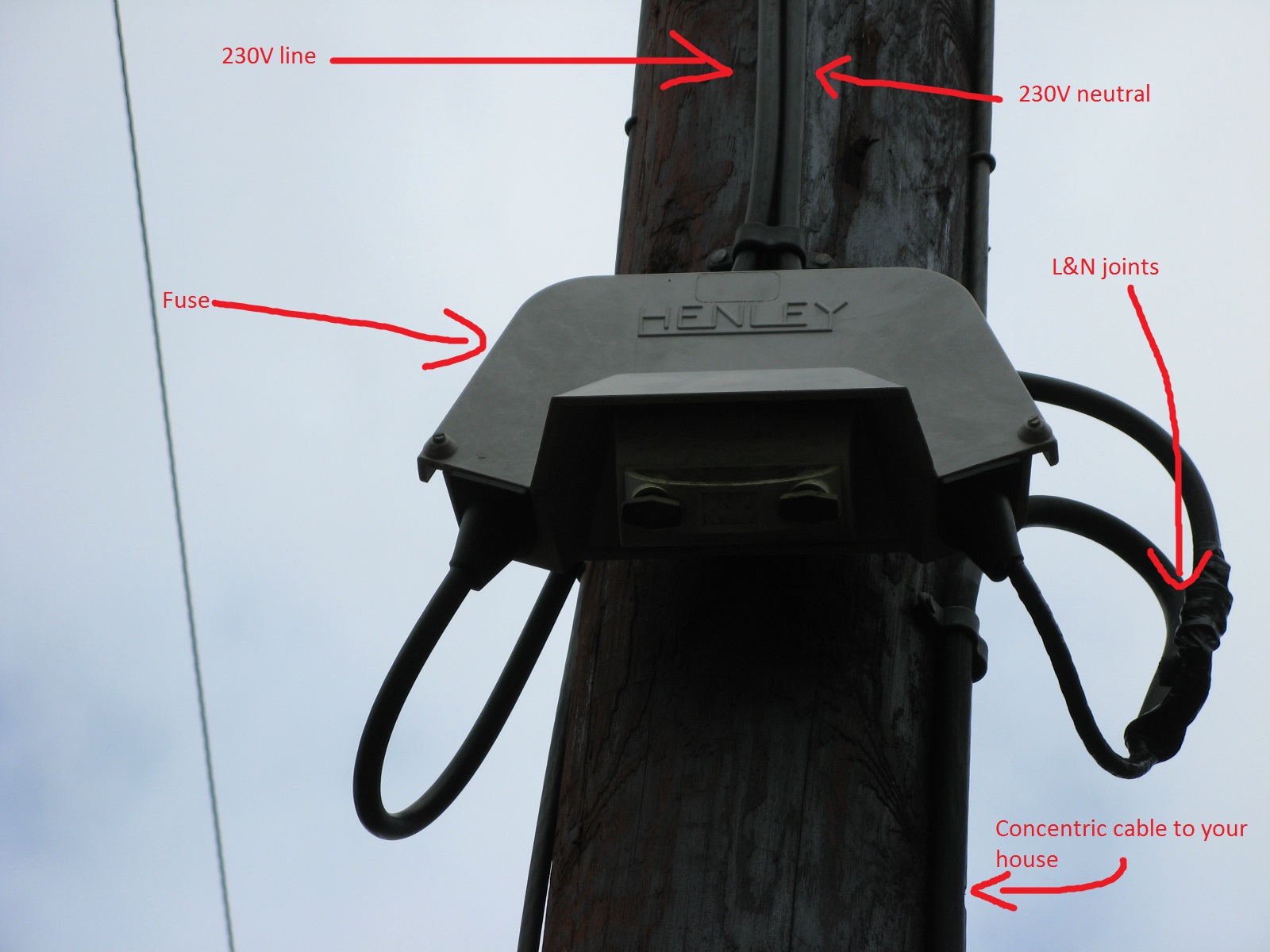

Not much to know really about the supply, on the LV side, the neutral is tied to earth, there'll be a conductor buried in the mass of earth to reference the earth to terra firma, usually another HV earth going to the mass of earth in the opposite direction.
There's a fuse on the pole for the LV side which then feeds the split concentric cable going to your cut-out. The supply is TN-S

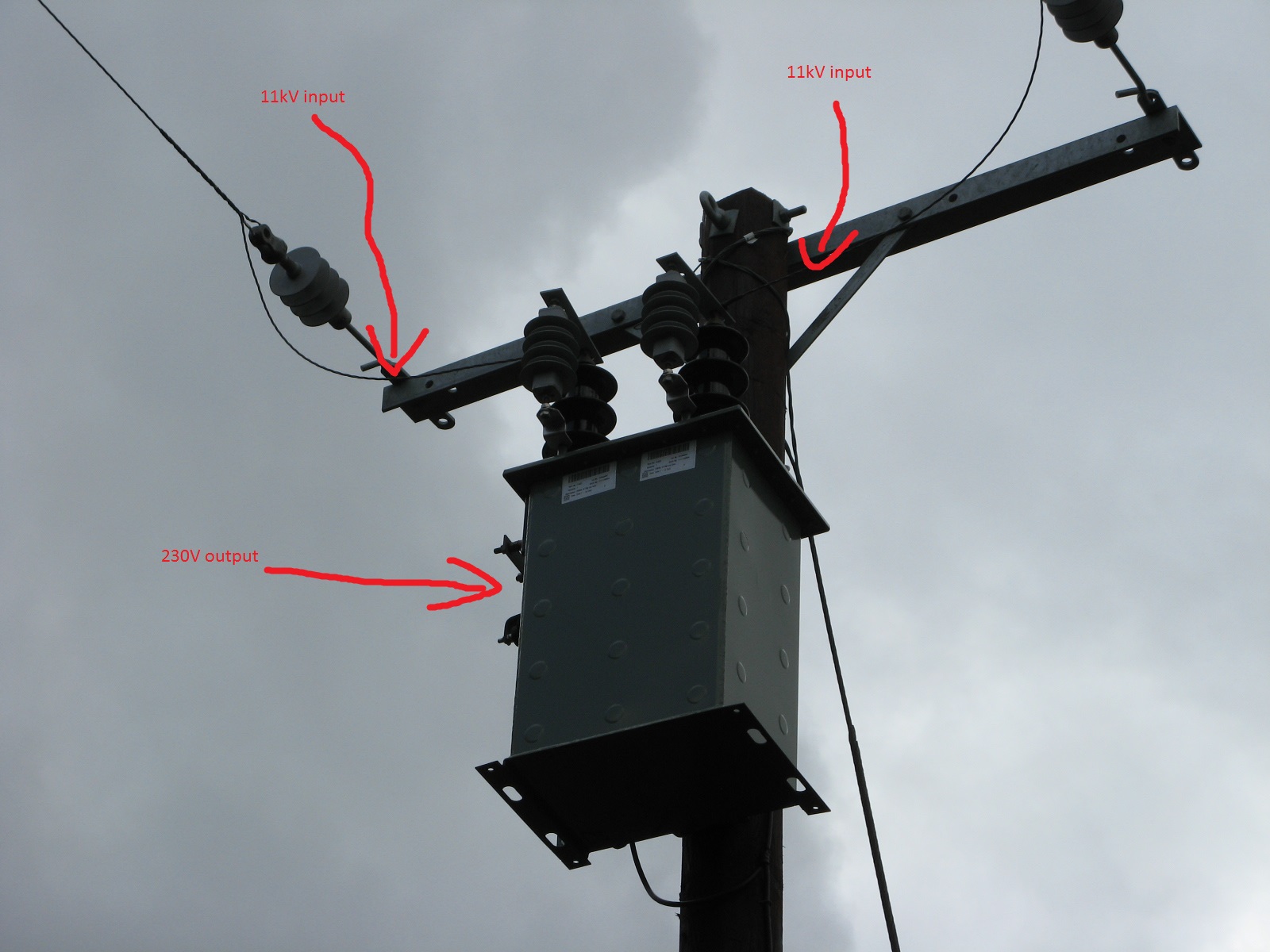

I have a pretty poor understanding of these things, but I will tell you what I know in the hope that someone will come along & correct me if I'm wrong as this stuff interests me too.
The incoming HV supply is 2 phase, or split phase 11kV, this enters the transformer via the two big insulators on the top. The single phase LV 230V exits on the side we cant quite see, the neutral output is tied to earth via one of the wires coming down the pole.
The transformer converts the high voltage to lower voltage via two coils of wire of differing lengths & gauge that are isolated from each other & works by induction.

The LV 230V feeds come down the pole, through a fuse then join to your cable.
Your earth is then joined to the suppliers neutral.
I'd say you've got most of it right :-) just a couple of bits where terminology is probably not quite right.
I's say that thats 1 phase, 2 wire. (But it is two phase conductors of the system [so you can see why it might seem sensible to call it two phase] but you can only access one phase via them - Its distributed as delta at HV).
I'd also say its not split phase, that would have the same single phase of HV into the transformer, but would utilise a centre tapped transformer to give 230-0-230, whereas the transformer only appears to have a single secondary winding, or at the very least, only one that is in use
