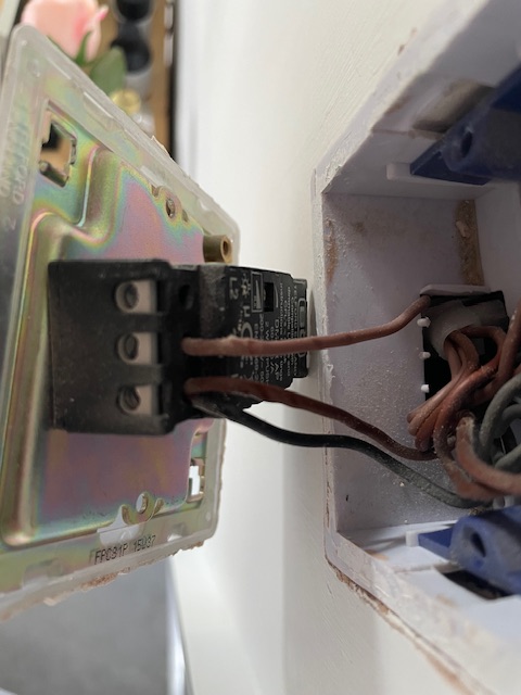

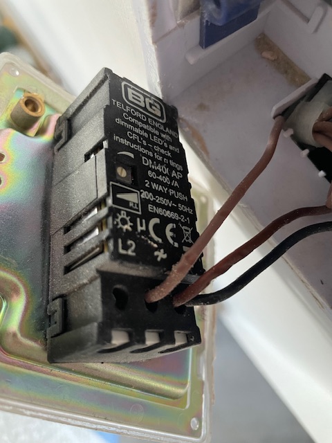

I’m trying to replace my first dimmer light switch and have popped open the old one to see how it’s wired. The strange thing is the colours don’t seem to match what any UK wiring colour guides I can find state they should be.
It looks to me like I have a light brown wire going into the squiggly line with the arrow connector and a darker brown wire and black wire going into L1.
Is this colouring normal (brown, brown and black)? Seems like a bad idea to have two similarly coloured wires in anything involving electricity but that’s just my layman opinion.
Assuming this is expected, is it correct to have two wires going to L1? If this is wrong I’d like to correct it when installing the new switch.
(Attached photos for clarity)

If the existing one works, it's correct.
New one connects in the same way.
If it has a metal plate, an earth wire is required to the terminal on the metal plate. Existing switch is missing that.

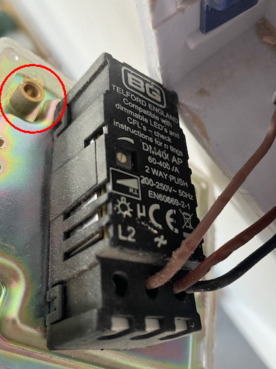

I’m really confused now. I don’t see an earth terminal on my old switch and there’s only those three wires (light brown, dark brown and black).

Are both your photos of the old switch. If so, they do show an earth terminal ...

What we can see certainly looks like plastic, but that earth terminal makes me wonder what's on the other side. It could be there simply as a 'parking place for 'un-needed' earth wires )on an 'all plastic' switch), but that's not something I've commonly seen in switches.

Judging by the first pic it looks like a mess of wiring has been shoved in behind the box, obviously the wrong way to do it. That is probably where the CPCs will be. Needs an electrician to sort it out really, dealing with busy light switch wiring can be difficult without experience.

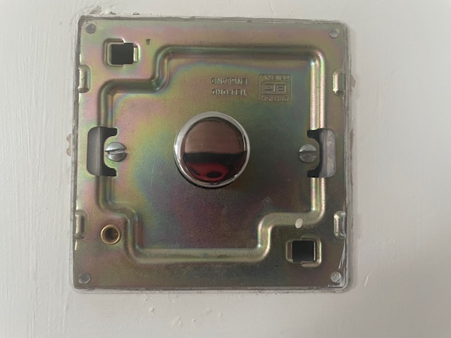

That switch is a low profile ,clip on metal front. The switch plate is metal with a plastic edging,and clearly has an earth terminal as shown by Johnw2 above.
It 100% must be earthed.

Okay, so that earth connector (bottom left on attached photo) seems to go nowhere (or is the fact the clip on metal front touches the switch plate enough to do the earthing?).
Does this mean the existing switch is wired dangerously then?
