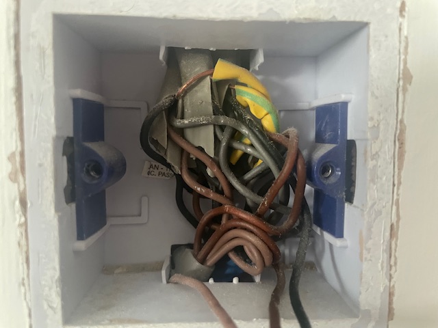

Switch off, pull all loose coonnector blcoks back into the box, and fit a flylead from the earths to the switch, you'll have to dress the connector blocks to the side to allow the body of the switch back, quite likely

Okay, here’s what the backbox looks like…

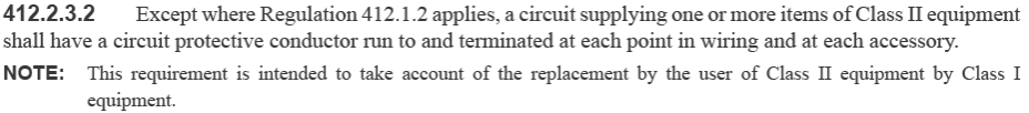

As I wrote, the reg (as quoted by EFLI in post #19) requires only that a CPC ('earth#) be 'run to each point and accessory) - hence,if more than one cables go to an accessory and one has an 'earth', that reg theoretically means that any other cables do not have to have an earth. In any event, there is no immediate safety issue in having no earth 'available' at an accessory/item that does not need one - as I said before (and as the note to the reg says) the requirement exists in case the accessory/item is subsequently changed to one which does require an earth.
As for what you suggest, it would make sense, but I cannot off the top of my head think of any reg which requires every cable to have a CPC ('earth'). Indeed, there are still plenty of ancient installations around whose lighting circuit wiring does not have a CPC and, although that means that "Class I"/metal accessories and fittings can't be used, I don'gt recall people citing a regulation that would be violated by the ('earthless') cable itself.
In fact, the most common situation probably is that the cable does have a CPC, but that since the accessory (e.g. switch) does not require it, it has been 'cut short' at the end, and is therefore not immediately 'available' at the accessory.

I agree that its a bit contrived,but one has to wonder why the regs 'merely' require that a CPC be run 'to each poiint and accessory', rather than simply requiring that every cable must have a CPC.
I don't think it's too difficult to think of practical situations in which this issue could arise, particular in relation to old CPC-less lighting circuits that have been partially modified. For example, if there are multi-gang light switches, at least one gang of which is '2-way', then if the accessories are 'receiving a CPC' from one of the other cables, I think that the reg can be taken to mean that the cable connecting a pair of two-way switches theoretically doesn't have to have a CPC.
