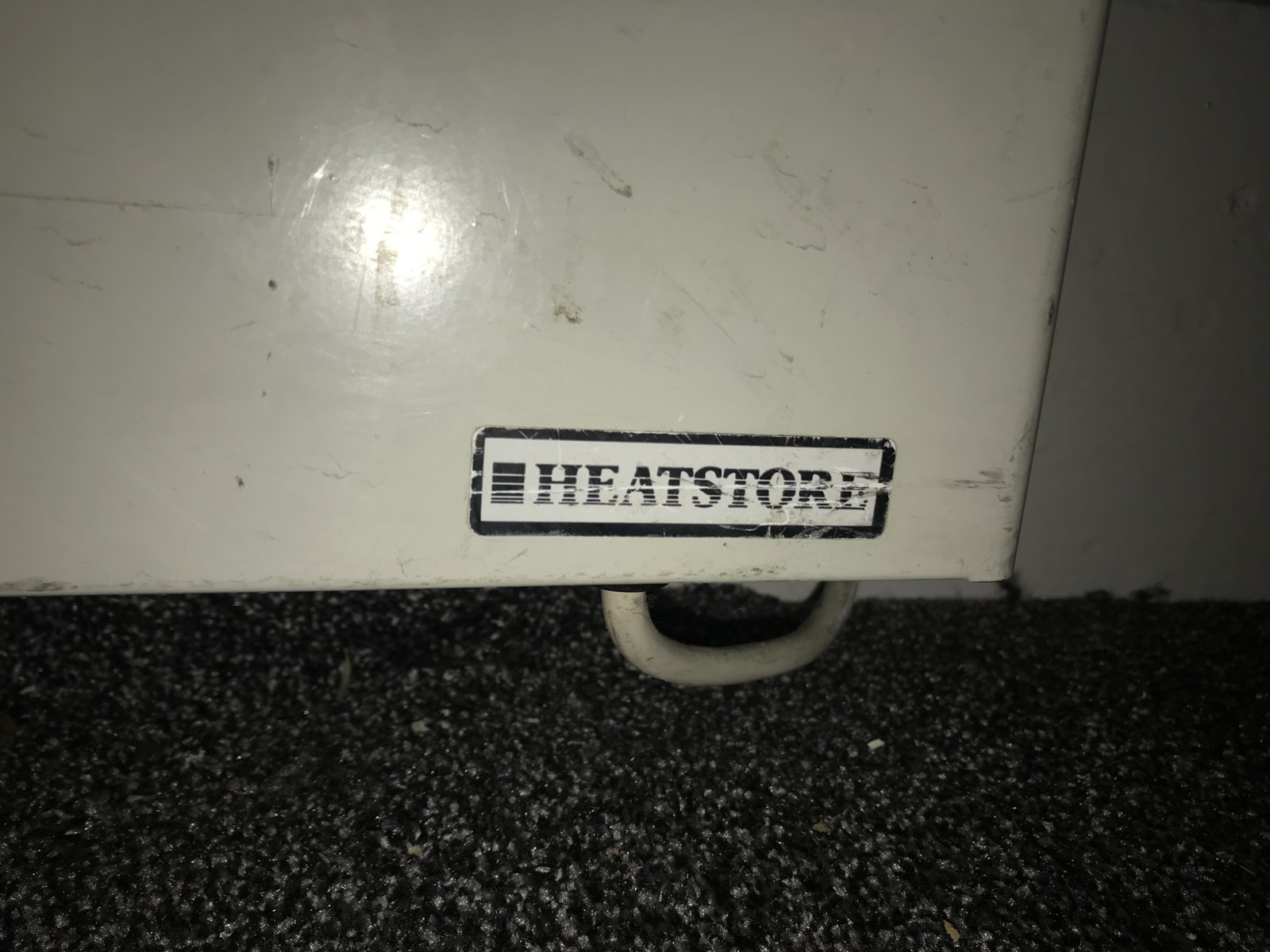

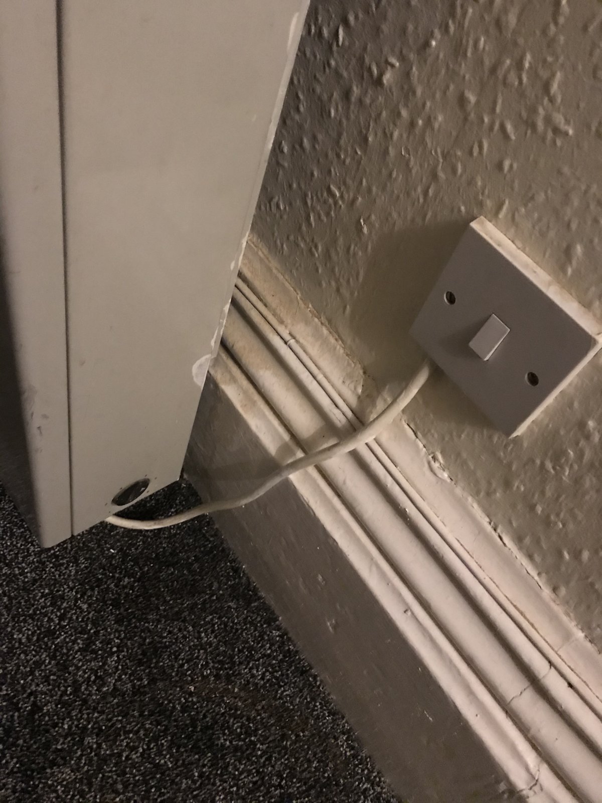

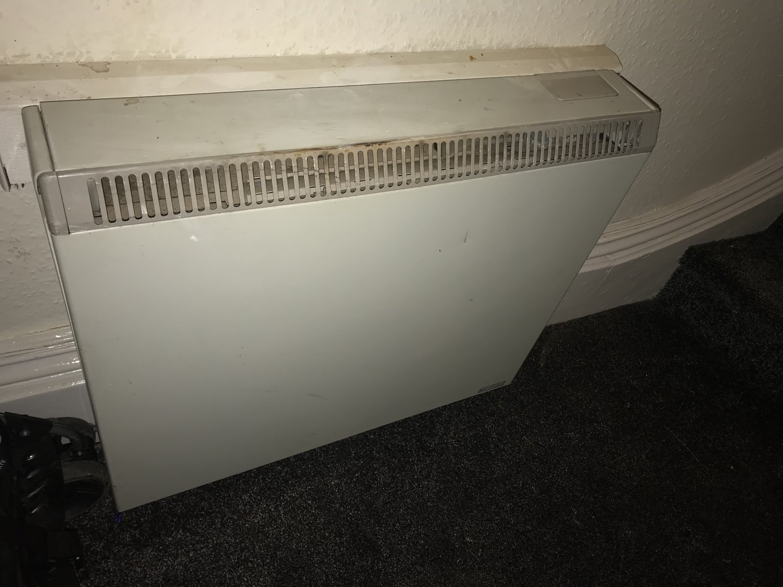

I have a wall hung heater which has a switch for on/off operation. I don’t have the size/ratings of this to hand but was wondering if there is an obvious answer to my question.
I would like to replace this with a FCU (for added protection) and was wondering if 13amp would suffice?
I appreciate that more info may be required but didn’t know if the existing switch provided the necessary info.
Thanks in advance.

Storage heater. I don’t know about the breaker but can check when I get home shortly
Storage heaters would usually be on individual radial circuits. So each heater has its own circuit breaker . Heater being hard wired into an isolation switch close to it. If yours is wired as above you do not need to introduce a FCU.
It sounds like it may be a 20amp switch, usually connected to its own circuit.

Thanks for the info guys. Appreciate that I am clutching at straws but do these pictures verify the fuse rating I would require for an FCU? Or should I not be using an FCU?

Typically you don't use an FCU, they are rated at 13amp switch, and turn to toast.
The 20amp double pole switch that you appear to have is normal, this should be on a 16amp circuit usually.
Is there not such a thing as a DP Fused 20Amp switch? Would this add any more protection?
