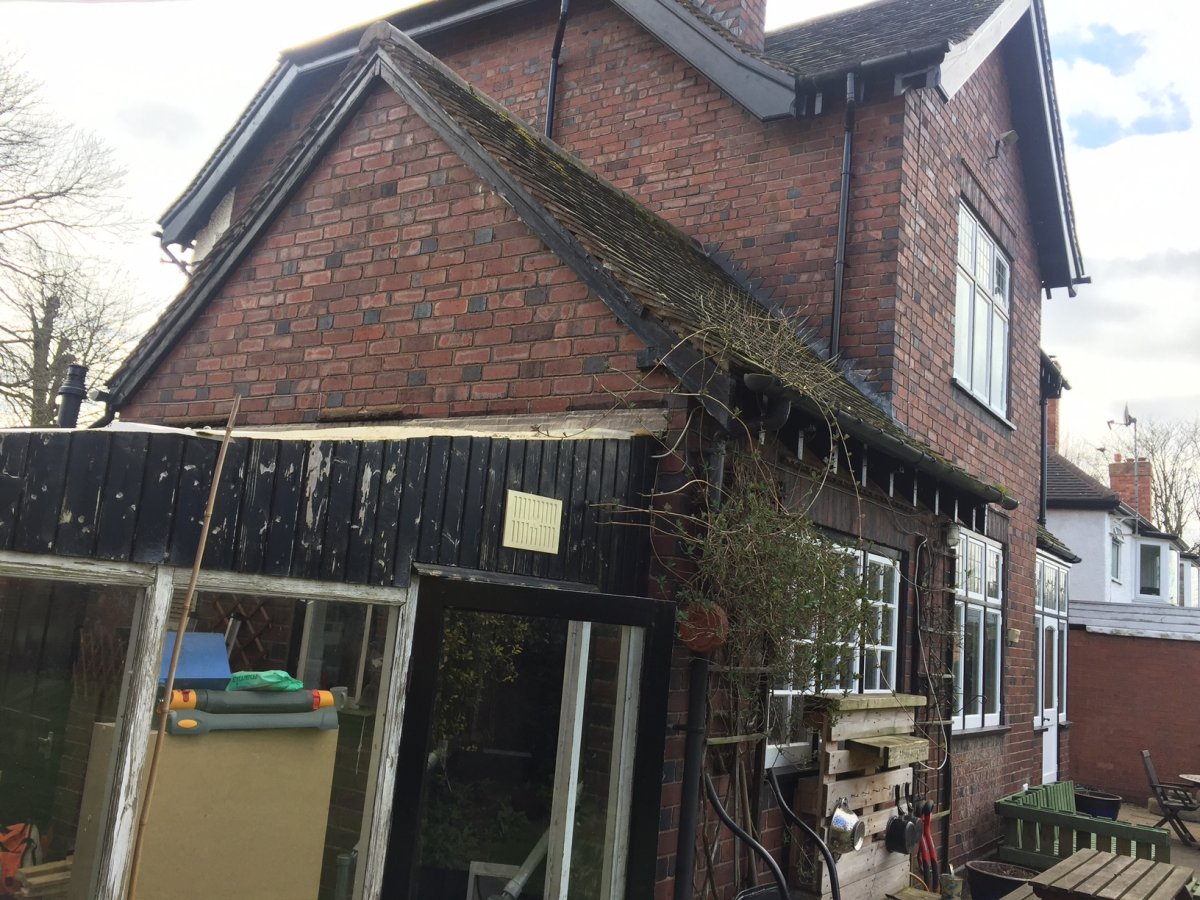

Universal beam or easier way?
21 Oct 2014
1,619
205
West Midlands
I'm going to be knocking out my kitchen wall to incorporate the current kitchen into the soon to be extension. The current kitchen is single storey and I was wondering if there are other options other than putting in a UB to support the gable end once the wall is removed. The extension will be single storey flat roofed with a monopitched tiled roof to match the existing and will replace the shoddy lean to.
Noseall - That had crossed my mind, but the brickwork is holding the ridge beam - isn't it? Or does the roof structure support that? However, I'd quite like to keep the brick.
Woody - What sort of lintel? Concrete? How big? I suppose there is not a huge amount of weight in the gable end..... building wise....
Concrete or steel. Depends on how fit you feel. Steel normally though.
