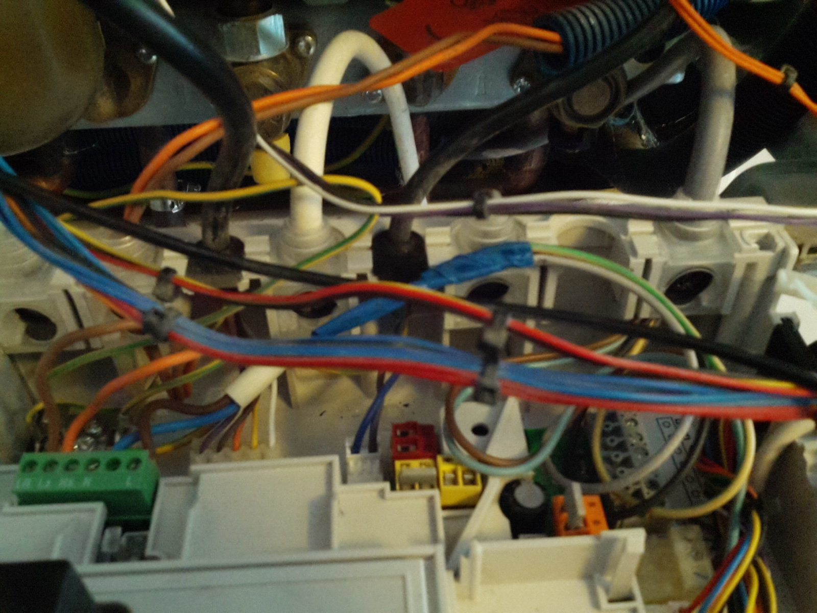

and in boiler

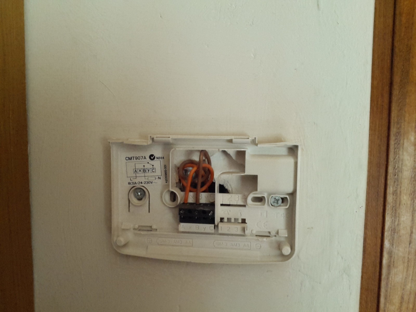

Looking at the pictures I've a few idiot questions
On the sticky label on the thermostat back on wall its shows C3, is this the function being carried out by the controller to make a circuit, either time for boiler to be on and or temperature selected.
The cable colours are from the controller to the boiler are they the right way round, does it make a difference?

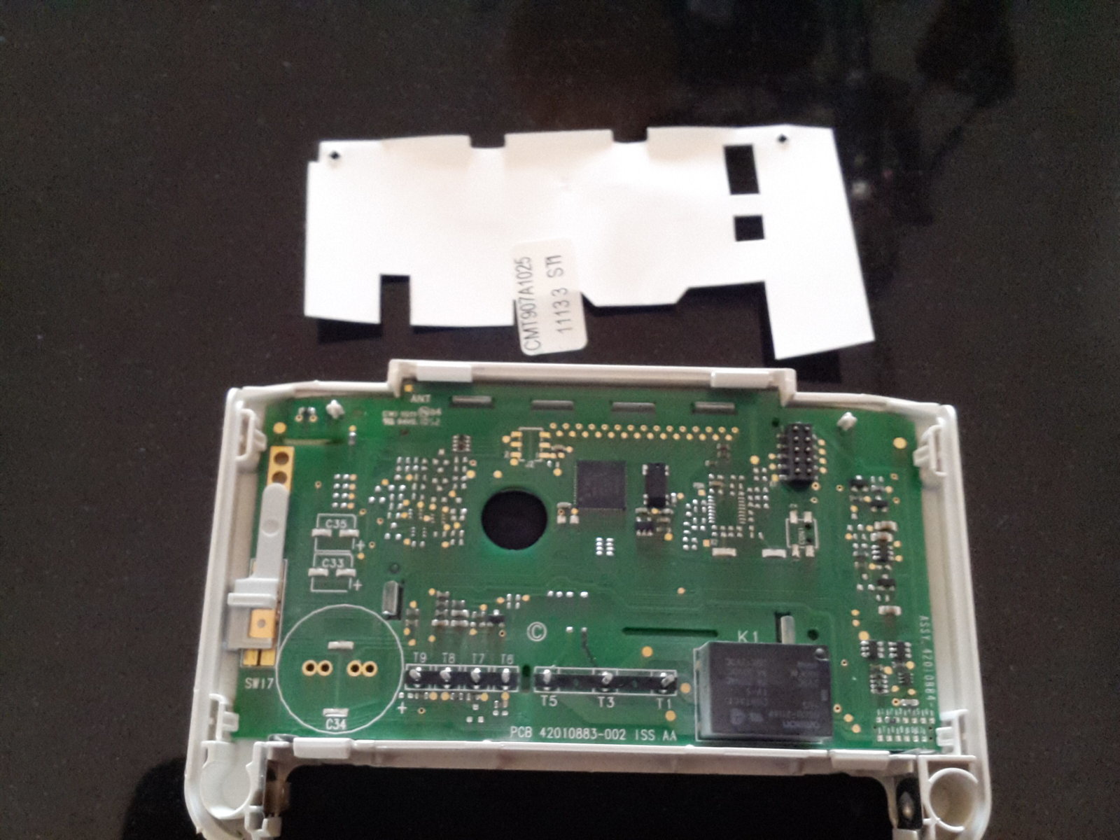

On the controller pcb theres a black line leading off from one of the terminals does that indicate burnt out or never had the copper bit on the pcb in the first place. If burnt out could that be the result of the wiring being incorrect

Hi1,
1) I always see the Sticker in the thermostat as showing the circuit when when the thermostat/Timer is OFF (ie at correct temp)
So A and B are not connected when thermostat/Timer is OFF and A and B are joined together when their is a call for heat
So that looks correct.
2) I do not know if you have correct polarity in the Brown and Orange cable, but I feel that it should not matter in your case as this thermostat/Timer uses batteries to power it this is acting as a simple switch.
But if you are capable, you could test with a Multimeter.
3) The black track coming from T3 is strange, but I think that is simply going to a test pad so not important.
