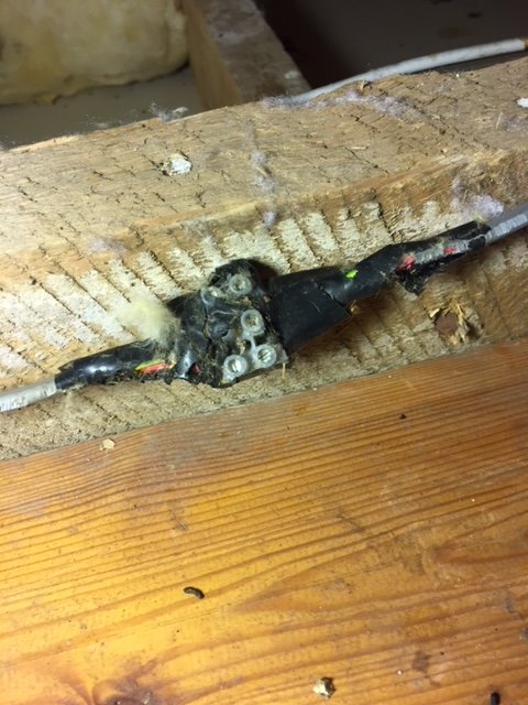

2 months ago several lights in our hall way, porch and a socket stopped working. Very busy at the time so called an electrician out. Turned up and spent 3 hours in our loft and around the house fault finding. Phoned me (wife was at home not me) and said that the problem was with a single circuit (the socket was wired into the lighting circuit! - warning label now applied). He couldn’t find a fault but had narrowed the problem down to an “inaccessible” area and advised we would need the circuit rewiring to cure the problem. A quote was promised.
Fast forward seven weeks and I haven’t heard anything. An invoice for the fault finding work then arrives, three hours total £120. Quite reasonable but I email back and say great but the problem isn’t fixed please advise. His boss emails back and re-iterates the above:
"A quotation should have been received by you along with the invoice to rewire the one section that he could not access but where he had isolated the fault to”.
Anyway, last night with some time to kill I decide to venture into the loft. I spend about half an hour chasing wires underneath the loft insulation and found that a mouse has chewed through a single run of twin and earth running between two junction boxes and which was feeding the offending lights etc. Exposed copper core, a real state (see pictures)! I removed this wire, replaced with new. Re-wired the junction boxes and hey-presto the lights and everything works.

"The reasoning he advised to you to rewire the lighting is as he could see there was extensive rodent damage in areas and examples of poor installation, because of this and after testing the insulation resistance of the cable from motile point, he found this would be the most satisfactory and safe option for your selves.”
I don’t think the guy noticed the rodent damage at all. If he did why didn’t he simply repair it? And more importantly why did he leave it in such a dangerous state which clearly is a fire hazard?

By the way, if that is how it always is (with no enclosure, and maybe no nearby cable clips), that exposed connector block would not be acceptable (or safe) even in the absence of rodent damage.

I’m actually going to terminate and blank off the socket in case someone tries to put a vacuum cleaner on there. I’ve replaced the dodgy connector terminal with an uninterrupted run of twin&earth terminating in a nice new wago box.

Just a point ....how do you know the rodents didn't do further damage since the visit 2 months ago ?
Well I don’t but repairing their damage has cured the original problem so one must conclude that said damage was present from the start.
