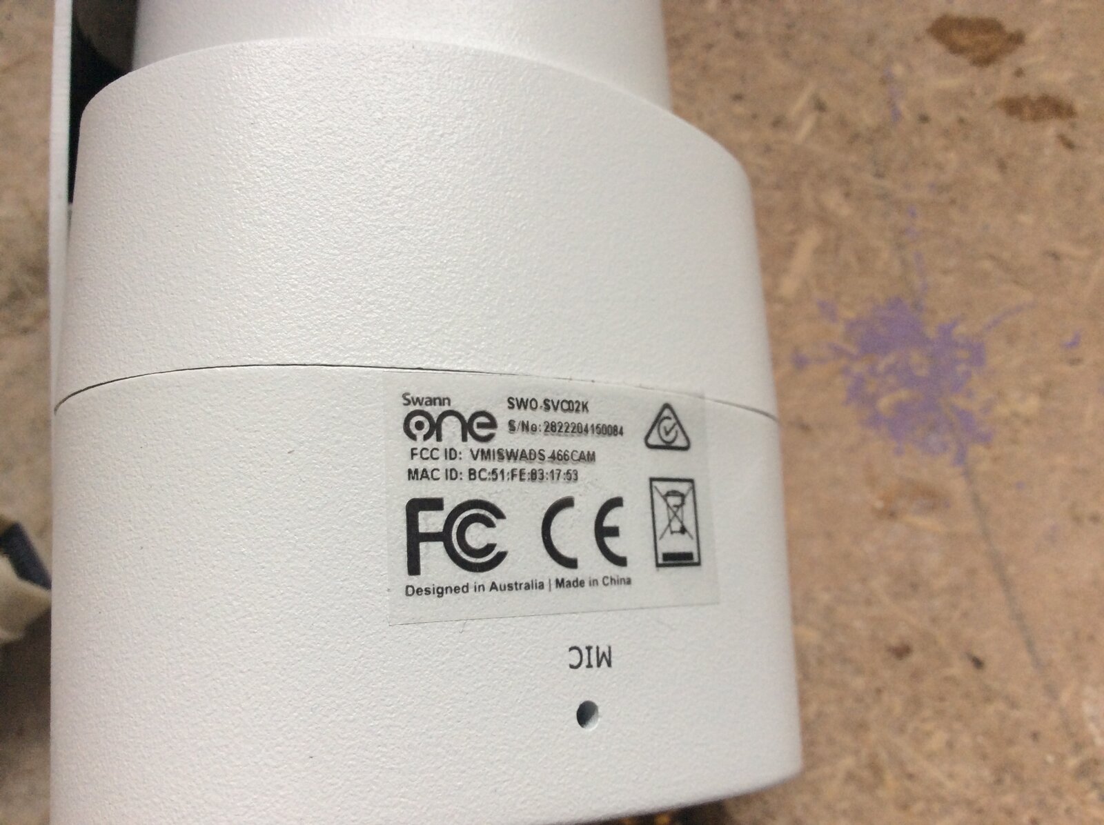

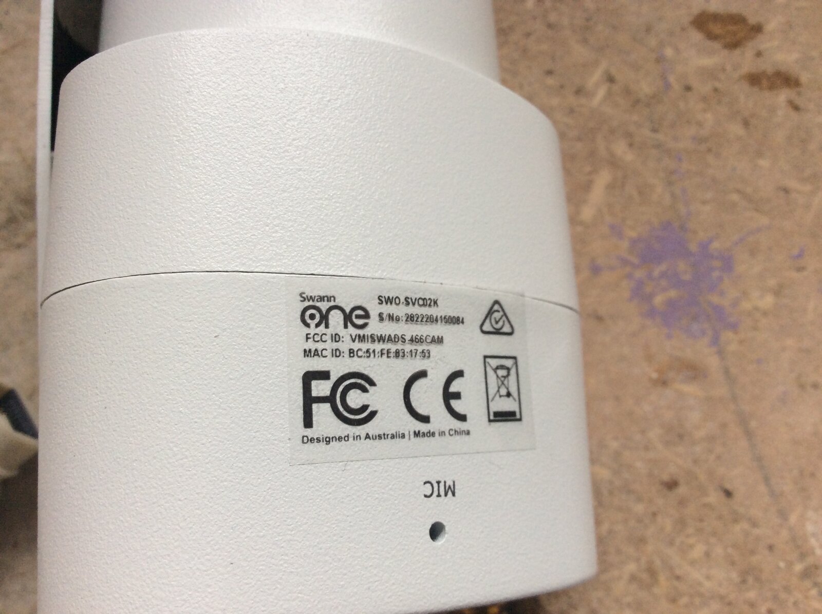

Hi, I have a new Swann soundview camera I was hoping to set up on nesting birds but is now unsupported and wondered if anyone knew how I may get it connected please. I contacted Swann who said it was out of time for support.
Mod. SWO SVC02K

I bought it new in the box from a boot sale. I connected to the power supply and router and entered the mac address from the camera as per the instructions to activate the wifi but the app couldn't find the camera , probably because no longer supported?

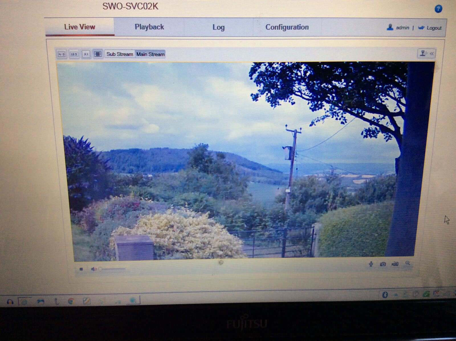

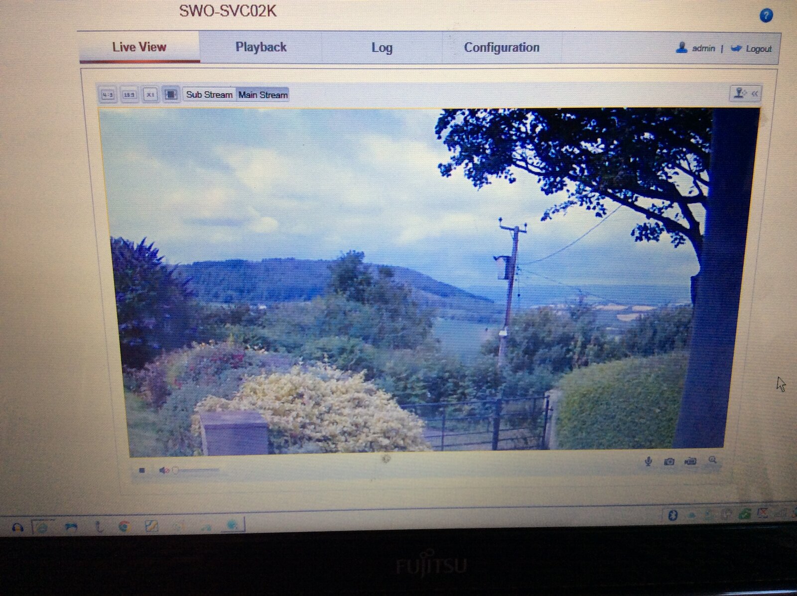

I view my ANPR camera through a laptop using SADP tool which I haven't done since I bought the new camera and when I launched it, it picked up the new camera.
After a few tries at user name and pw admin and 12345 was successful so now have a working camera . Just have to see if I can get pictures on my phone rather than on the laptop.

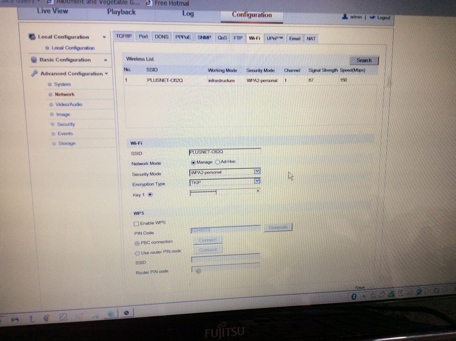

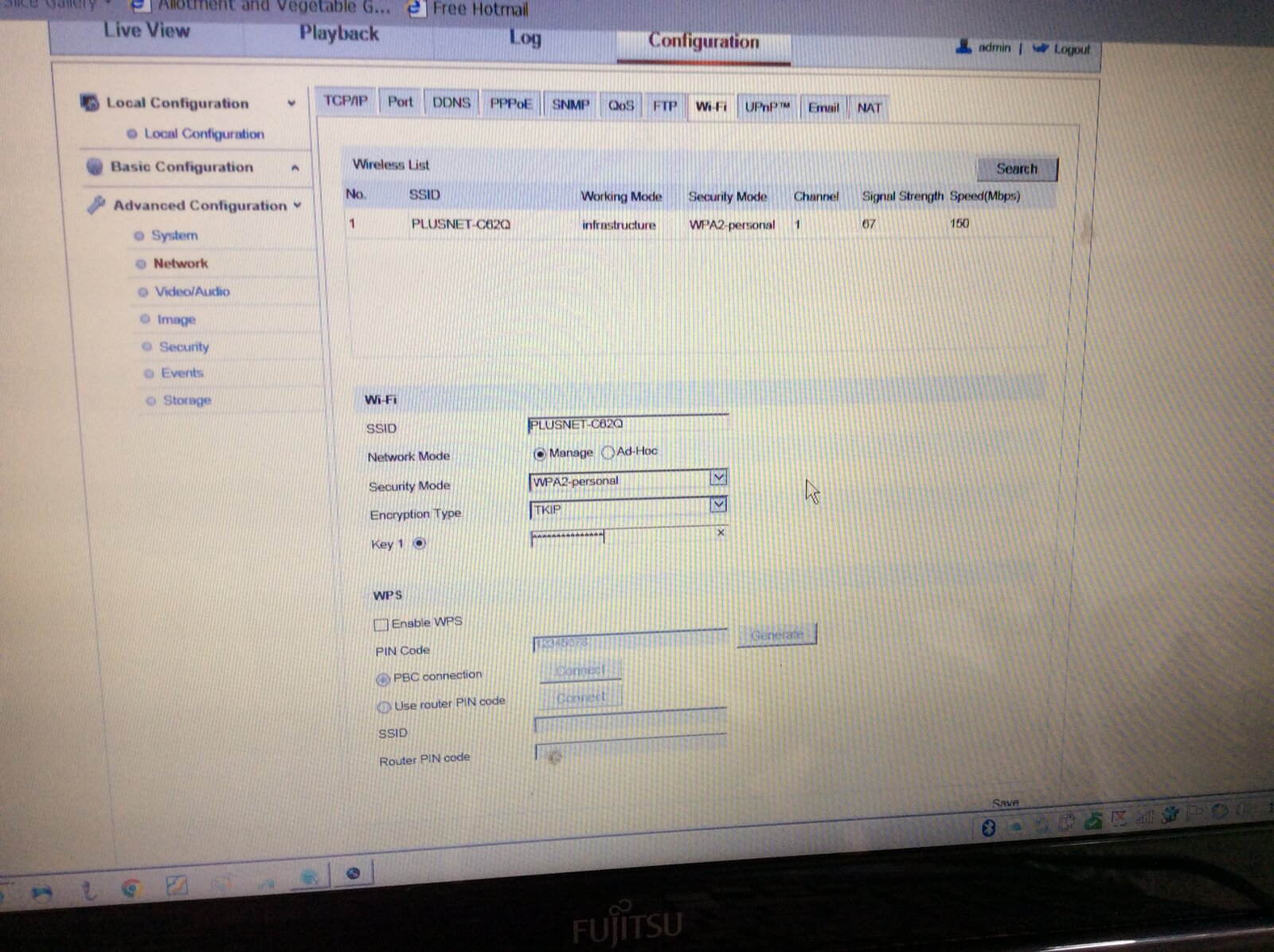

Not sure why it would show hard wired and not wireless, you check ip address is correct?
After a bit of fiddling in the settings shown by SADP Tool I found and configured WiFi so now its working as it should.
