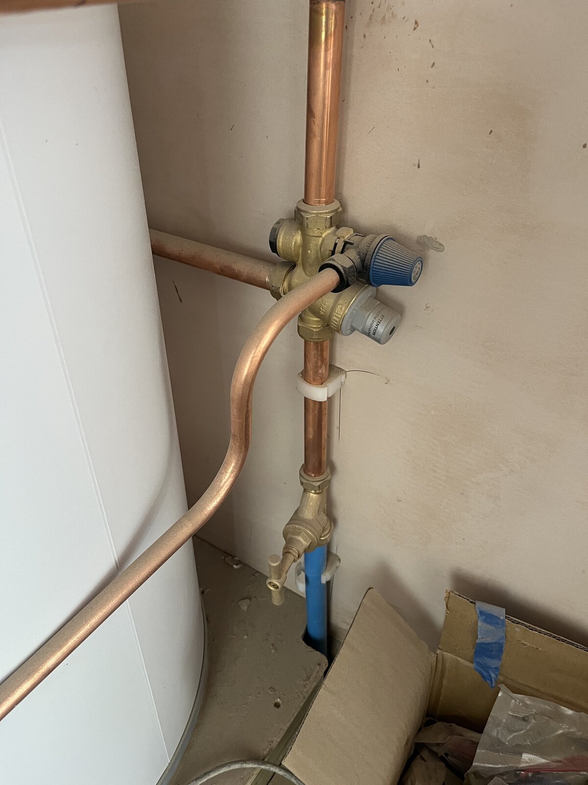

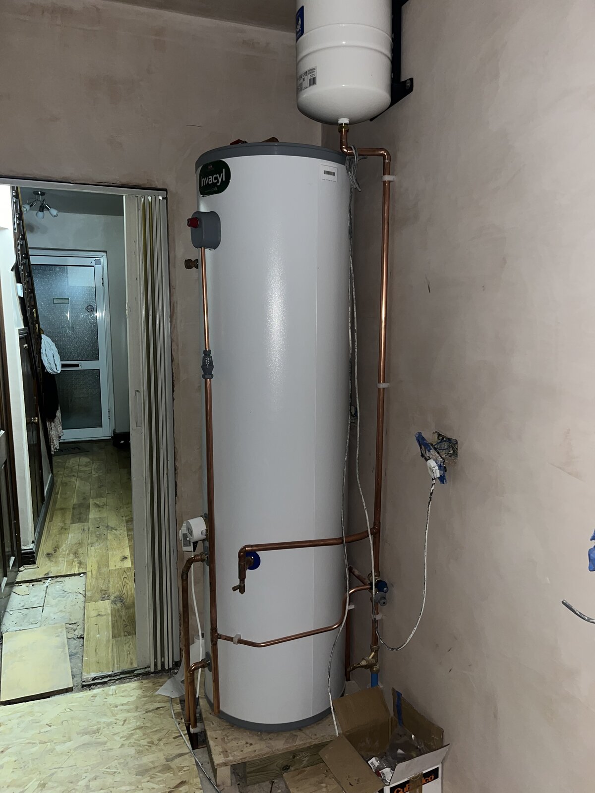

New unvented system fitted however all the taps on the ground floor and middle floor have 12l per min but in the loft is 4L. A considerable drop to what was before around 8L per min. Any ideas what can be done to cause this drop and what can I do to improve the flow rate. Really appreciate it

Pipe to loft restricted / blocked, some valve not fully opened or broken internally, loft taps are defective / blocked / junk.

The only thing they said to have done was extended the blue pipe to were the cylinder now is and changed the route slightly of the hot and cold downstairs. Everything else was as it was before. How the flow is considerably low. Is there anything I can do to test the pressure and then I can say to them that this is the issue and needs sorting for example. Or just anything you would recommend I can do to show and tell them that’s it’s an issue that they have caused
Is the blue MDPE the mains for the house? I really don't know why installer don't install a pressure gauge on the supply when an unvented is going in.
If you have an outside tap, then you could buy a screw on gauge and do some testing. Also use that to test for flow. TBH though, all this should have been done before any works started.
To get the best out of an unvented system I would never recommend it to be installed on anything less than 2.5bar @ 25L/min dynamic, especially if it is feeding more than one shower/bathroom

Yes that blue pipe is for the house was extended to the cylinder. I can a gauge and I can do the testing. If the pressure at the mains is low how would that be that the both floors have a decent flow rate but the loft don’t? It’s really weird how they didn’t install a gauge

As suggested - you need to know what you have to start with. If you are getting 12L/min on the ground and 1st floor then a drop of 8L/min over another say 2m is a lot.
The pressure figures are important to know and then it's down to why there is such a drop in flow up to the second floor. Again as suggested in post #2, time to check for pipe blockages/restrictions, failed valves etc but that still comes back to the installers and they should be fault finding and not just saying, oh install a larger pipe!
