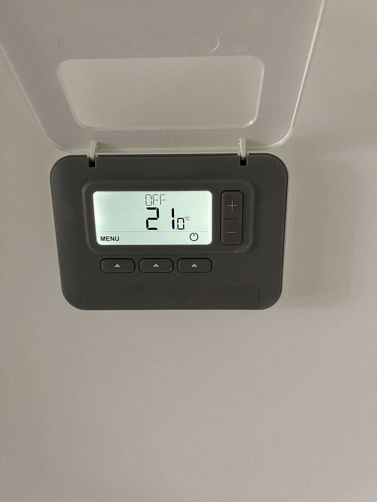

Thermostats: Honeywell Home (can't seem to find a model number on it)
Zone 1 (Upstairs), Zone 2 (Downstairs)

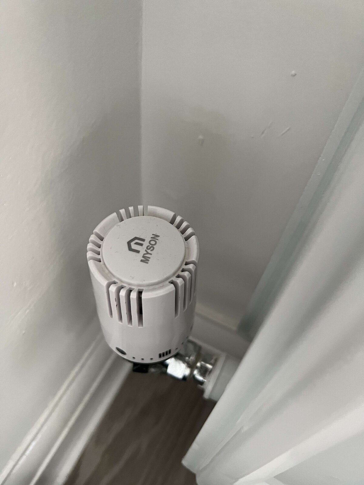

Radiator Valves:
Most have those variable ones that you can twist to change the heat setting manually

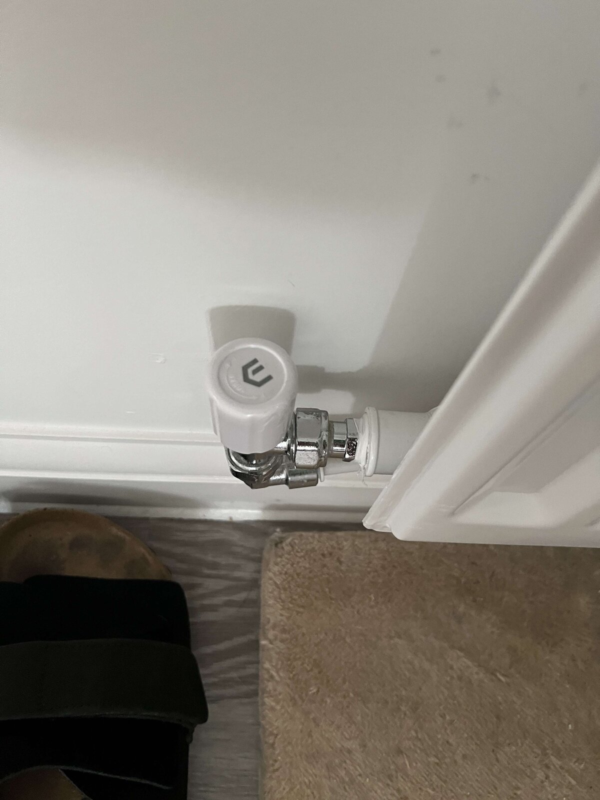

Some seem to have nothing:

1) what number are the Thermostatic Radiator valves set to?
2) Some of the rads have no TRV. How many? Of which, how many are in a room with a thermostat?
What was the room temperature when you tried it out?
They were all set to III (3) ... I've literally just moved in (last week) so testing everything (well trying too)

There are two radiators with no TRV:
Hallway: that has a thermostat nearby (about 4 meters away)
Master Bedroom: that has a thermostat nearby (about 3 meters away)
I set them to 22 degrees for testing purposes -
That is correct. If they had TRVs the two thermostatic devices would be in contention. Those two radiators should be adjusted to warm their rooms slower than the ones with TRVs. This is done by closing down the lockshield valve to reduce speed of water flow. Typically around half a turn open from the fully closed position. You may think this is surprisingly little, but it is correct.
The result should be that the rooms with TRVs reach their target temperature first.

I was just testing to see if they actually work to be honest, so I set the thermostat on the wall to 22 and then the TRV (the manual kind) is set to III (3) on the dial.
I think the main problem with the setup as it is (new build remember, so didn't have much choice of what they installed) is that the zone (upstairs or downstairs) is very dependent on the warmth of the location of the thermostat. I'm sure I can find a balance as I play around with it, until I upgrade to something smarter like the EvoHome or Hive or Tado or something like that.
