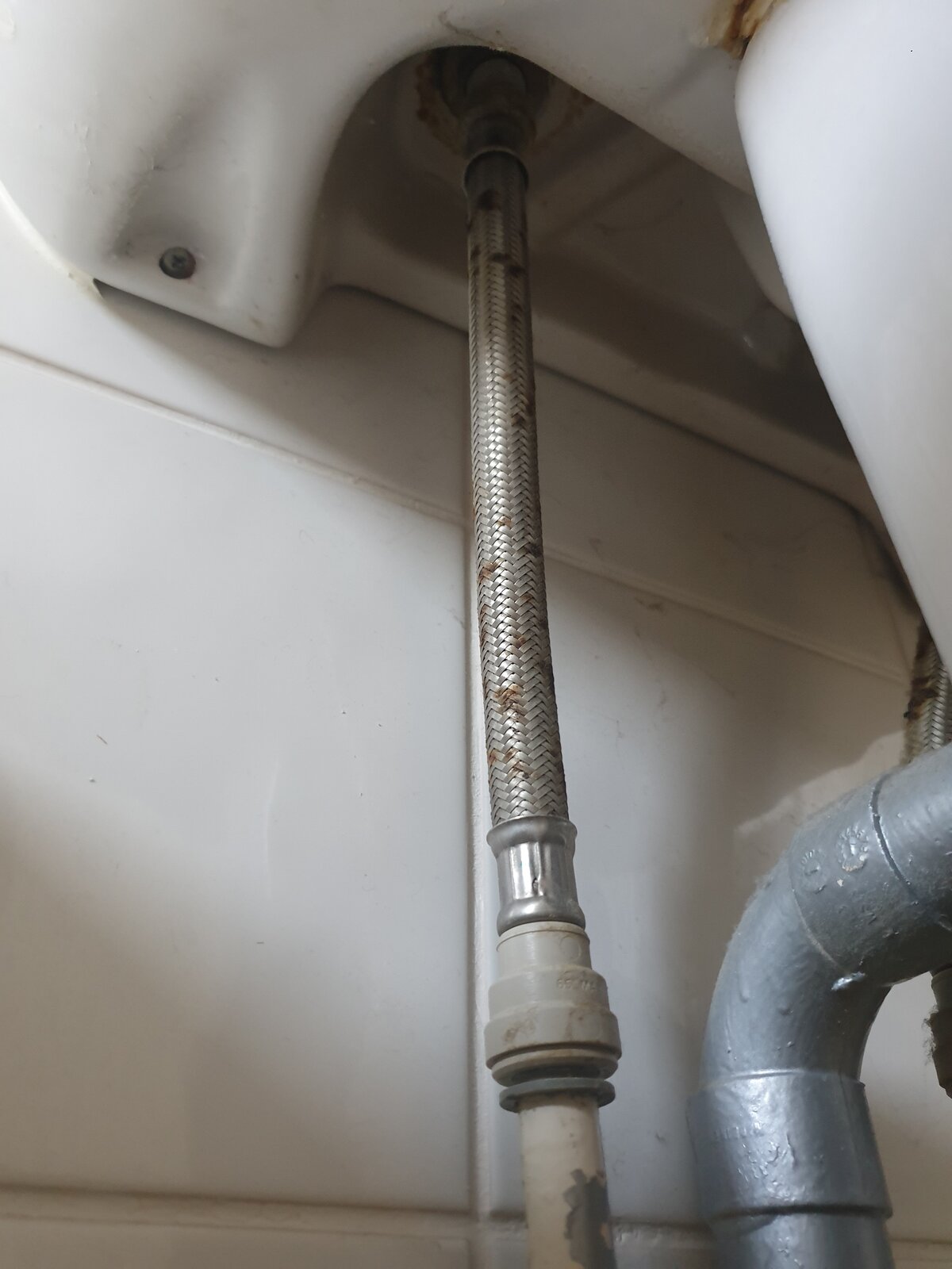

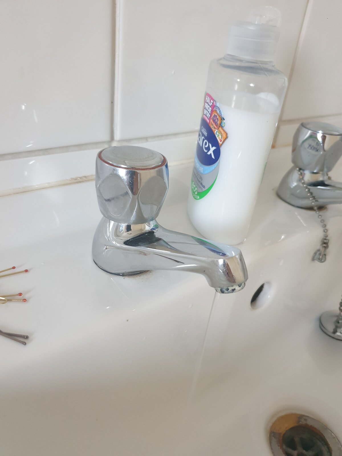

I assume it's a basin tap ? Show us a pic . If it is the screw down type ,rather than quarter turn operation ,the valve is probably the fault.
Here are some pics. Just ran the tap, strong force came out of it for a while then complete stop and drip drip.

Just replace the valve . That's the part which you can't see ,until you remove the handle. The big silver disc on top of the handle pops off. You then see a big red plastic thing with a screw in the centre. Remove the screw ,and the handle pulls up and off to reveal the valve. Before unscrewing the valve ,you will need to isolate the water supply.
Just a big thanks Terry.
Was the valve, now have hot running water!
Was a bit of a job to loosen the valve, due to spacing under basin even with basin wrench.
