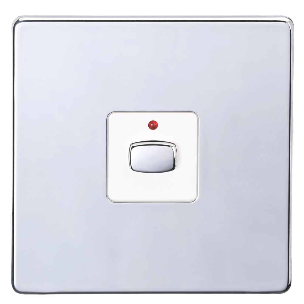

Unfortunately I don’t have the budget to do a full rewire, as we moved in a year ago so please can I kindly ask that you answer my question only if you are able to offer a solution that doesn’t involve a complete rewire.
Here’s my problem, I currently have a 2 way light switch in my downstairs hallway that can turn off and on the lights downstairs and the upstairs landing. I have a light switch upstairs that can only turn of and on the lights in my upstairs landing and can not turn off the lights in my downstairs hallway. Both lights are not earthed but some of the lights in my house and all the sockets are earthed.
Is there a solution that doesn’t involve a complete rewire that can get a two way switch upstairs to turn off and on the lights downstairs???
It can be done without a complete rewire.
It cannot be done without running another cable between the landing and hallway switch.
I’m happy to have another wire run we just can’t afford a rewire at the moment but my children keep leaving the lights on downstairs and it’s becoming a real pain.
How would someone go about doing this please? If I wanted to hire an electrician how would I go about asking him?

We have an RF switch but it doesn’t seem to be working because the upstairs light doesn’t appear to be wired correctly.
If we know which RF switch maybe some one can advice. With the switch which I have there is a limit to three remote controls, as a result it is possible to accidentally remove the programming to one remote when trying to program in another device.
I was lazy, I did not want to bother wiring in a second switch to turn bedroom light on/off, the energenie mihome switch was selected because I already had other energenie mihome stuff so I already had the hub, so I have energy monitor, eTRV heads, sockets and light switch all on the same system. I would not recommend the switch to you as your looking for the remote to be fixed to the wall. As to wiring my switch has 3 connections, one is unused and there is nothing in the instructions to even say what it is for. So in real terms there are just two connections and it really does not matter which wires go to which terminal it would still work.
The MK Echo info here £92.74 for reviver and £100.36 for switch means two switches will cost £300 that is to me rather expensive.
The EasySwitch is a bit cheaper £41.40 and £59.22 works out cheaper The receiver instructions shows how wired, I have read it and to be frank not sure it it need one or two transmitters, never used one, just know they exist.
