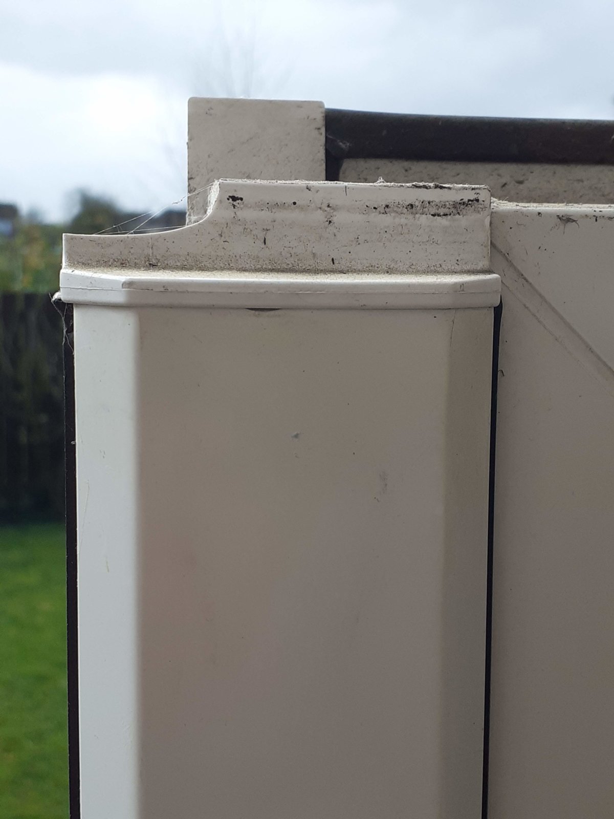

Hi,
I have an issue with a gap at the top of out upvc french doors. I have had a look and it looks like the top plastic has snapped off. I have attached a photo if anyone can let me know if I can buy a replacement. Also the doors don't fully shut and a small gap at the top.
Thanks in advance
Hello Apple, the cap which is the broken bit ,is normally factory fitted at the manufacturing stage and fits the specific profile or shape of the French door ie veka, spectus, there just different makes. There may be a local company that fits that make that could help you. As for the French doors, it could be that the doors have dropped and need adjusting from the hinges or they may simply need tightening up. Try that first if not a local d/g fitter will certainly know what to do.
